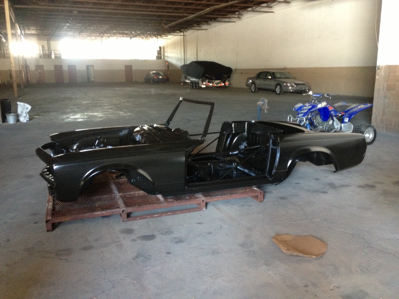

Incredible! How long did you have that on the rack/jack stands? Seems like it's been a permanent fixture. Can't imagine how many hours you have in that one. Customer must be pretty excited to see it at this stage.
rick 918-S
post Feb 13 2014, 10:55 AM
Hey nice rack! -Celette
Posts: 21,352
From: Now in Superior WI
Member No.: 43
Oh ya! It was here longer than I want to admit but only because I had a full time job working 24-7-365. (IMG:style_emoticons/default/blink.gif)
My friend is loading it now and bringing home until I finish Ben's 6 and the 911 Targa I have here. Then it comes back. I am painting the shell. He will assemble it when I'm done.

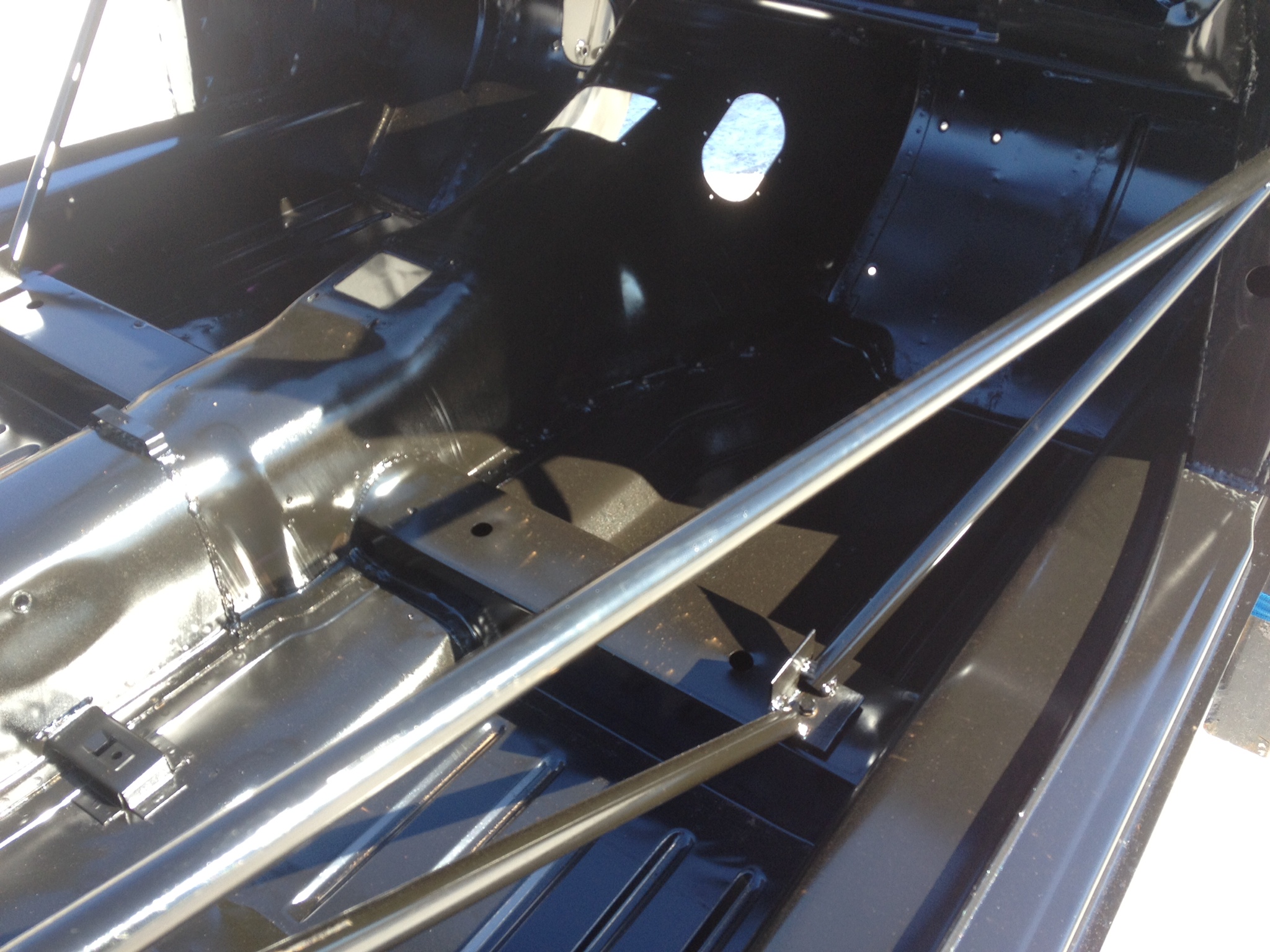

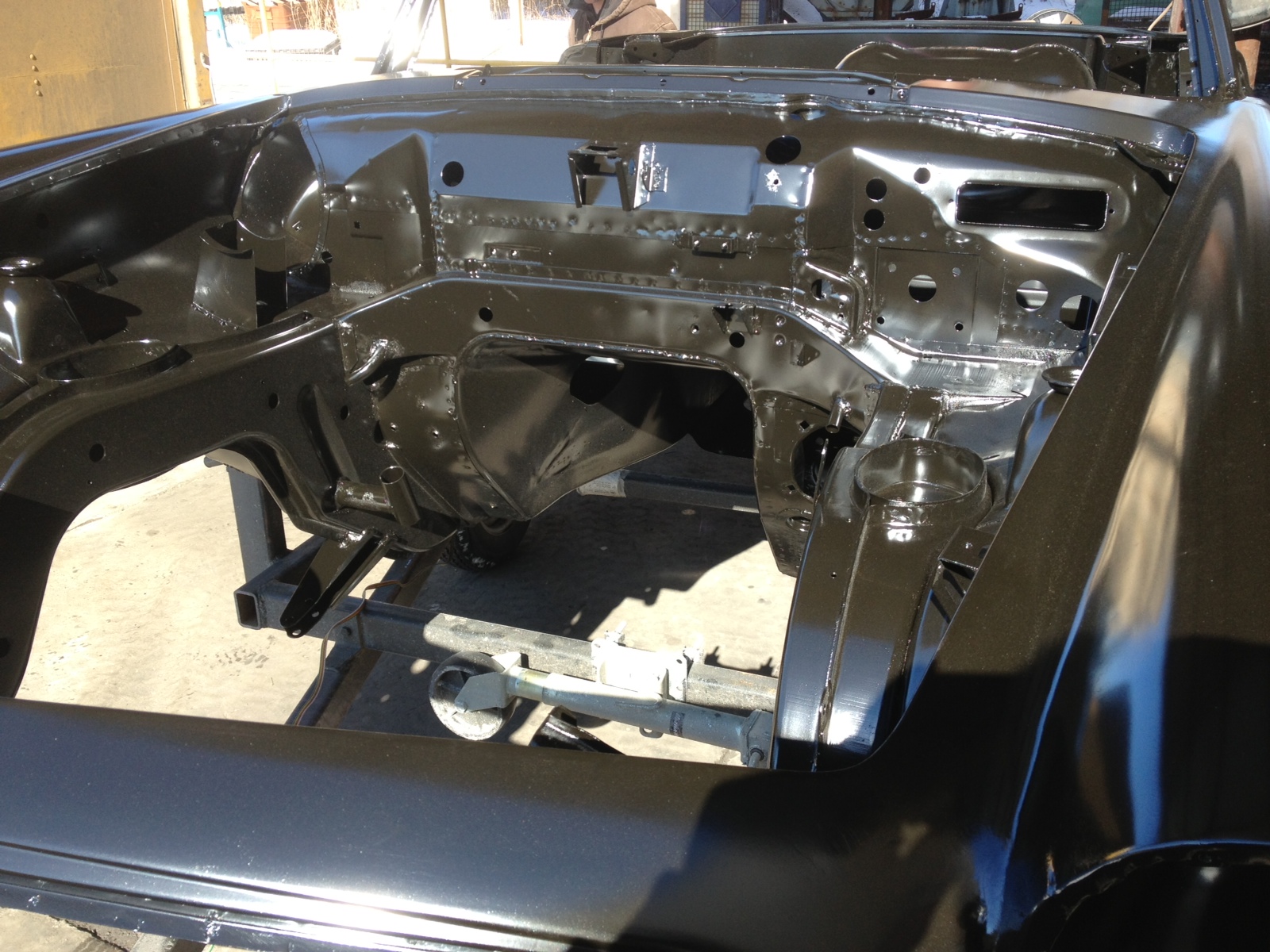

Couple more photos:
