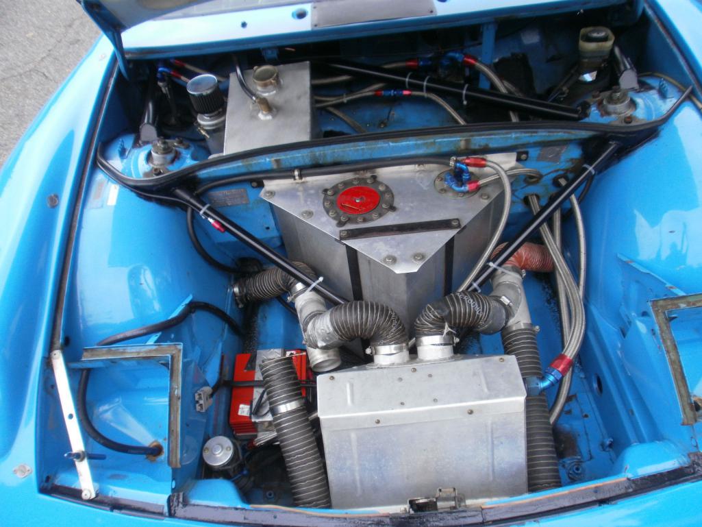

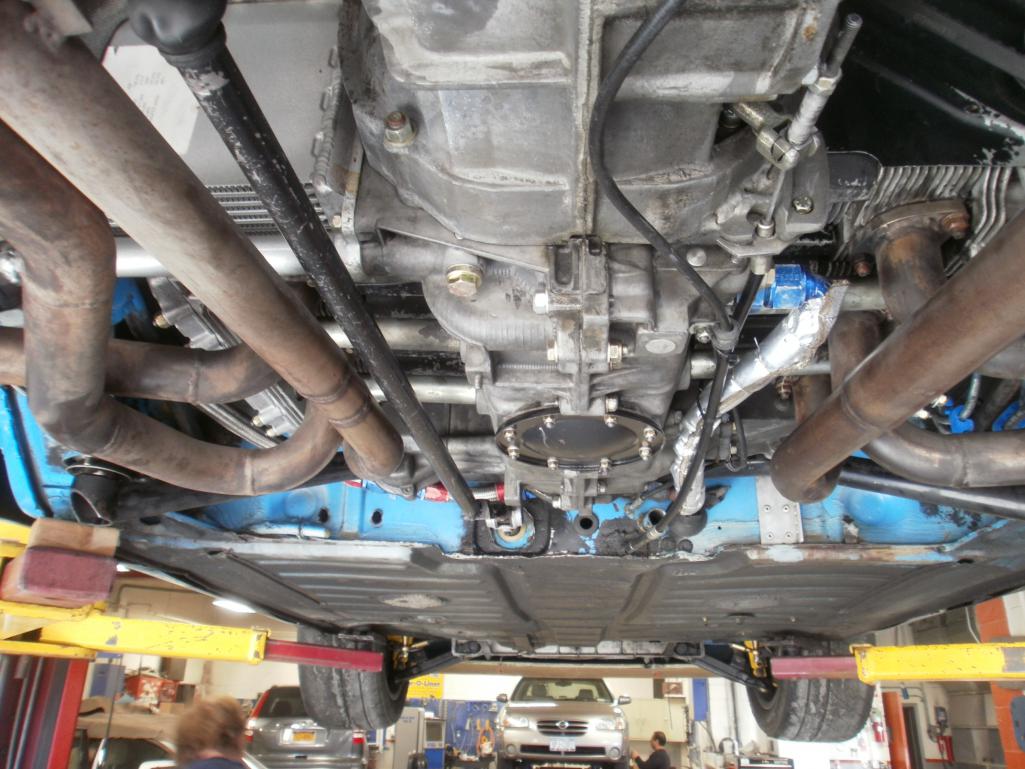

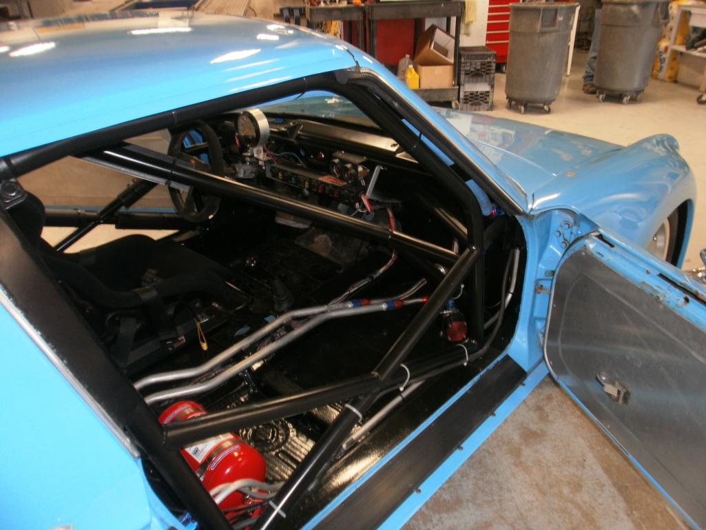

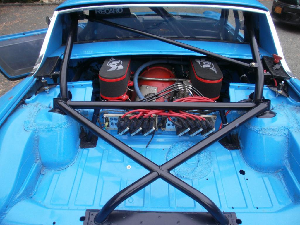

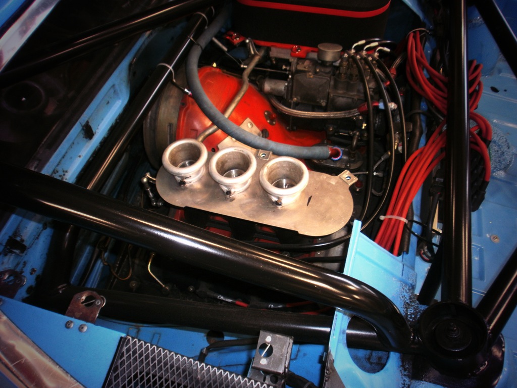

Has anyone ever seen this car in the North East racing? I bought this car and I am trying to find out more history of this 1974 914-6 GT. It has a 2.8 RS engine with mechanical fuel injection, it was built from 2.4 911 T engine.
If anyone knows any history please let me know and thanks.

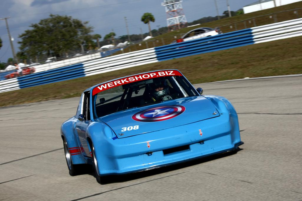

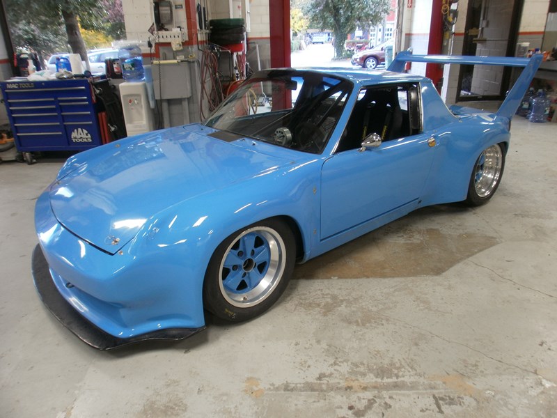

the first picture show what the car looked like minus the stickers
second is after the wing-ectomy
third is the motor

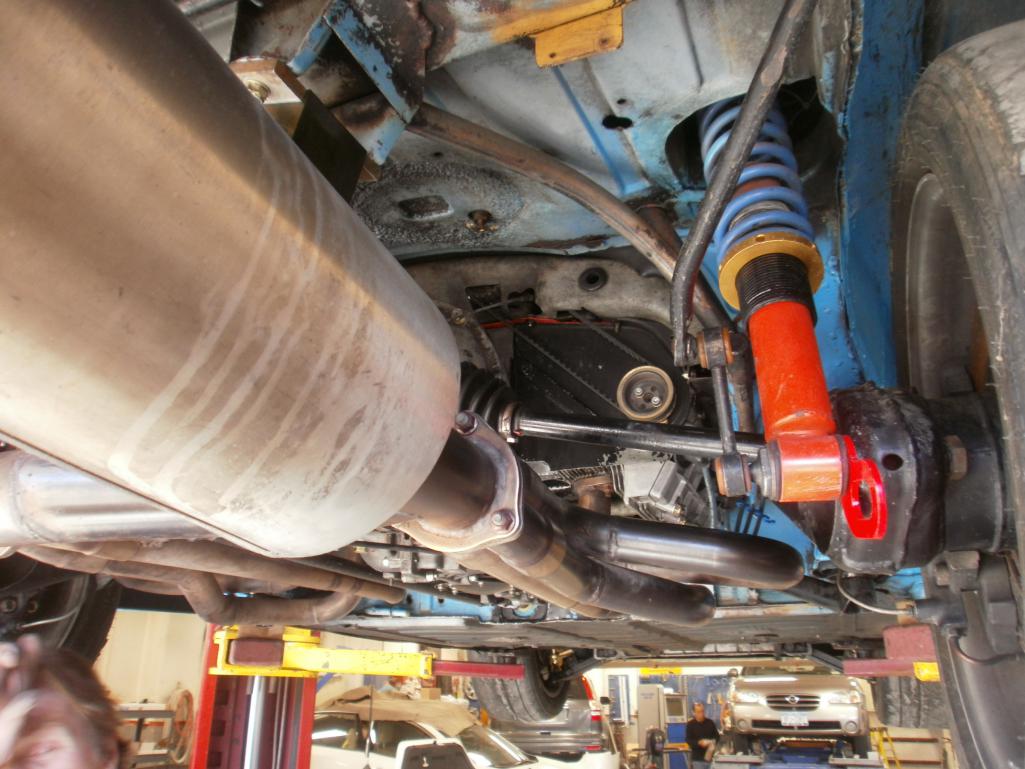

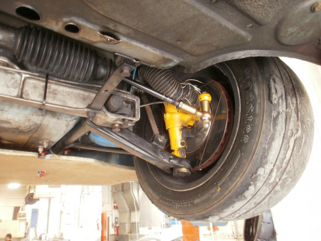

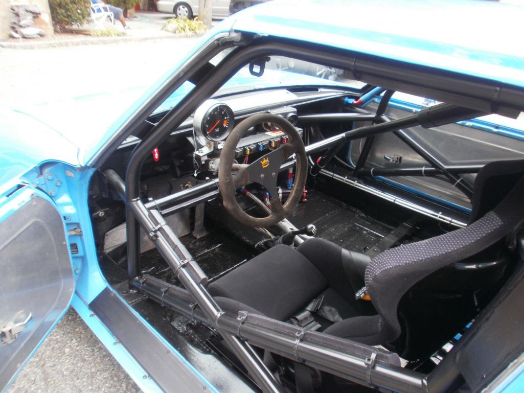

More pictures of the work done to this beast!!

wild ass guess... it looks like 2050 to 2100lbs.
that car has been on the board around here before
the previous owner was likely a board member
you really need to re-work that front oil cooler exhaust
exit area should be twice the cooler size
that looks restrictive and ineffecient
even if its marginally keeping things cool... I guarantee you will improve the existing coolers abilities by opening up the exit
nice PCA car!
it might qualify for a IMSA car with a shrink in displacement
its tough to make it a strict vintage car

the car ran at 180 at Sebring in 80 degree temps all day long, the oil cooler exits to the brake ducks. Seems to work good so far but ill keep that in my bag of tricks for later.
The fuel cell in your car is how many gallons??
I would love to see any post from the previous owner as Im looking for info on this car!
where can I find them??
I'm in the dark on this car it was a great deal but it came with a title and no info on the car...... a gamble but for the price a risk worth taking!!
It fits in the HSR GTU class as it sits now with the 2.8 RS motor and mods, the wing and splitter must go per HSR.

the car also has 930 brakes all around, floating rotors up front from:
http://www.vehiclecraft.com/Brakes/930_upgrade.htm
expensive but they work great!!

my cell is 15 gallons
cool that there is a class for that motor
I'm surprised the brakes are legal but nice that they are

Looks cool. Im not sure if the hood pins, mounted to aluminum braces that appear to be pop riveted to the body are adequate.

QUOTE(Krieger @ Feb 28 2014, 12:35 PM) *
that has been fixed, I thought the same thing!!
it still uses the factor hood latch as well (IMG:style_emoticons/default/smile.gif)
