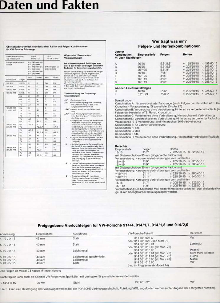

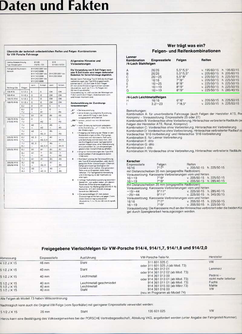

Below is the actual factory list of combinations. There are quite a few different combinations that were used.
Yeah, i know it's in German ... (IMG:style_emoticons/default/rolleyes.gif)
Einpresstiefe = Offset (in mm)
Felgen = Wheels
Reifen = Tires

So bottom line, they used:
Front / Rear
7"x15 / 7"x15
7"x15 / 8"x15
7"x15 / 9"x15
8"x15 / 8"x15
8"x15 / 9"x15
9"x15 / 11"x15
and had a 35mm spacer in the front on the combinations that used 7" front wheels ...

Andy, where is that info from? Am I wrong to think that there were no 285/40/15 tires (which are called for in the document there) back when the 914 was new?
The GTs were race cars. They probably had a variety of different wheels at different times, dictated mainly by the rule set of whatever race they were running. And the rules could and did change--and one car might run different series with different rules as well.
Any particular reason you need to know what was originally used on the (relatively few) Factory-built 914-6GT cars? Are you restoring one?

QUOTE(Dave_Darling @ Mar 20 2014, 02:41 PM) *
DGVWPB
And yes, there were tires in that size when the 914 was new.
In fact, 285/40/15 on 9" wheels and 345/35/15 on 11" wheels was a popular wheel & tire combo on quite a few cars at the time.
