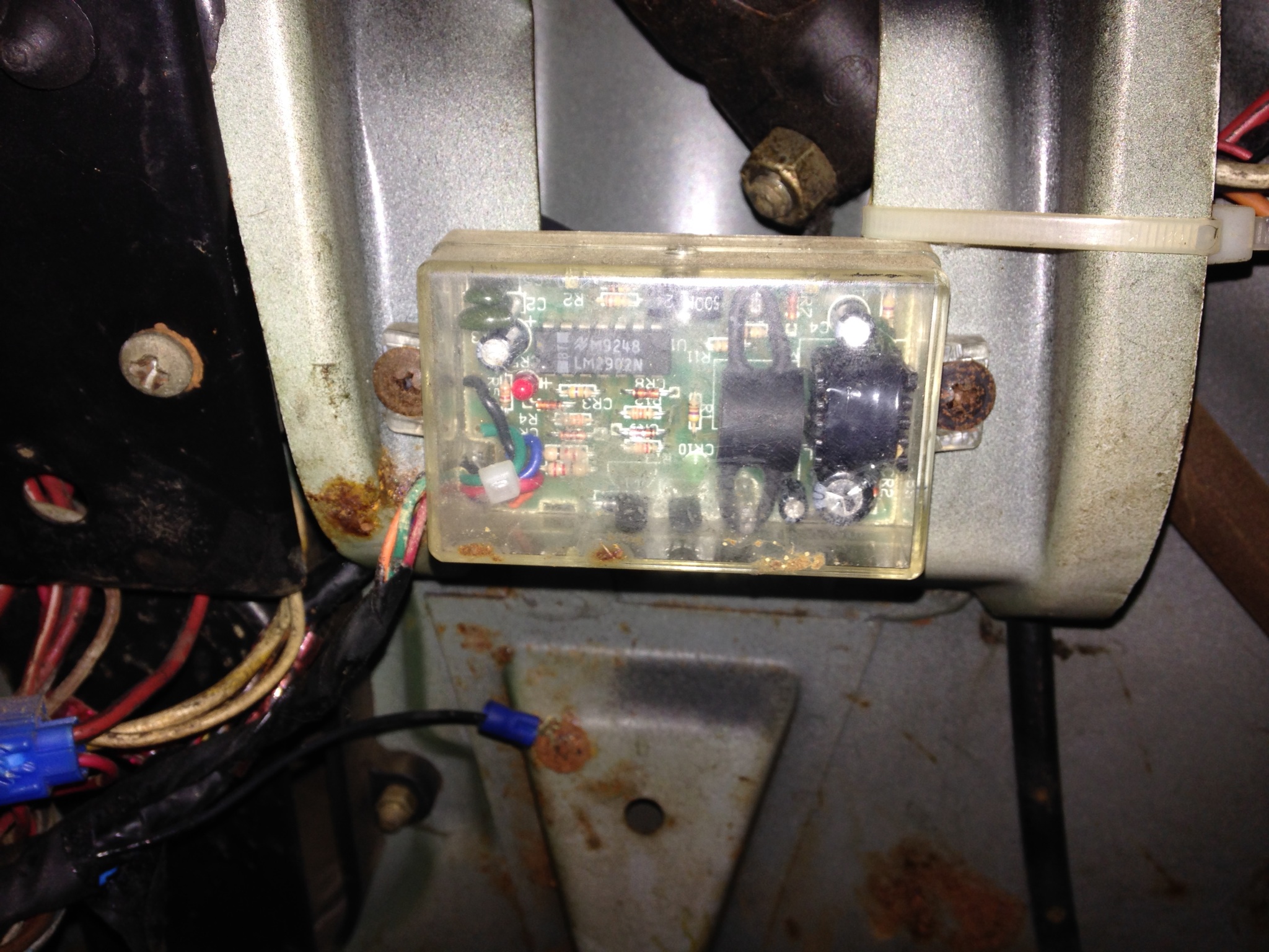

Ok, I am such a noob when it comes to things that look out of place. What is the extra box next to my fuse panel?
Thanks.

Doesn't look stock, maybe aftermarket alarm?

Where do the 4 wires go? Trace them backwards. I'm betting old car alarm.

that is the shock sensor for aftermarket alarm; always hot, if you tap it, an LED should flash.

Alarm? Definitely aftermarket.

Old solid state alarm, Clifford...Ungo?
I just pulled an oldie out of the '74 roller, must have been wires going in every direction: a train wreck !

Car Alarm. The chip (LM2902) is dated 9248 (48th week of 1992).... The rubber band looking thing is probably a vibration sensor.

I doubt it is an alarm.
There aren't enough connections.
Car alarms have lots of pins typically on a header to sense and control things.
Plus the LM2902 is an op amp, a simple amplifier, not any sort of microcontroller.
I'm with dangrouche in that it is just the motion sensor
for alarm that is/was somewhere else.
