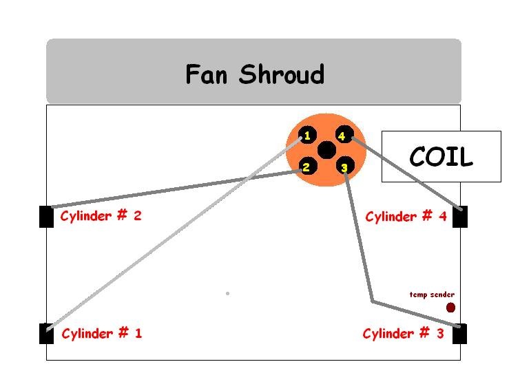

Thanks for all the advice! But I have a follow up question... All my prior experience is with Type I engines. When looking at the distributer from the passenger side (directly over cylinders 3&4), the cylinder#1 mark is at about 3-4oclock position. I'd expect it to be between 1or2oclock. However, the wire at this position goes to cylinder#3. So maybe just wired wrong AND advanced?

QUOTE(barebrad @ Mar 24 2014, 03:10 PM) *
Only allowed limited garage time during the weekdays so I can't just go tinker.☺
Should look like this.

QUOTE(Mblizzard @ Mar 24 2014, 06:18 PM) *
Hmmmmm... Not even close!

I think that might be the first thing to address.
Get your engine to top dead center and be sure the rotor is pointing to the location of where # 1 is shown. If not the dizzy may be incorrectly installed.

For some reason that drawing strikes me as wrong. Let me check on some things before you change.

QUOTE(Mblizzard @ Mar 24 2014, 09:22 PM) *
The drawing is right. I have been putting the wires on 914s like that for over 25 years.
