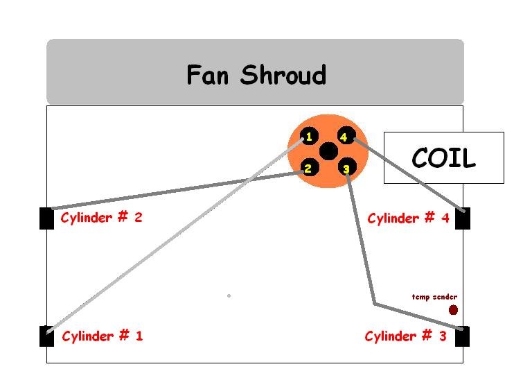

Mblizzard
QUOTE(barebrad @ Mar 24 2014, 03:10 PM) *
Thanks for all the advice! But I have a follow up question... All my prior experience is with Type I engines. When looking at the distributer from the passenger side (directly over cylinders 3&4), the cylinder#1 mark is at about 3-4oclock position. I'd expect it to be between 1or2oclock. However, the wire at this position goes to cylinder#3. So maybe just wired wrong AND advanced?
Only allowed limited garage time during the weekdays so I can't just go tinker.☺
Should look like this.
barebrad
QUOTE(Mblizzard @ Mar 24 2014, 06:18 PM) *
Hmmmmm... Not even close!
Mblizzard
I think that might be the first thing to address.
Get your engine to top dead center and be sure the rotor is pointing to the location of where # 1 is shown. If not the dizzy may be incorrectly installed.
Mblizzard
For some reason that drawing strikes me as wrong. Let me check on some things before you change.
ClayPerrine
QUOTE(Mblizzard @ Mar 24 2014, 09:22 PM) *
The drawing is right. I have been putting the wires on 914s like that for over 25 years.

barebrad
So I found the wires for cylinders #1 & 3 were reversed. Connected them correctly and adjusted the timing to 34BTDC per the Pelican Article. Now it smokes like crazy! Works well to keep the mosquito's away. It starts great too! Just a bump of the starter. Because it has been switched probably for quite some time, do I run the engine for awhile to see if it stops or is it already toast?
