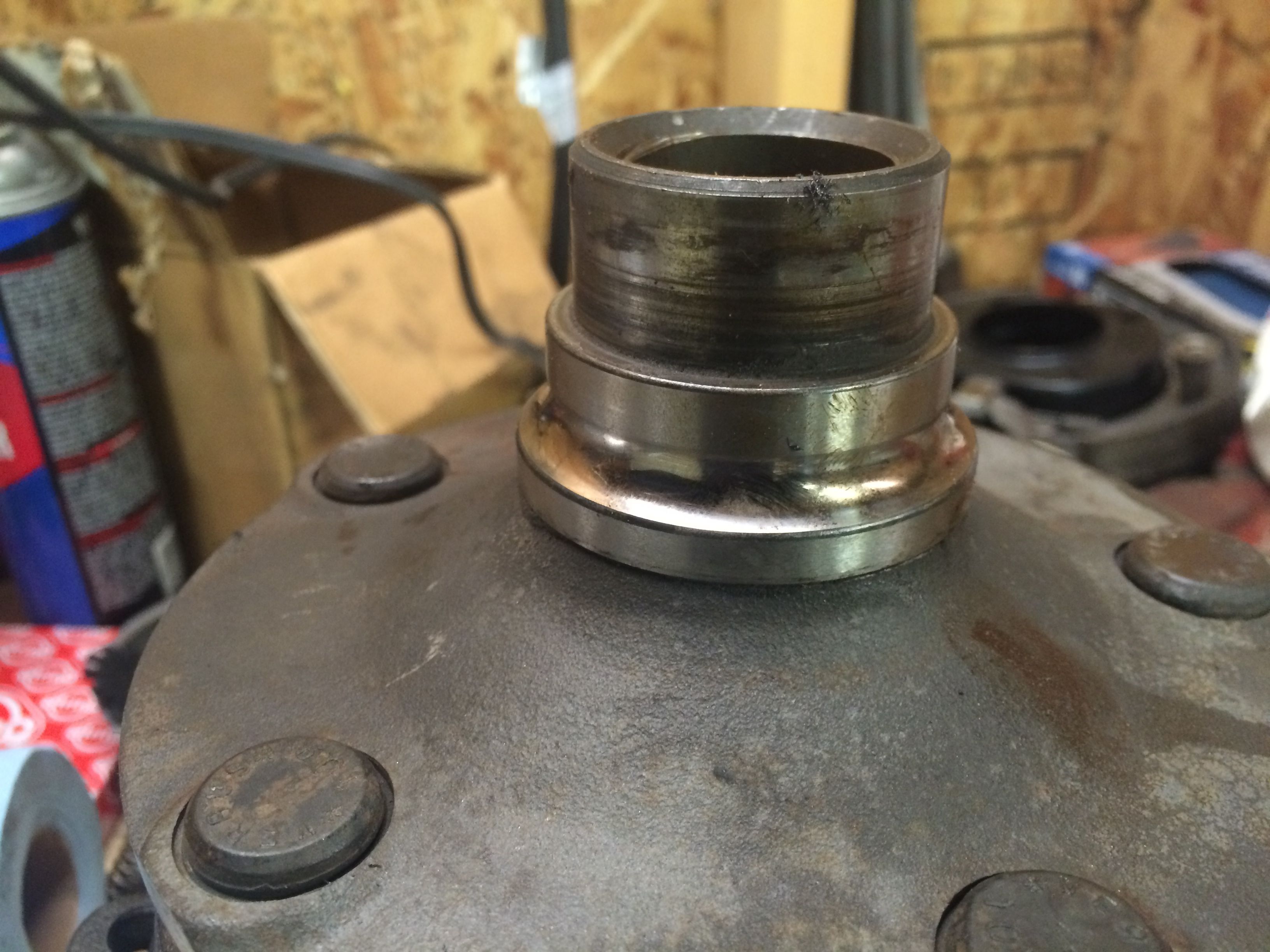

> Old bearing RACE, or a spacer on this 911 hub?, I'm thinking bearing...but want to be sure.
CptTripps
post Mar 27 2014, 12:02 AM
:: Punch and Pie ::
Posts: 3,586
Joined: 26-December 04
Member No.: 3,342
I'm thinking this is the remnants of an old bearing, but before I go yanking it off of there, can I get someone to opine on it?
This is the outer hub from a 911. Just want to double-check with people more knowledgable than I am.

Yes, that is a race from the rear wheel bearing.

...now I just need to figure out how in the hell I'm going to get it off!

I grind them thin with an angle grinder and crack them with a sharp chisel.

I insert a medium size properly sharpened chisel between the hub and the race and move it far enough to get a puller in there. It should be on there pretty tight, and that fit should continue all the way to the end. If it doesn't, the hub's no good.

Eric (PMB)has a video on that exact thing at his website. He does it with a cold chisel.

Air chisel, as long as your careful and pay attention. Takes about 15 seconds.
