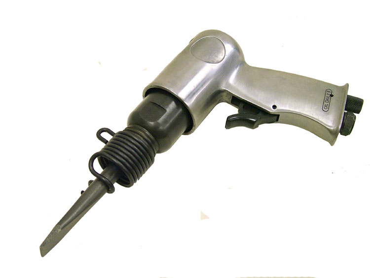

McMark
Air chisel, as long as your careful and pay attention. Takes about 15 seconds.
