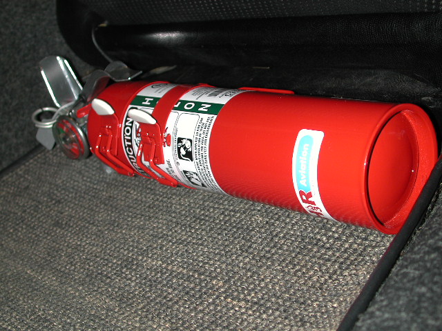

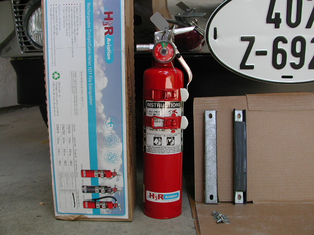

I also have the H3R Halguard extinguisher, 2.5 lb. along with their universal seat mount. Got it through an American Speed Centers store.Attached Image
