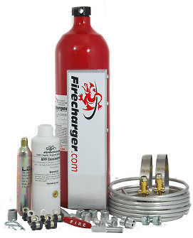

I have both a BC and an AFFF (Fire Foam) system. Most racing sanctioning bodies have not fully accepted the AFFF systems but I don't care. My BC keeps me legal. My AFFF will keep the fire at bay. The AFFF system I use can be refilled at the track if needed.
http://augustamotorsports.biz/firecharger-...guisher-system/

stugray
IPB Image
I have that system.
Never had to use it yet and hopefully never have to.
Note: Those come in two sizes. The smaller supports two nozzles and the large three.
Decide what you need before ordering.

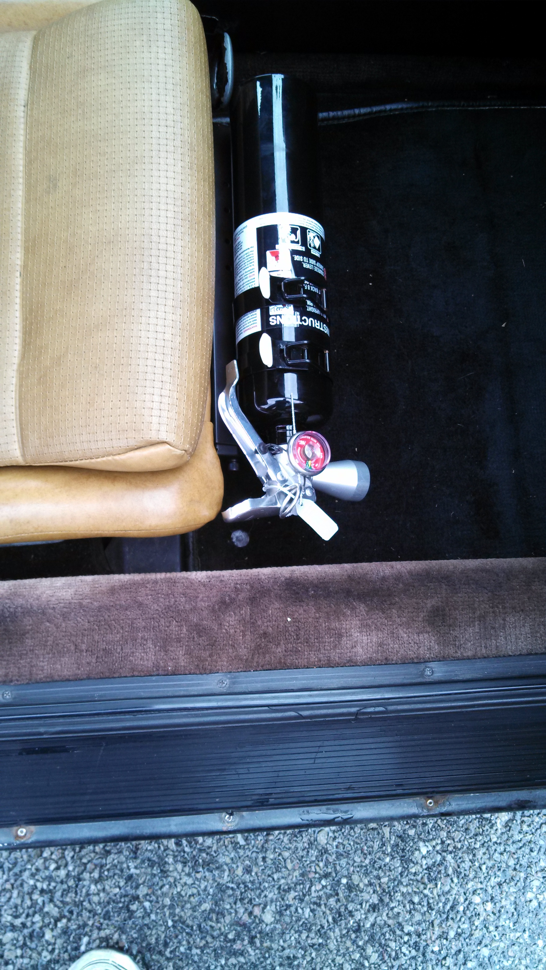

pvollma
I also have the H3R Halguard extinguisher, 2.5 lb. along with their universal seat mount. Got it through an American Speed Centers store.Click to view attachment
