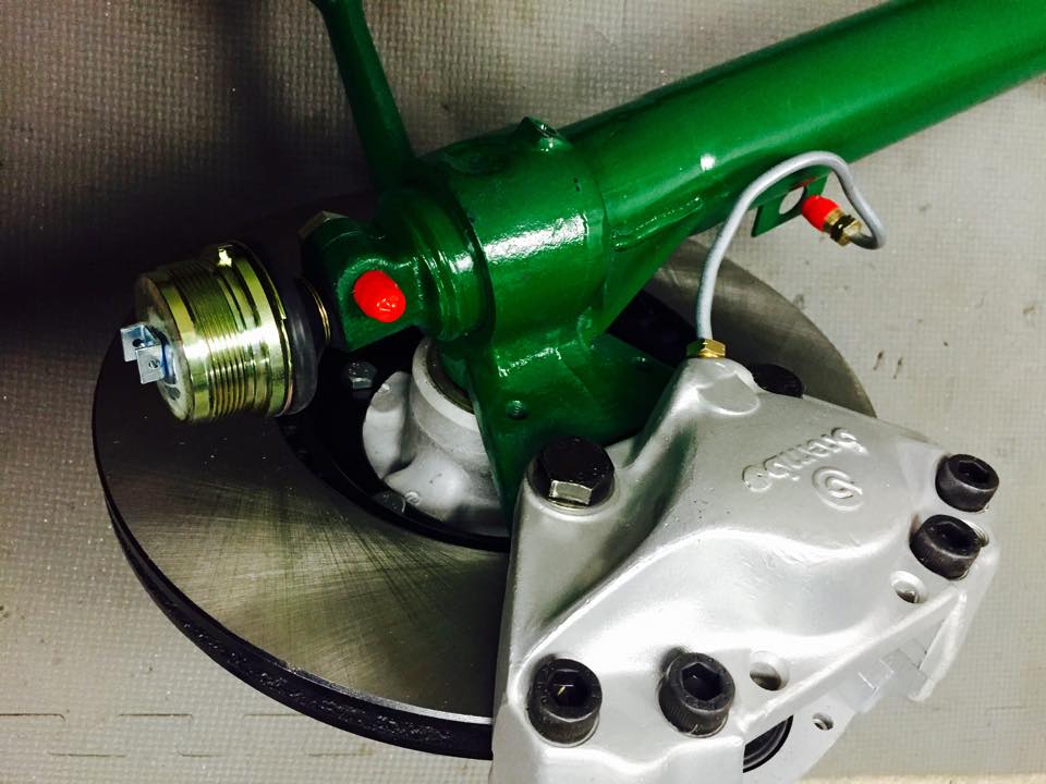

FYI
When you attach the calipers you will probably need to remove the powder coat on the trailing arms and front struts where the calipers sit. The powder coat is thicker and will space the caliper off center of the rotors.

I actually wondered about that because I powder coated my trailing arms too. I hope Eric shows us what his solution is.
This is one of those threads that you wish was 15 pages long and you want to peek to see the end result!

Id just file the powder coat off but thats me.
To be fair, id have asked them to not powdercoat it in the first place.

QUOTE(Larmo63 @ Dec 1 2014, 06:37 PM) *
You would have to go pretty heavy on the powder coat to make any difference. You can mask them by installing a short bolt and washer in the caliper hole. I haven't in the past and never had a problem.

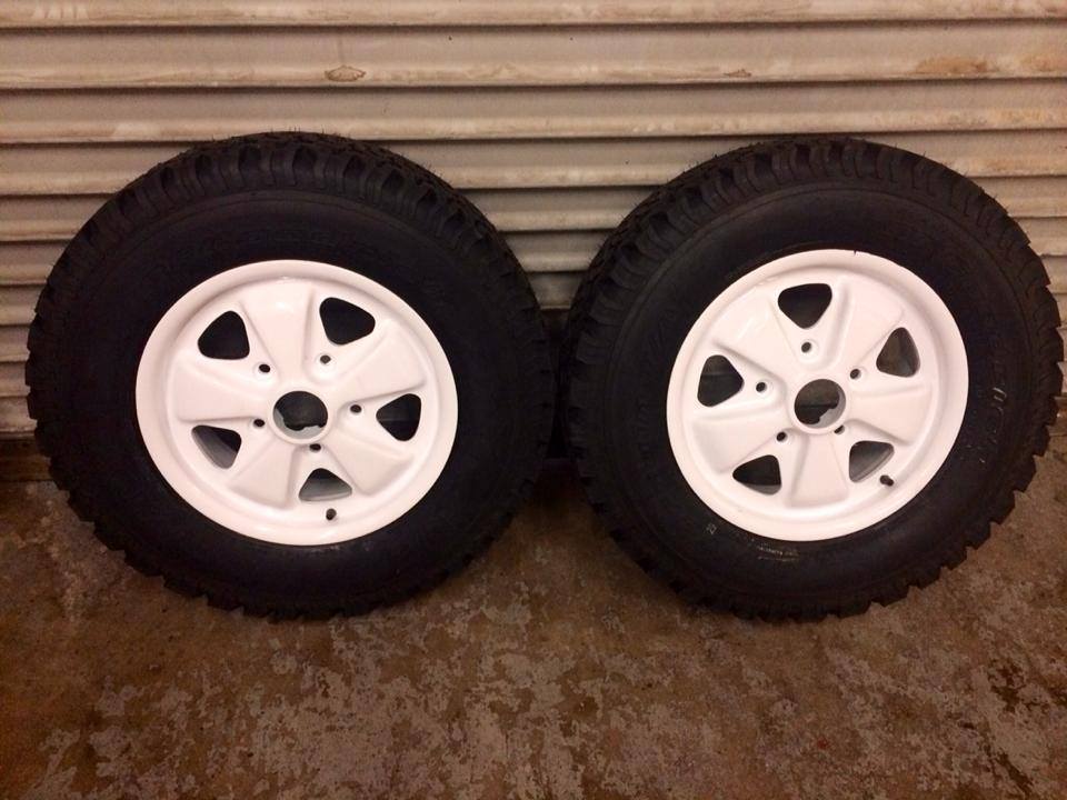

bulitt
post Dec 2 2014, 11:48 AM
Post #53
Achtzylinder
Posts: 4,189
Joined: 2-October 11
Member No.: 13,632
Bought these same wheels for my utility trailer at Tractor Supply.
(IMG:http://www.914world.com/bbs2/uploads/post-1110-1417314606.jpg)
And they gave me a free hat, unlike some vendors........ (IMG:style_emoticons/default/dry.gif)

Eric_Shea
post Dec 8 2014, 08:08 PM
Post #55
PMB Performance
Posts: 19,304
Joined: 3-September 03
From: Salt Lake City, UT
Member No.: 1,110
What's wrong here? (IMG:style_emoticons/default/lol-2.gif)
r_towle
post Dec 8 2014, 08:12 PM
Post #56
Custom Member
Posts: 24,705
Joined: 9-January 03
From: Taxachusetts
Member No.: 124
Shield missing?
I would not put one on an ORV anyways.

Eric_Shea
post Dec 8 2014, 09:49 PM
Post #58
PMB Performance
Posts: 19,304
Member No.: 1,110
Ummm no... guess again. Oliver Green which is correct for the vintage. John Deere is correct for the later stuff. Just funny iFone filters making it look weird.

Larmo63
post Dec 8 2014, 10:15 PM
Post #60
Posts: 4,267
Joined: 3-March 14
From: San Clemente, Ca
Member No.: 17,068
Raised spindles. (or lowered)
