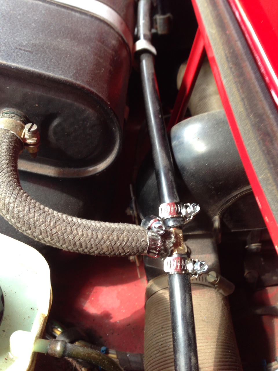

Put a "T" in the drain hose and connected the open hose to it.
Drove the car for 30 miles and no gas smell!
Thank you for all the advice.
