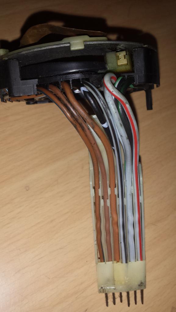

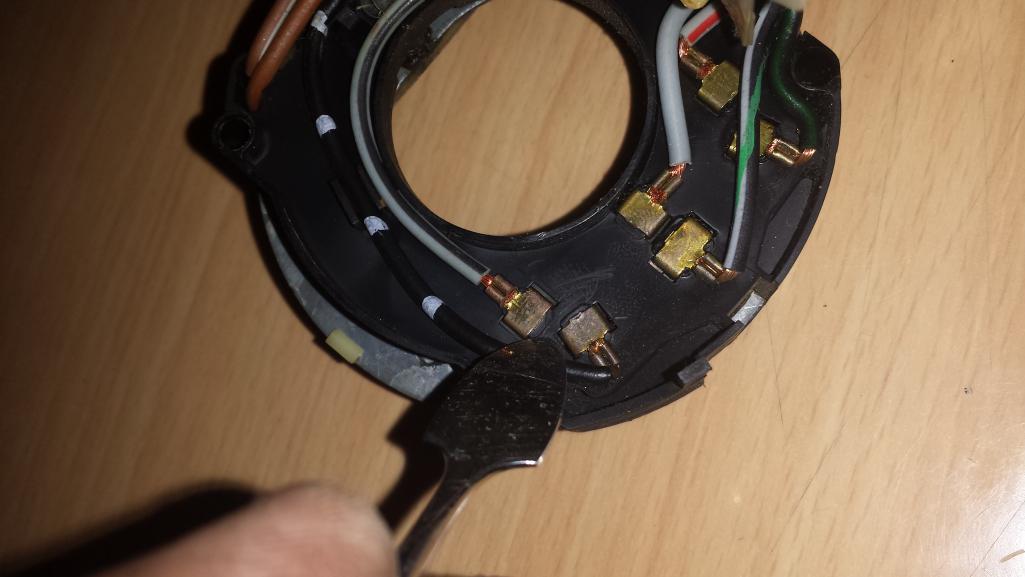

I heard this can be done but have not tried it. The differences are that the 924 switch has ony one rider for the horn and has the 4 and 5th wires swapped in the loom. I do not think this matters as those two are bridged when the left turn signal is applied.
Any body tried It?
