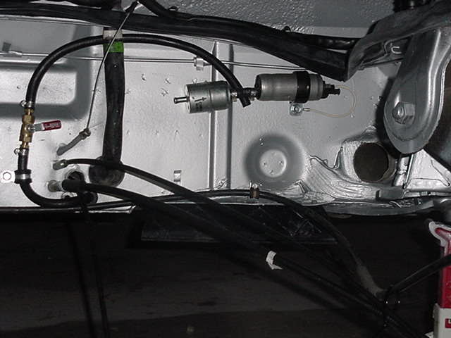

my car is carbed also. i just used 8mm high preasure line for all the replacement. it works fine from the firewall up through the stock line hole in the engine tin to a metal tee and then to both carbs. my pump and filter are located on the firewall. i didn't want to have to pull the gravel guard to change the filter.
kevin

Great! Thanks for the picture. I put the pump up front because I heard that the pumps work better at pushing the fuel rather than pulling it. I was also told it would be better for the pump to be away from the heat of the engine bay.

actually i didn't use the shut off valve. it made the setup bulky and i lowered the pump a bit than shown in the picture. my understanding was the rotary, like mine, is a better "pusher". the pump is lower than the tank outlet so it's just a little push up hill.
kevin
