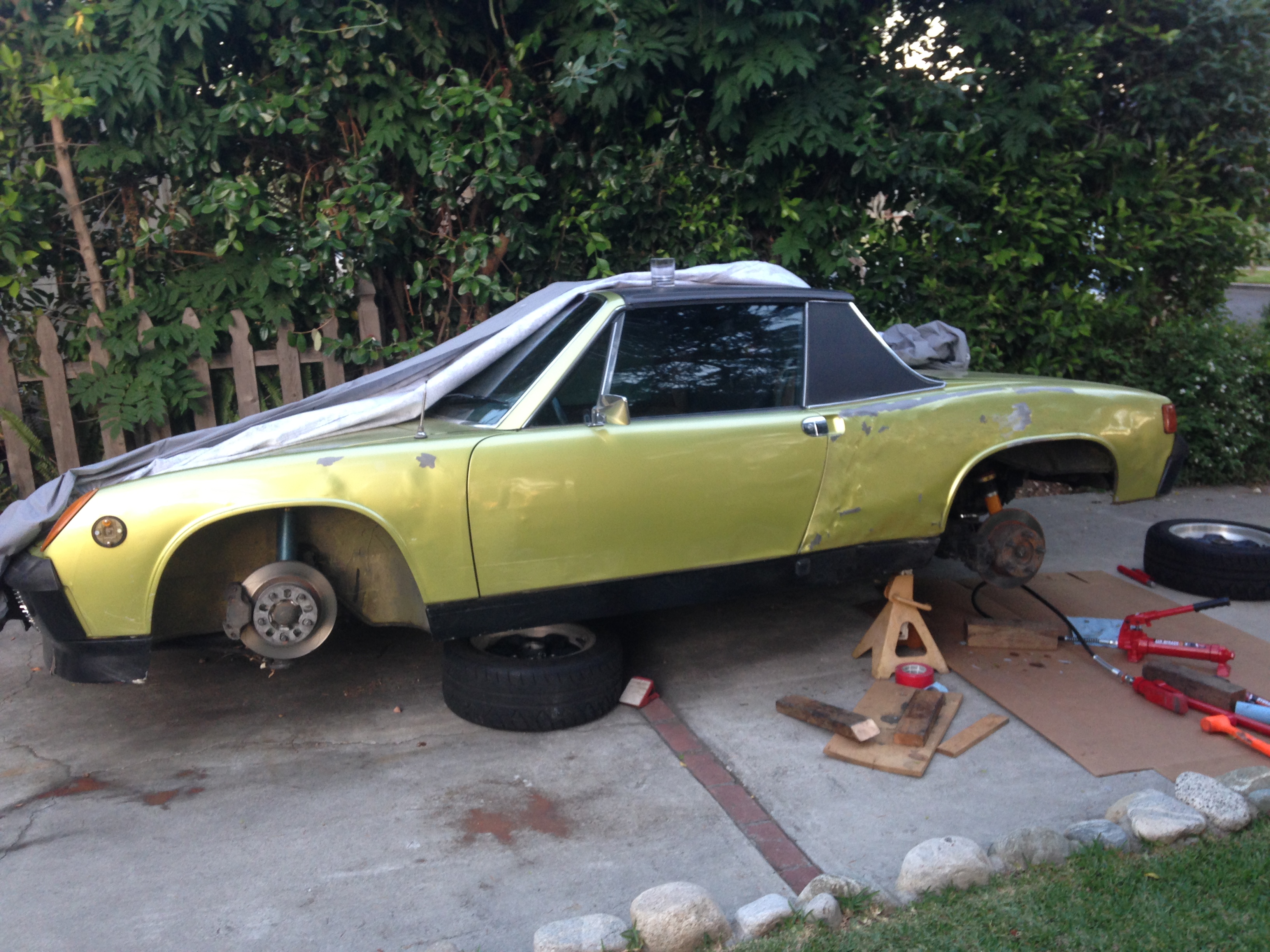

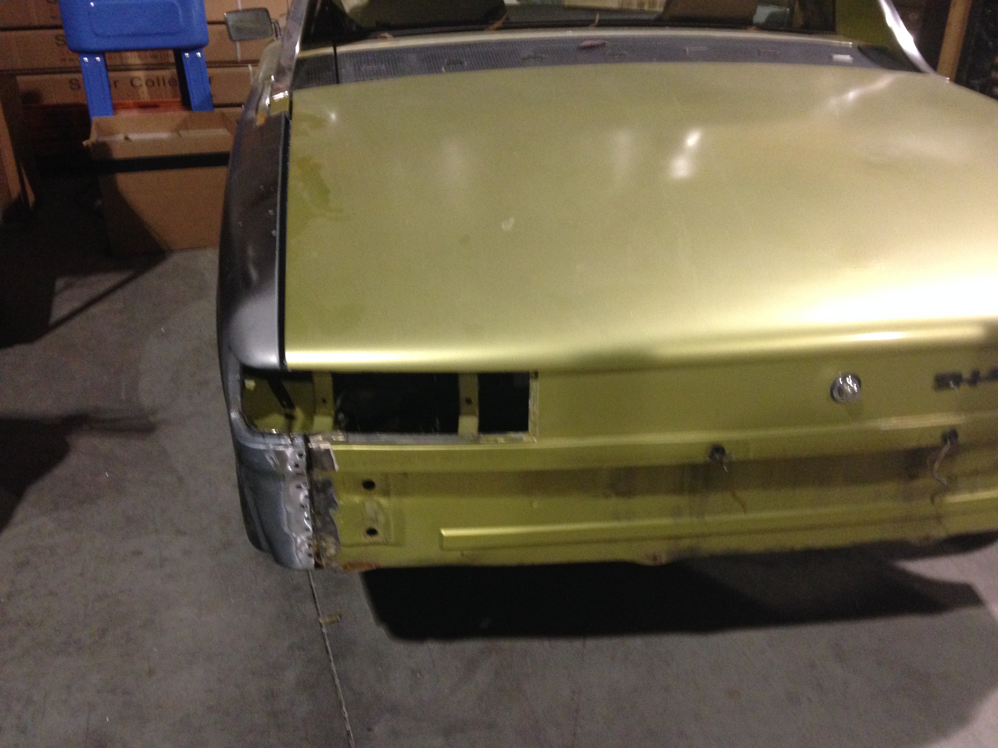

Thanks to Bruce Stone I have some sheet metal to work with. My plan is as follows:
* Plan A:
Use a Port-a-power to push as much of the metal back in to shape and hammer and dolly from there. I have at least one line on an affordable body shop to do the finish work after I rough it in.
* Plan B:
Push some metal back and cut and weld in parts from the lot that Bruce secured for me.
* Plan C:
Push the fronts back in as close as I can get and flare the rear with QRS panels and Duz fastners.

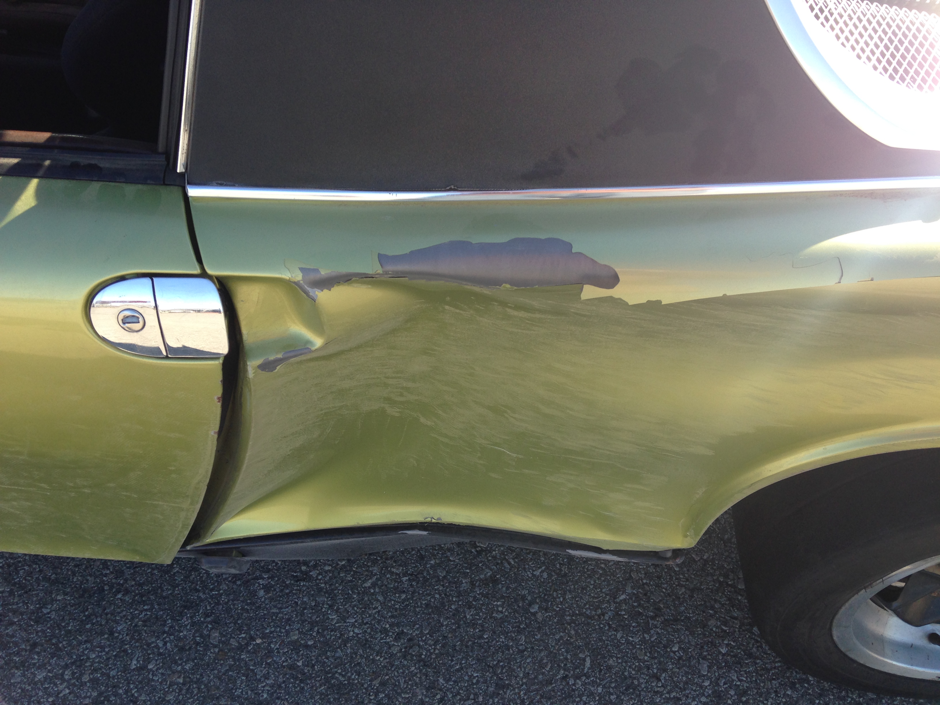

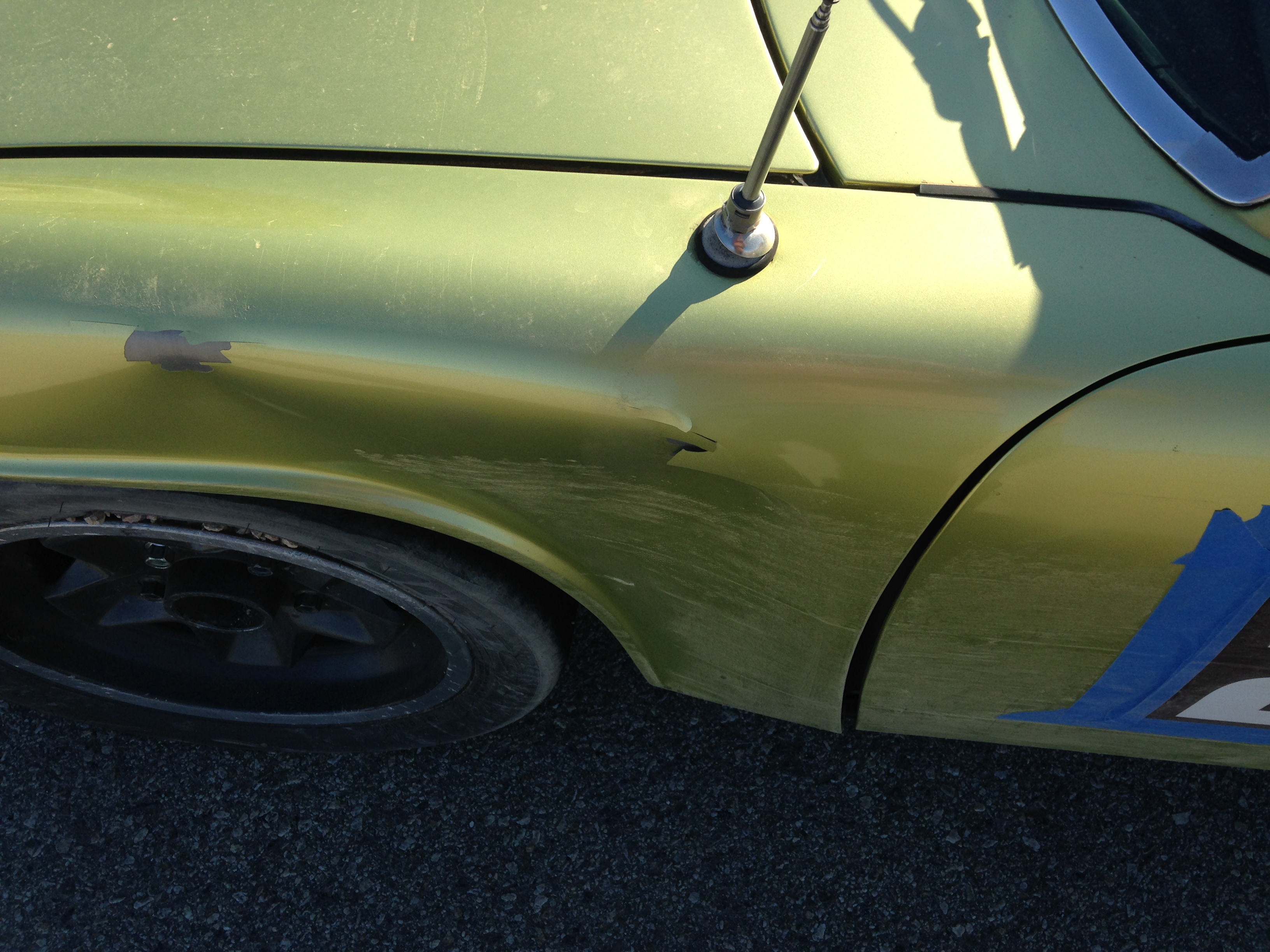

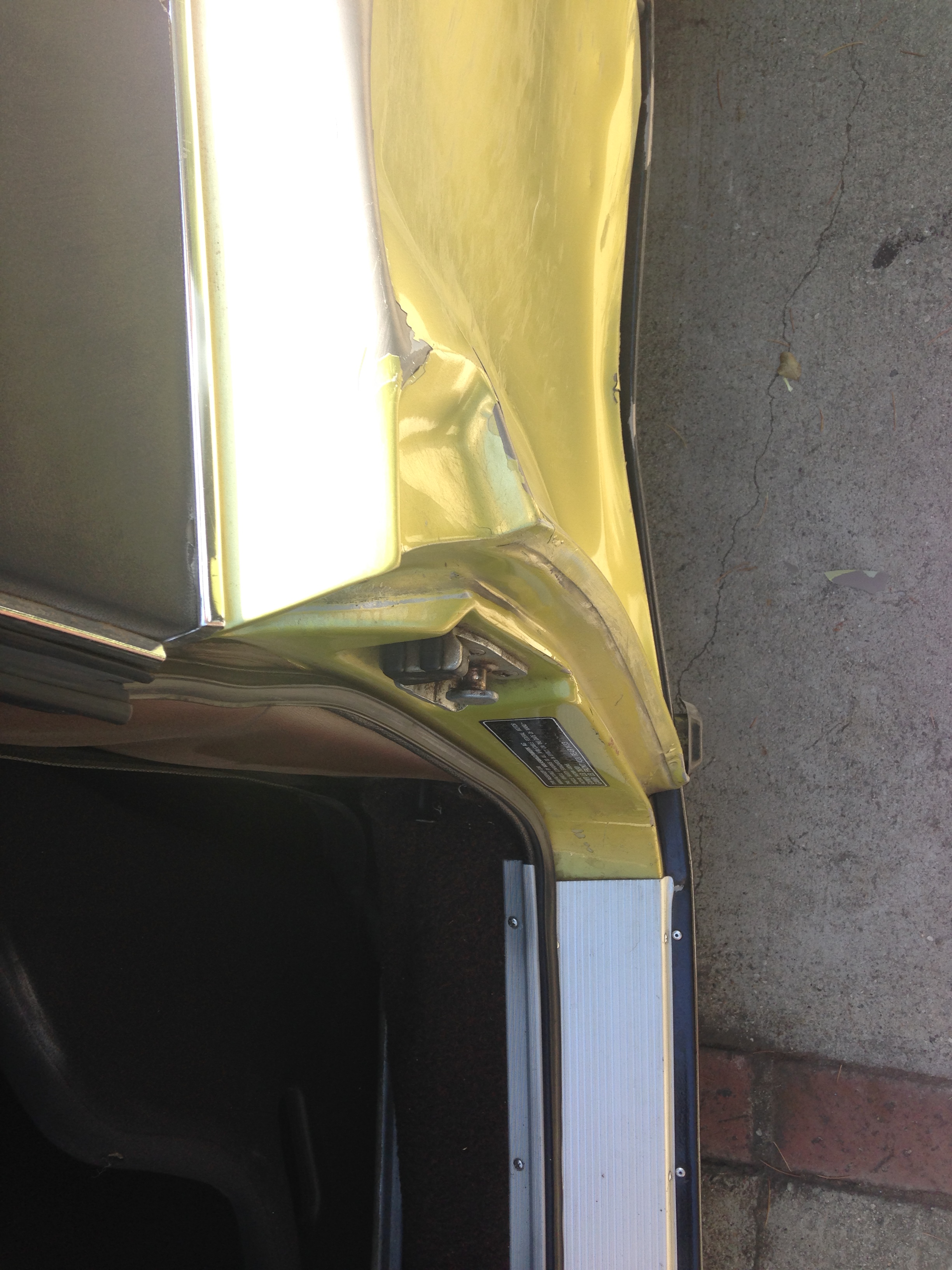

Here's pictures of the damage again:

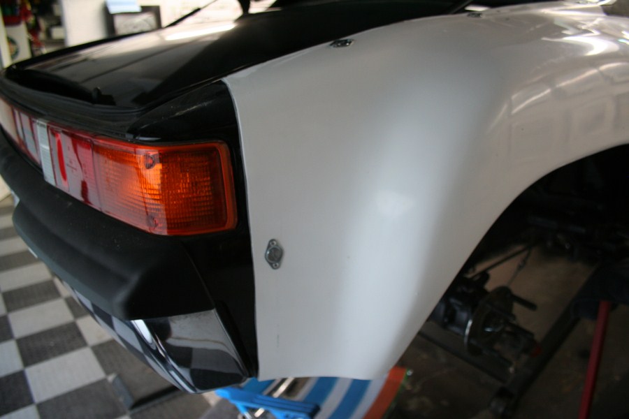

For race only, I like the detachable fenders with Dzus.

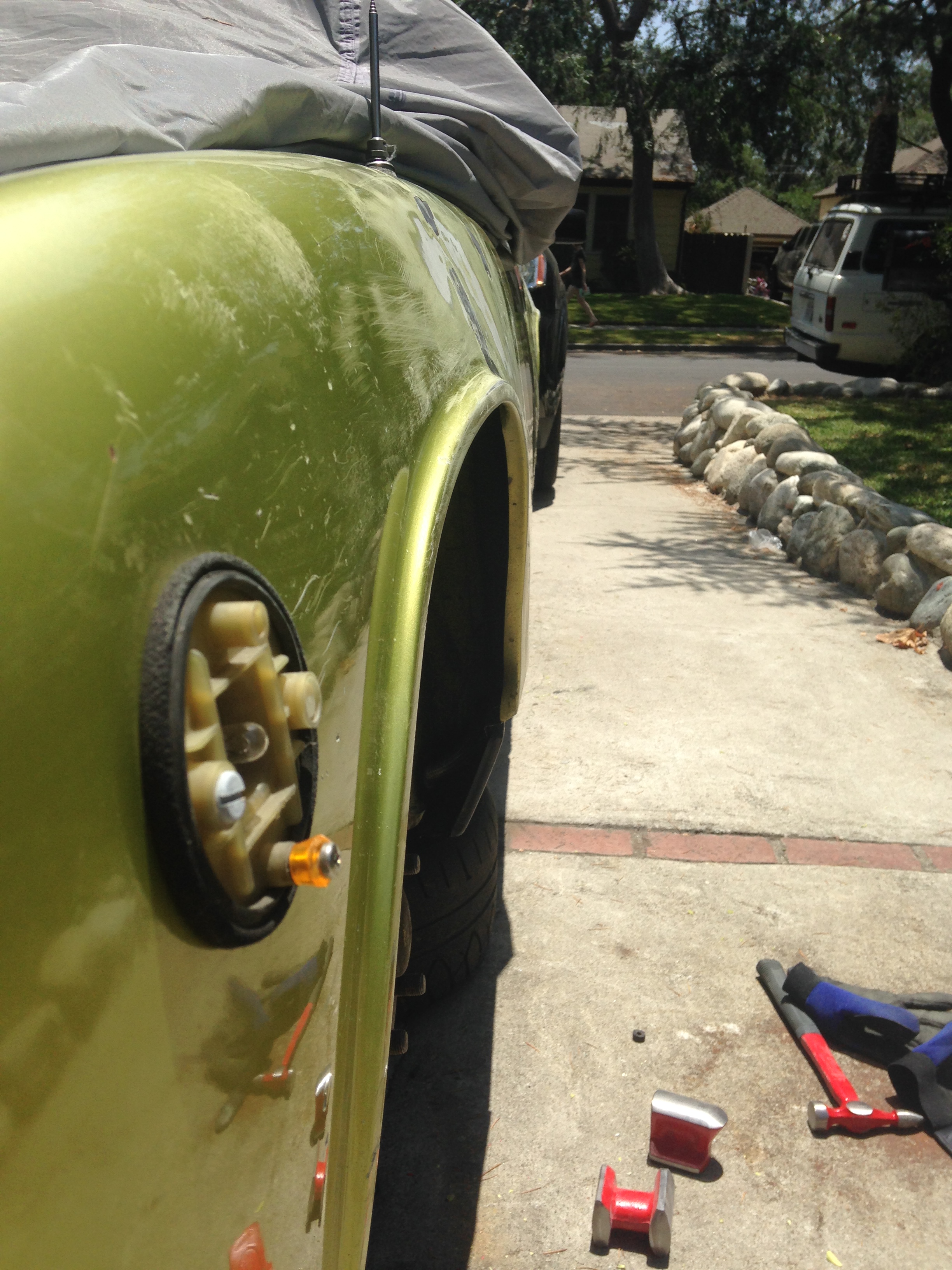

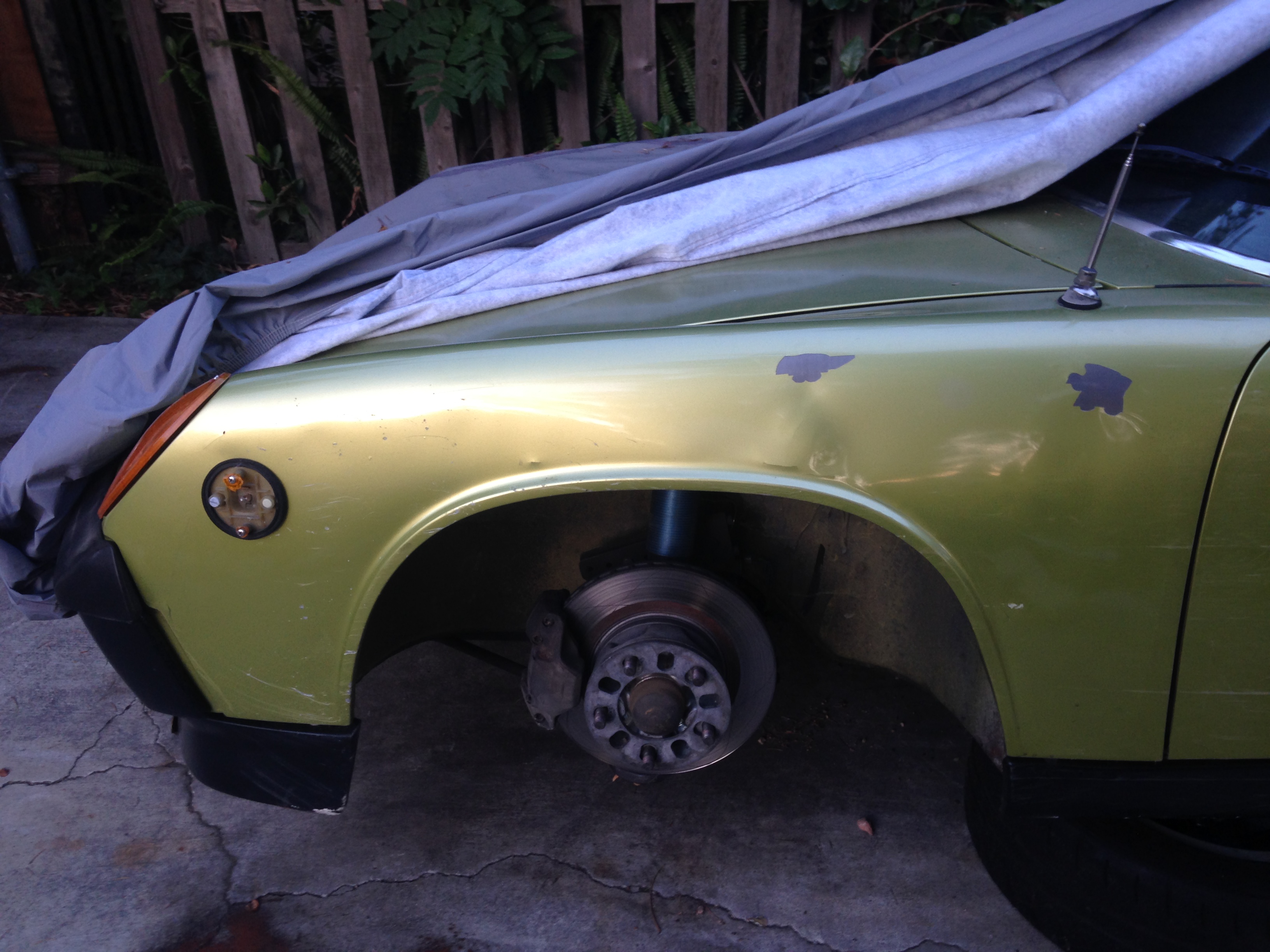

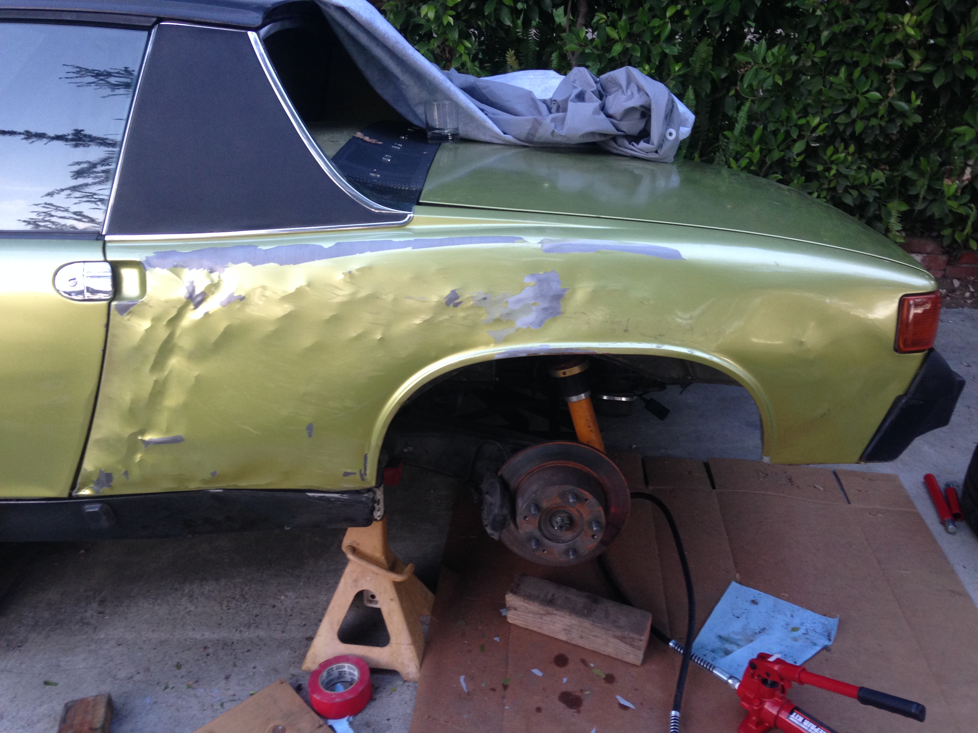

Started work pushing the dents out using a port-a-power. I'll be moving to a hammer and dolly from here to do the finishing work.

Looking good. Good luck with the repairs

Wow your door gaps look great compared to where they were! Nice work.

Looking good. And familiar. I didn't have the guts to start beatin' on mine until I had replacement panels sitting there. Amazing how fast the dents come out. (IMG:style_emoticons/default/smash.gif)

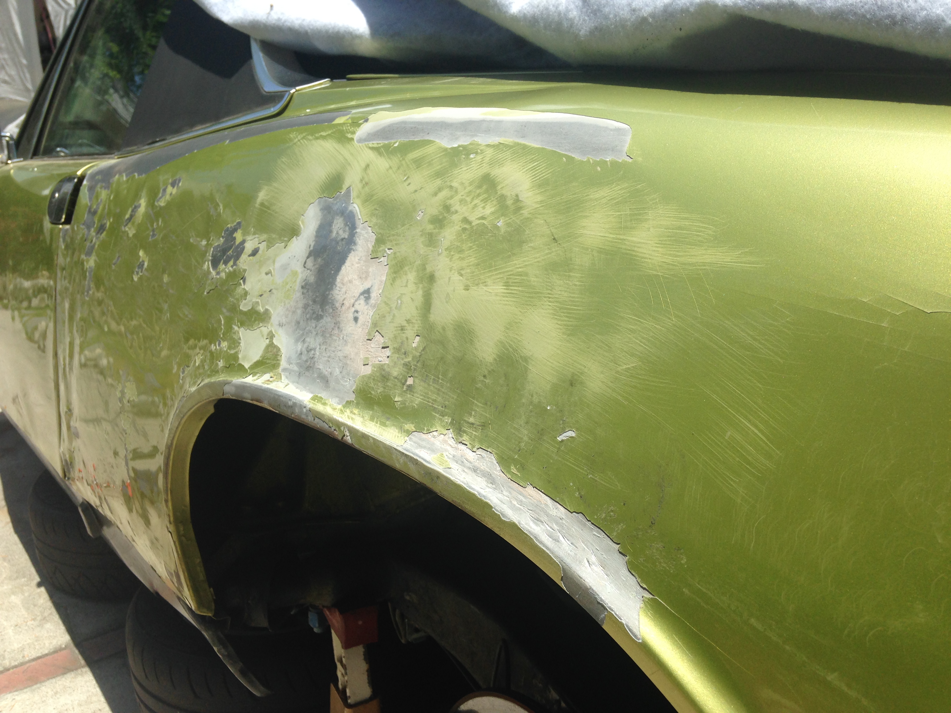

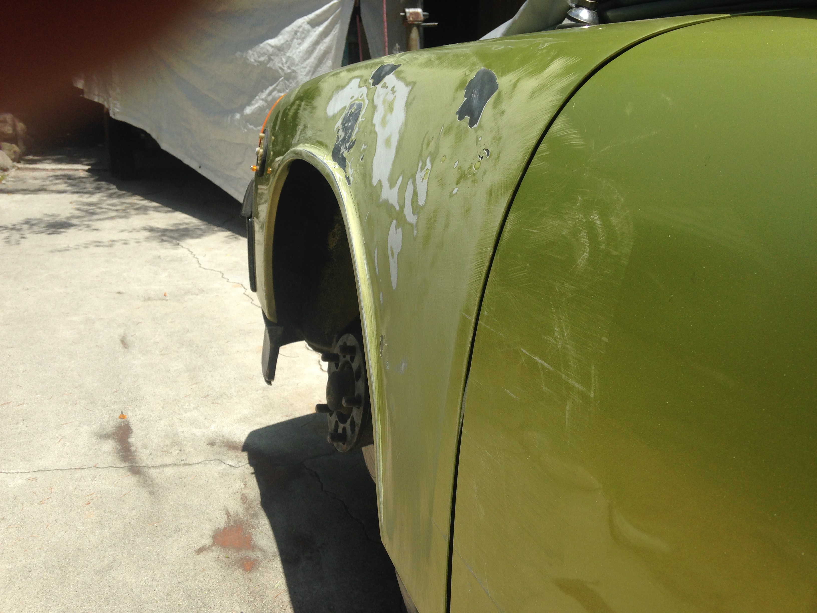

Here is the front fender after some hammer and dolly work.

I think the rear quarter is a goner though. I'm trailering the car to a buddies house who is a metal master with the assumption that we will cut and replace.

You shoulda gone with plan C. (IMG:style_emoticons/default/biggrin.gif) Is that my old airdam? (IMG:style_emoticons/default/laugh.gif)

That bit of spoiler you can see is still my old, LE style aftermarket one. The car is so damn low I'm not sure I could drive it on the street with yours. That and your spoiler needs a TON of TLC. I still appreciate your generosity though!

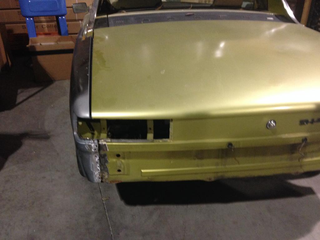

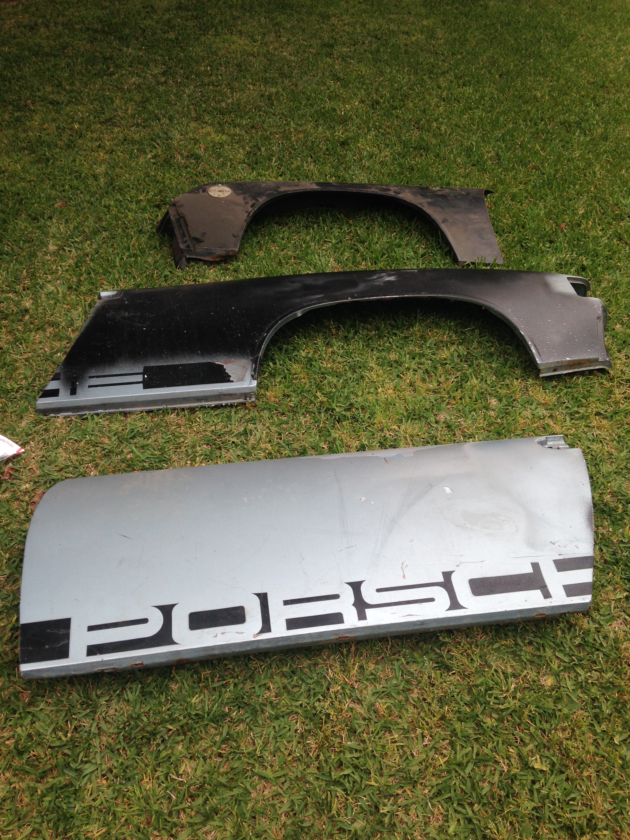

Spare panel is cleaned and ready. Starting work on the car itself.
yeahmag
post Jun 8 2014, 04:58 PM
Posts: 2,456
Joined: 18-April 05
From: Pasadena, CA
Member No.: 3,946

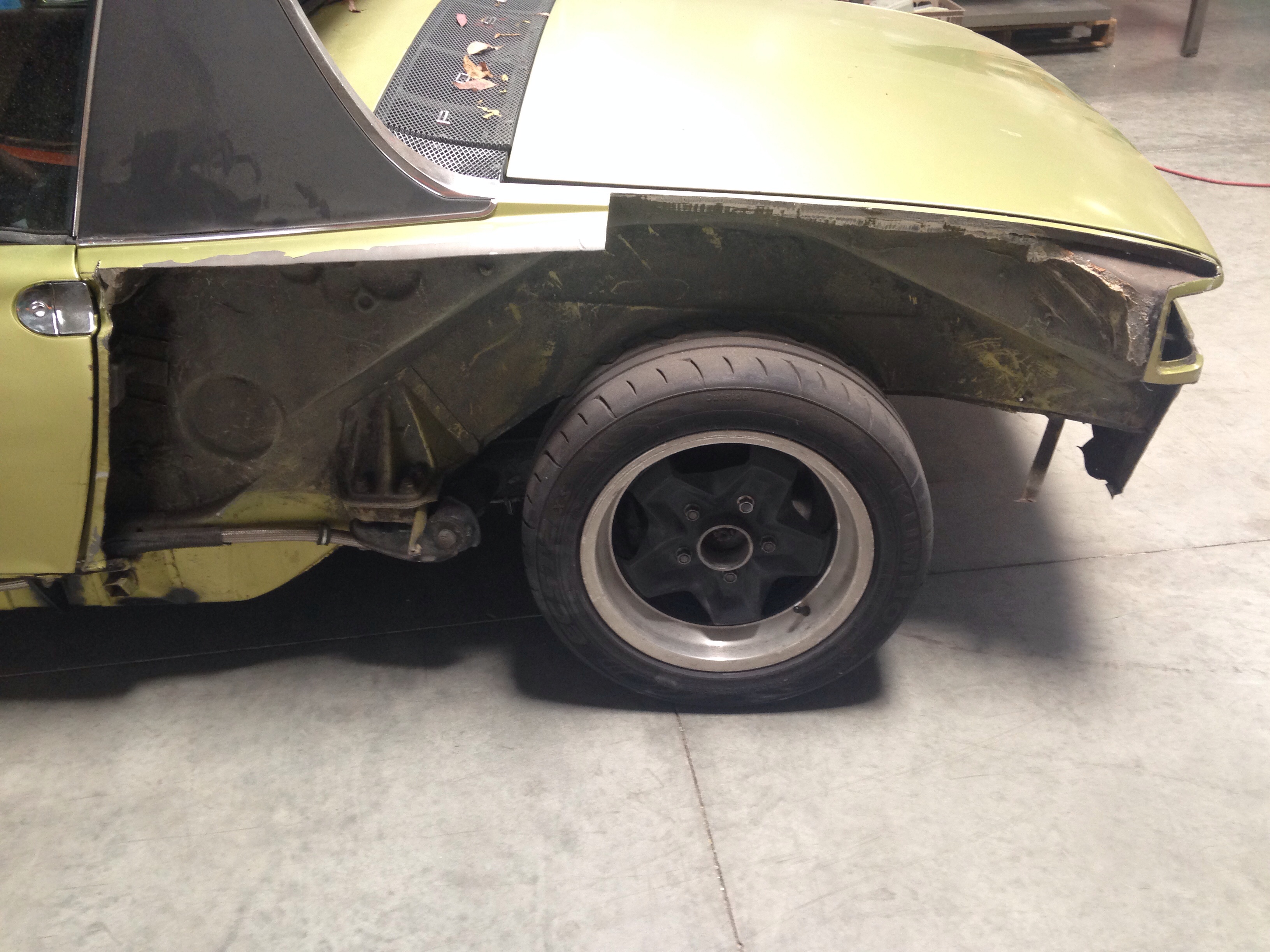

Just some loose cuts to help start fitting the new panel.

If your friend has an English wheel.....see if he can stretch the fender for fatter wheels before you cut it to fit...
yeahmag
post Jun 8 2014, 06:23 PM
Posts: 2,456
Joined: 18-April 05
From: Pasadena, CA
Member No.: 3,946
He does, but I'm only doing one fender, so I may be back to hammer and dolly for that.

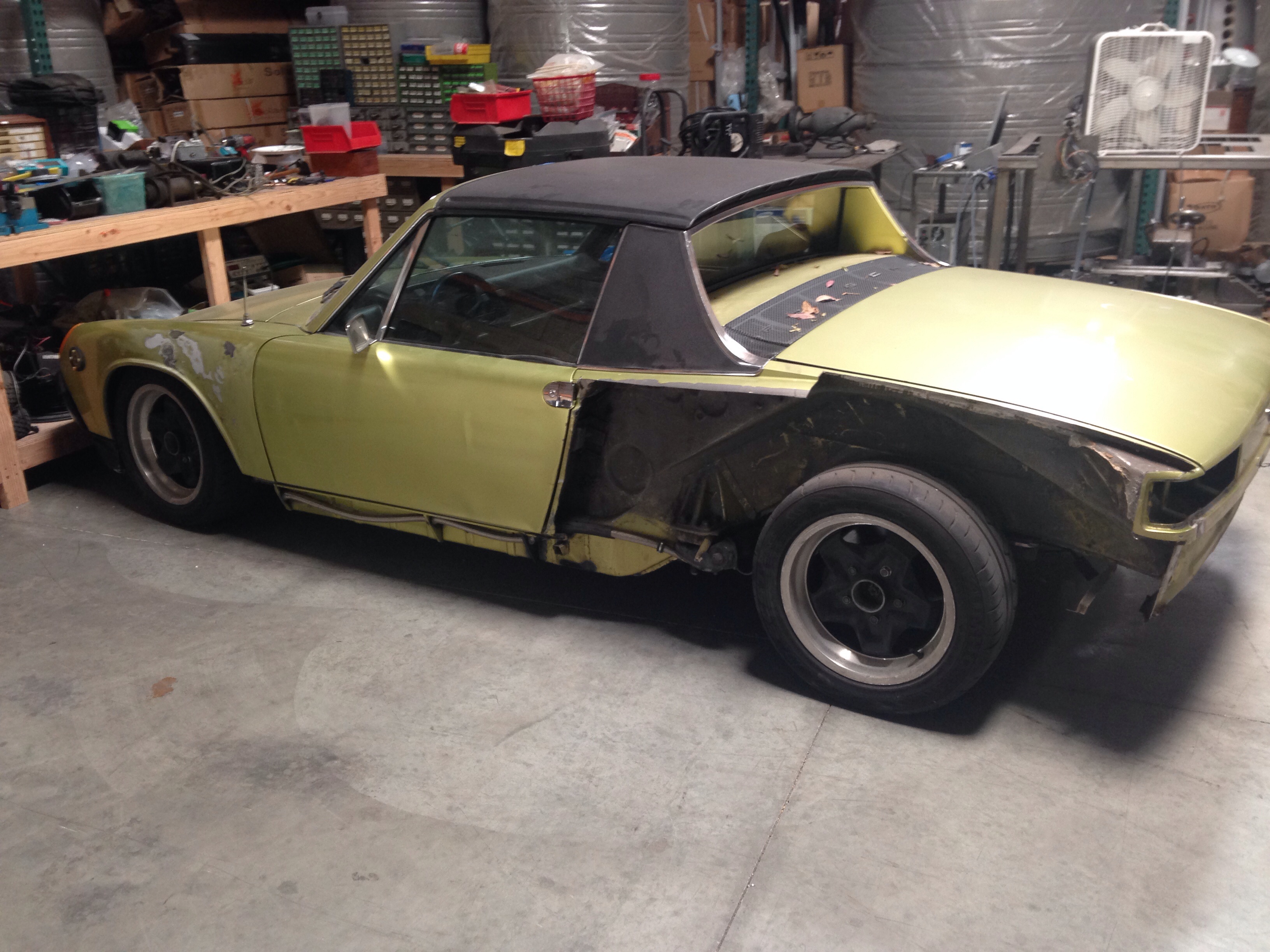

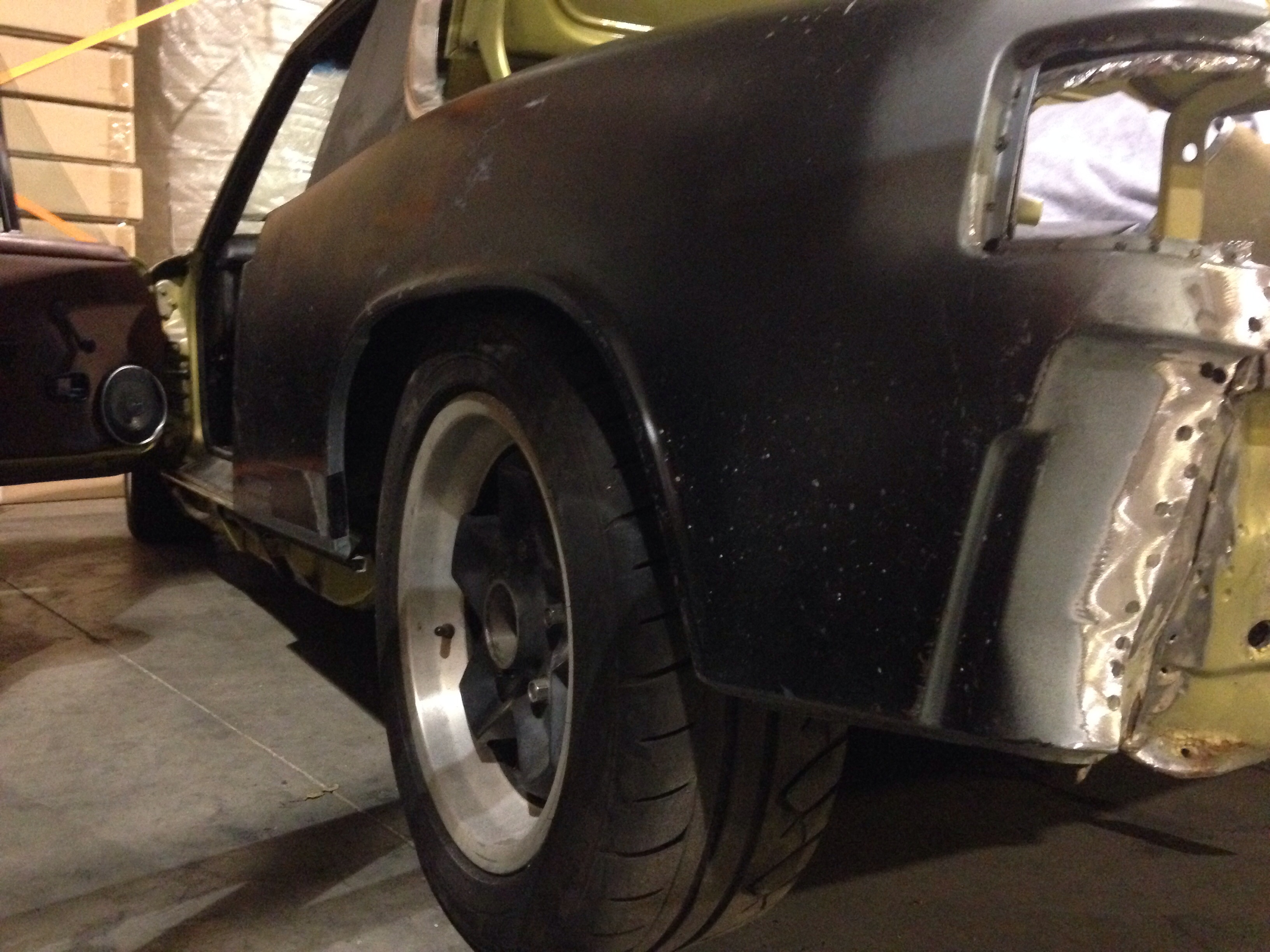

Test fitting has begun.

A few more pictures of us fitting the replacement panel from last night. Getting close now to welding.
