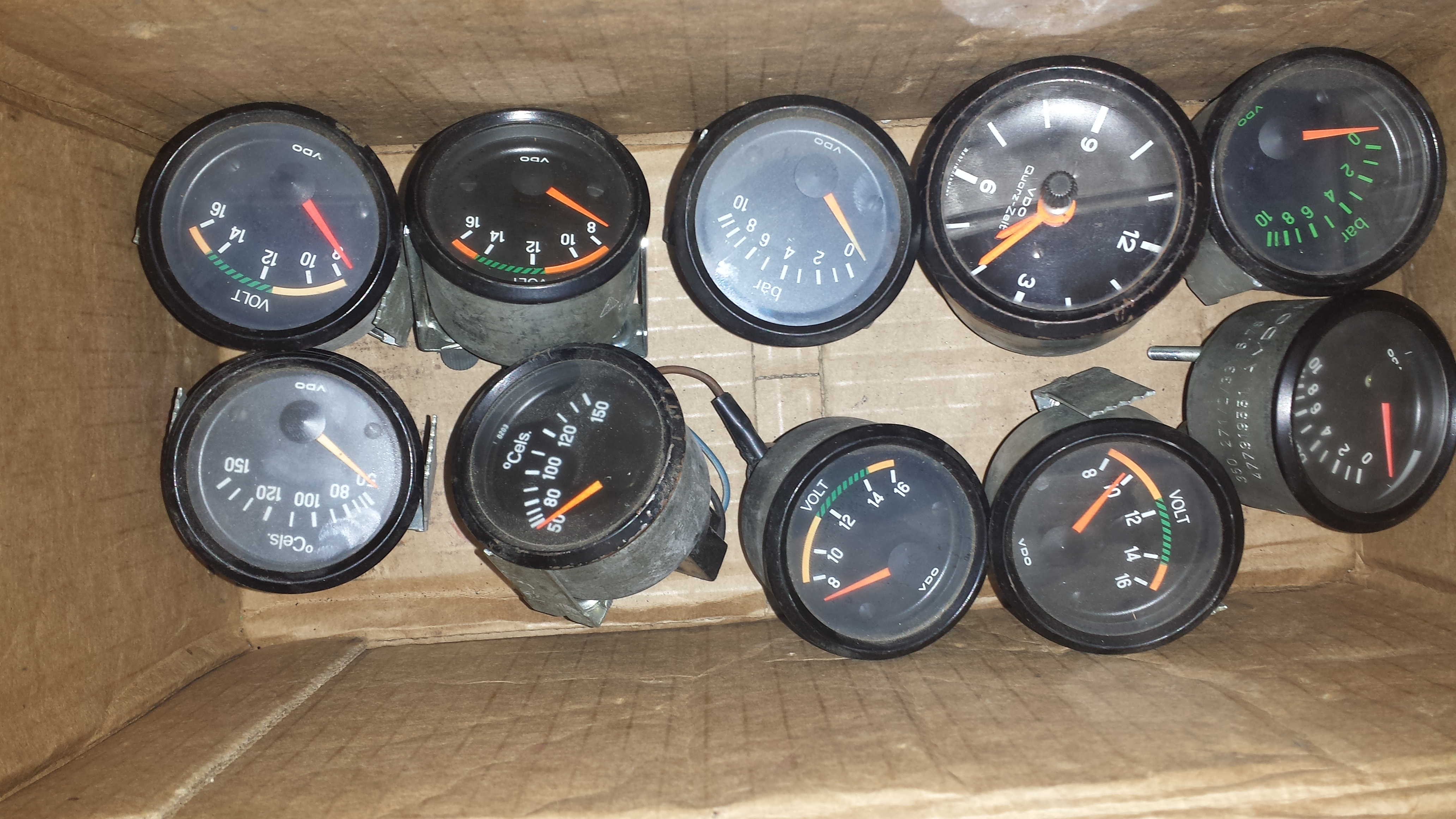

To my knowledge all the current VDO gauges are 52mm which is smaller than the console gauges which are 65mm.
I have used VDO vintage gauges which have steel cases and glass lenses. They are better quality than the current gauges.
I have the 5 bar and 10 bar with matching senders.
Here are a few of them. Note the clock size compared to the other gauges.
Bruce

I guess they are a bit smaller. Since I'm running water cooling, I made a "T" configuration. Oil pressure and Water Temp on top and then left the volt and clock in place.

I thought VDO also had a collar so their gages would fit a bigger hole. Am I wrong? Also with a little work, VDO gages will fit inside 2" plastic pipe.
yeahmag
post Apr 23 2014, 02:25 PM
Posts: 2,455
Joined: 18-April 05
From: Pasadena, CA
Member No.: 3,946
They don't quite fit. You can easily adapt them by building up a ring of electrical tape or by fitting them in to a PVC sleeve (easily built from any home improvement store out of PVC pipe).

Bruce Stone is correct. The current gauges are 52mm and the console gauges are 60mm. There was a conversion ring available at one time. Not sure if they are still available from Pelican. Might also try Egauges.com
