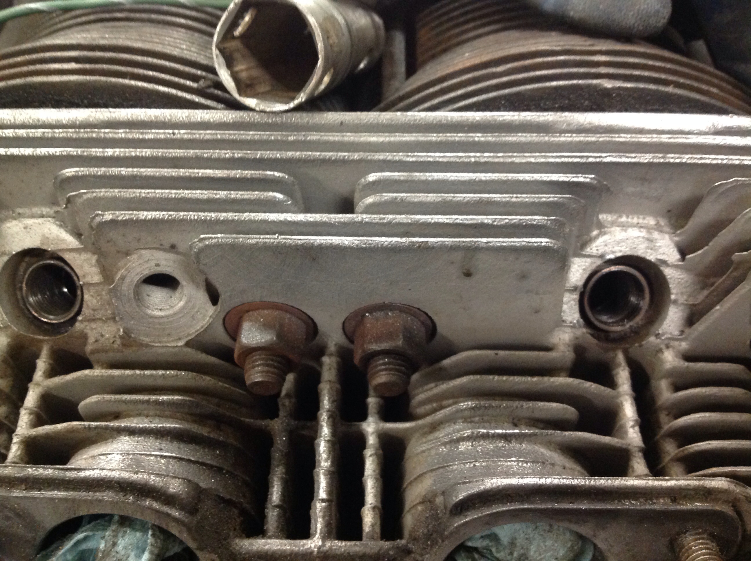

I have my engine out for a bear tub restoration. I am reassembling everything and almost ready to put the engine back in.
As I was cleaning things up replacing the tube seals and getting ready to adjust the valves I found these threaded sleeves in my spark plug holes. Attached Image Attached Image
Looks like a PO was a DA?
Did they strip all of the spark plug threads and use threaded inserts?
I probably wouldn't have even noticed but they are loose and partially back out when I took out the plugs.
They are at different depths now but do they bottom out when the plug is tight?
I can't tell because the base of the plug covers the sleeve when the plugs are in place.
I really don't want to take the heads off. I had no issues prior.
If it ain't broke don't fix it?
Or am I risking a bigger problem?

infraredcalvin   If they're loose, there is a problem, pay now ...   May 14 2014, 12:10 AM
Mblizzard   I had a car with the inserts and never had an issu...   May 14 2014, 05:34 AM
Joe Ricard   Time big insert. I had them in several HI Prefo...   May 14 2014, 05:49 AM
Cap'n Krusty   I disagree, Joe. If they're loose, they'r...   May 14 2014, 08:52 AM
JStroud   Eric, HP machine in Victor(Lodi), has done my mach...   May 14 2014, 09:02 AM
JStroud   Here you go, HP Engine and Machine ...   May 14 2014, 11:36 AM
Cap'n Krusty   BTW, loose plugs, even plugs tight in loose insert...   May 14 2014, 11:45 AM

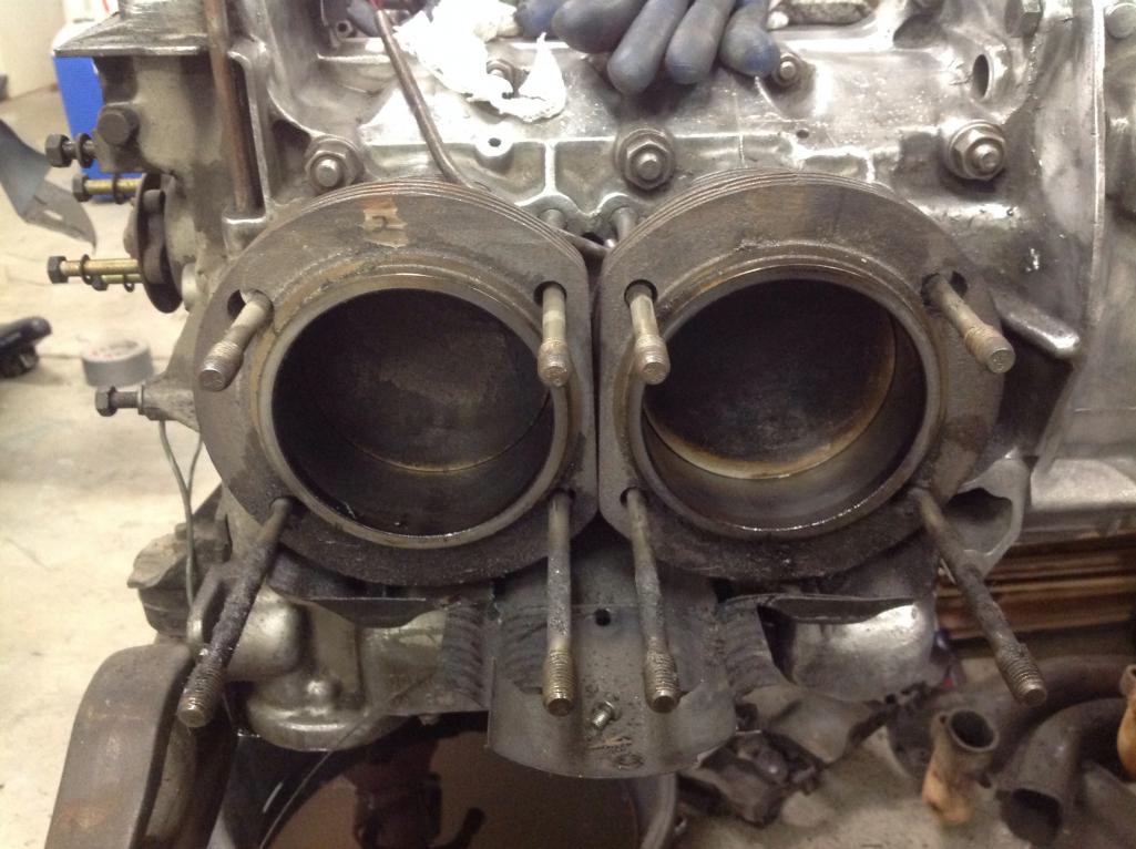

Erben914   Hey any tips on pulling the head? I know to keep t...   May 14 2014, 08:06 PM
Mblizzard   Hey any tips on pulling the head? I know to keep ...   May 14 2014, 08:20 PM
jmill   Had a single port VW motor overheat on me. Heads ...   May 14 2014, 08:14 PM

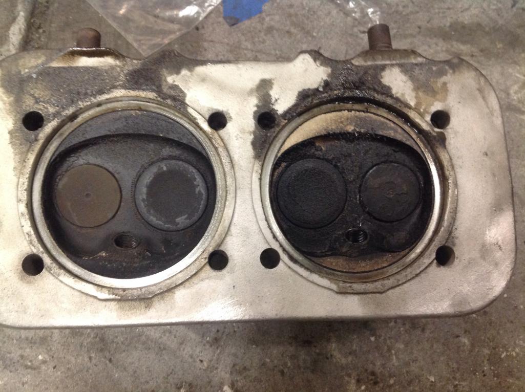

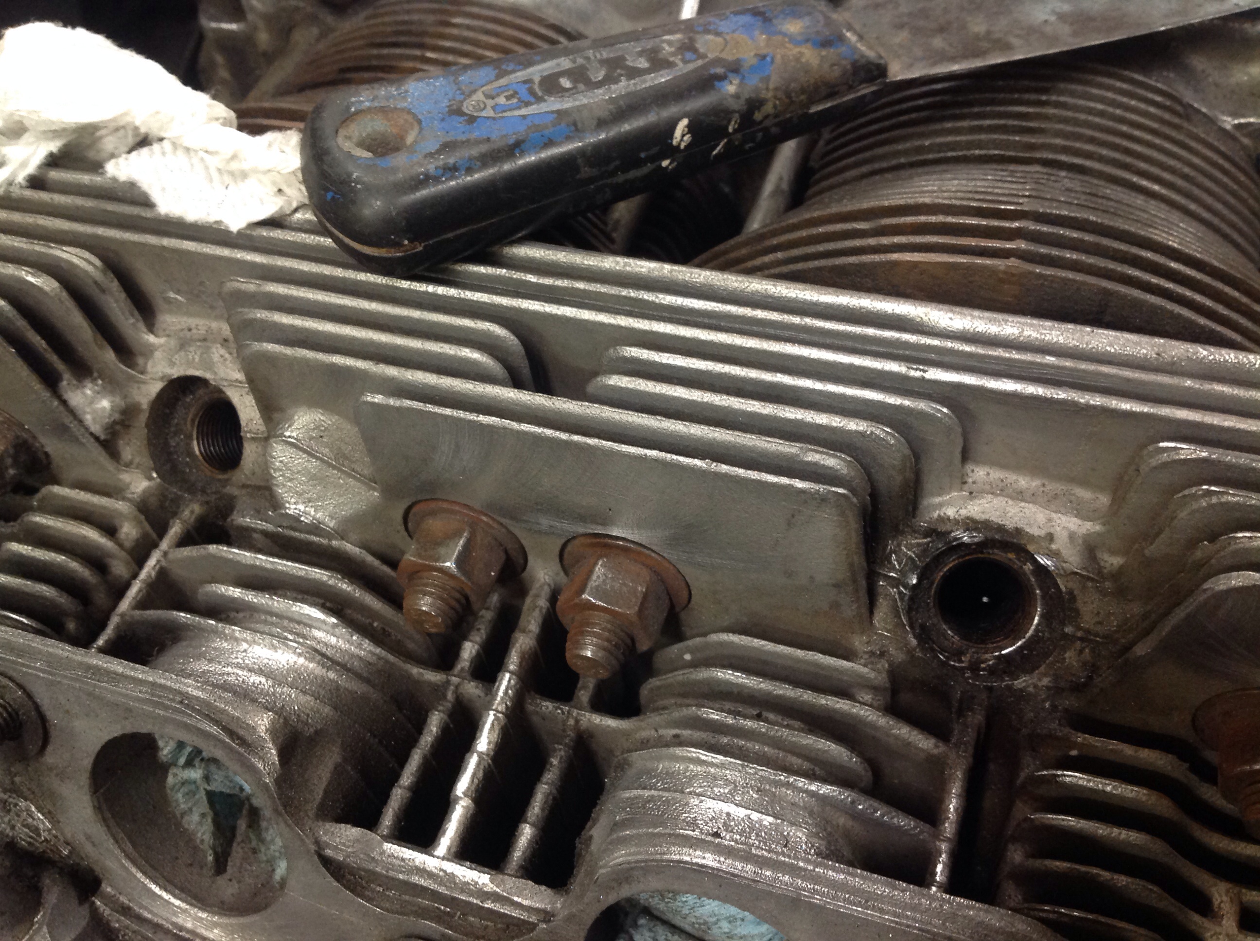

Erben914   Thanks for the advice. Here is what I found. Do y...   May 14 2014, 10:08 PM
Erben914   RE: Spark plug thread inserts.   May 14 2014, 10:10 PM
Mblizzard   Clean the area around the spark plugs and look for...   May 15 2014, 06:27 AM
Erben914   I couldn't find any cracks but two of the inse...   May 17 2014, 12:11 AM
