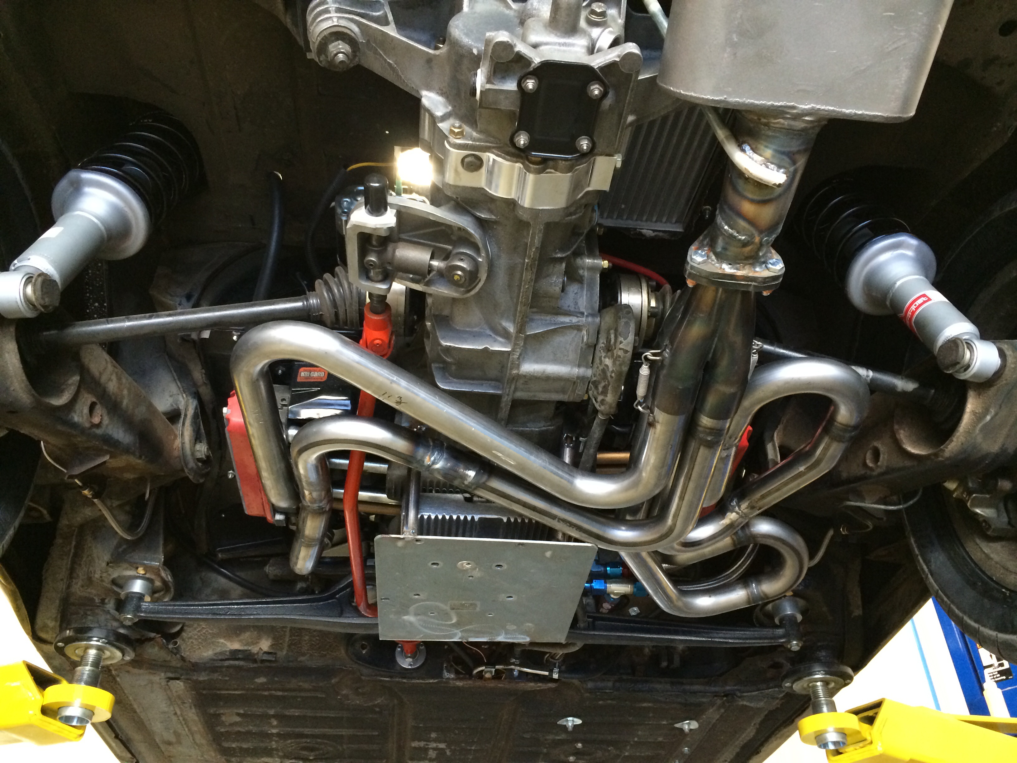

I purchased my deep sump from FAT Performance. I built a skid plate to protect it. I only race it. No issues. I also run an accusump.Attached Image
Elliot Cannon
post May 14 2014, 06:48 PM
Group: Retired Members
Posts: 8,487
Joined: 29-December 06
Member No.: 7,407
Looks nice under there. Skid plate =good idea. (IMG:style_emoticons/default/biggrin.gif)

QUOTE(Blm94 @ May 14 2014, 05:08 PM) *
What header is that?

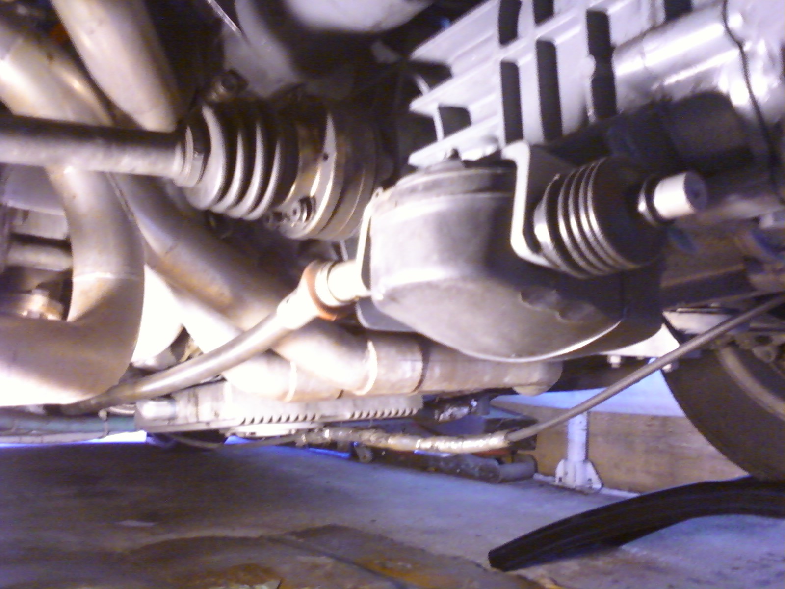

Randal
post May 15 2014, 08:57 AM
Posts: 4,446
Joined: 29-May 03
From: Los Altos, CA
Member No.: 750
And a tuna can can be used for something more important!

QUOTE(Randal @ May 15 2014, 08:57 AM) *
Sick!
brant
post May 15 2014, 10:52 AM
Posts: 12,159
From: Colorado
Member No.: 47
boy the webbing on the case that the stock strainer/tuna can uses for attatchment doesn't seem strong enough for this idea...
a lot of leverage is added to your can with that small line
vibration isn't going to be a friend of that engineering
brant

Cap'n Krusty
post May 15 2014, 11:47 AM
Cap'n Krusty
Posts: 10,794
Joined: 24-June 04
From: Santa Maria, CA
Member No.: 2,246
I would be interested in seeing exactly how the deep sump unit is secured to the case. On T1s and 356/912 engines, there are 6 and 10 bolts, respectively, to mount it to the case. There is no such provision on the T4. As for that "skid plate", I see no structural integrity whatsoever, it appears to be nothing more than eye candy; my eyes are old, but it looks like one glancing blow and it's gone, along with whatever it's bolted to.
The Cap'n

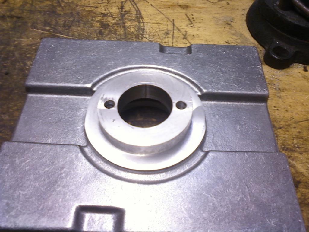

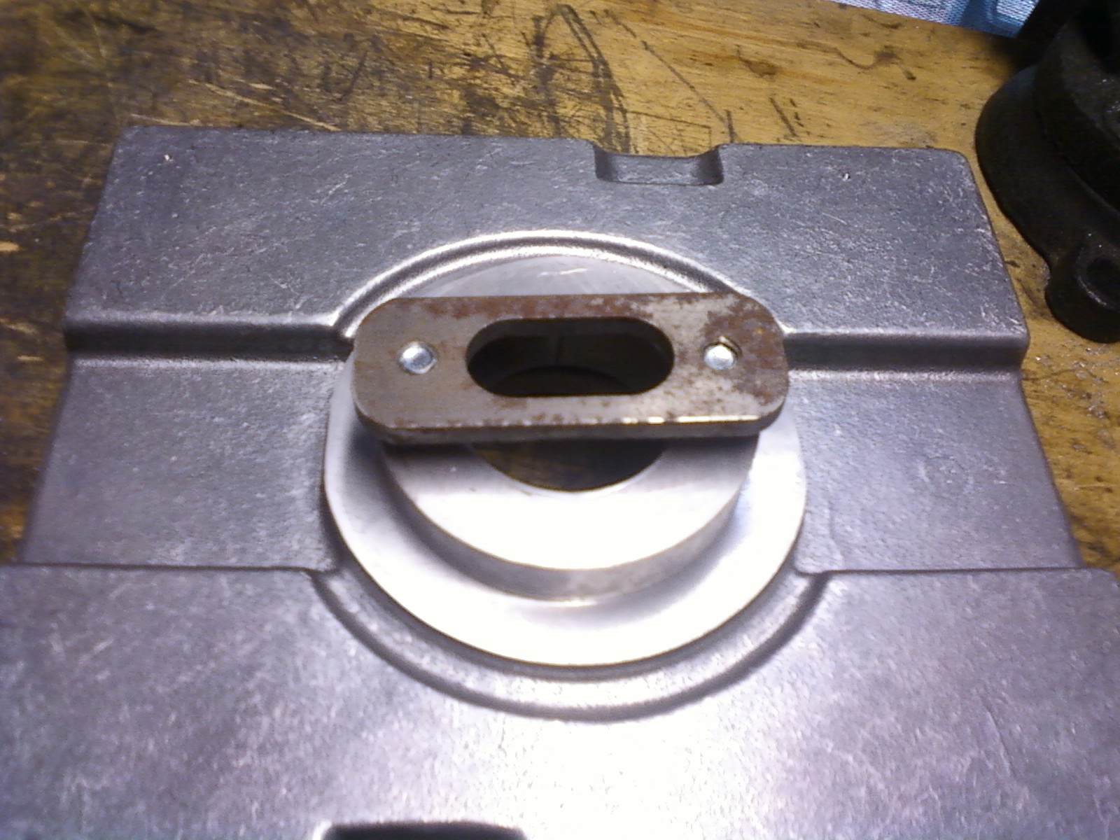

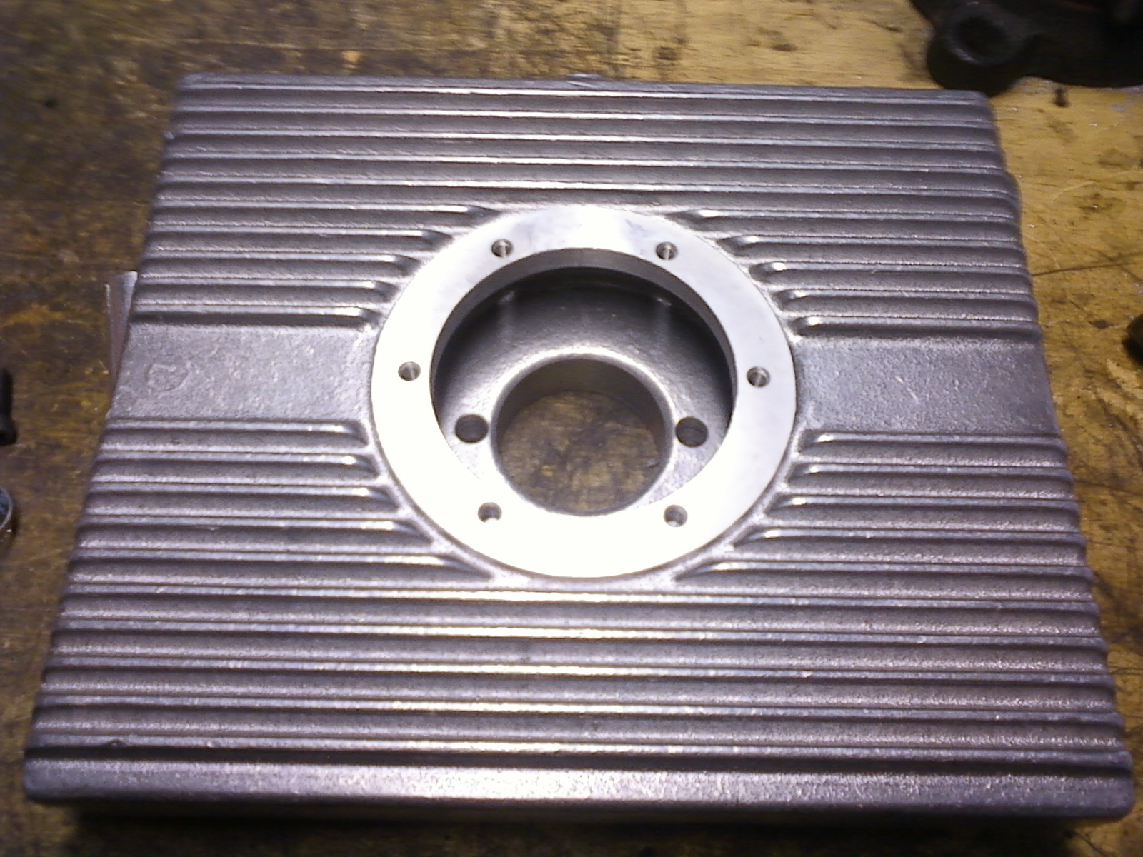

post May 15 2014, 03:31 PM
Posts: 313
Joined: 1-March 08
From: suburbs of Miami FL.
Member No.: 8,762
Here you go Cap'n , this is a new one for my future twin plug (IMG:style_emoticons/default/smile.gif) , I've modified mine
by milling an angle on the riser that sits in the step of the case so that it mounts more
flush to bottom of the motor (IMG:style_emoticons/default/smile.gif) , Bill D.
here is pic of my old one mounted
here's pic's of the new one
Mark Henry
post May 15 2014, 03:58 PM
that's what I do!
Posts: 20,065
Joined: 27-December 02
From: Port Hope, Ontario
Member No.: 26
I've always thought the deep sump fit, the way it hangs down, sucks.
I also don't like that turbo oil return line, hot foamy oil going straight to the pick-up, the engine won't live long.
I would have run it to the taco plate or machined the bus oil fill or pump boss.
Cap'n Krusty
post May 15 2014, 04:33 PM
Cap'n Krusty
Posts: 10,794
Joined: 24-June 04
Member No.: 2,246
Thanks for the picture. Is it difficult to fit that bracket between the case and the oil pickup. I don't remember how much clearance there is, but I think it's not much. All things considered, I don't think I'd use one of those.

Randal
post May 16 2014, 10:31 AM
Posts: 4,446
Joined: 29-May 03
From: Los Altos, CA
Member No.: 750
QUOTE(brant @ May 15 2014, 09:52 AM) *
brant
There is a lot more engineering you can't see. (IMG:style_emoticons/default/smile.gif)
