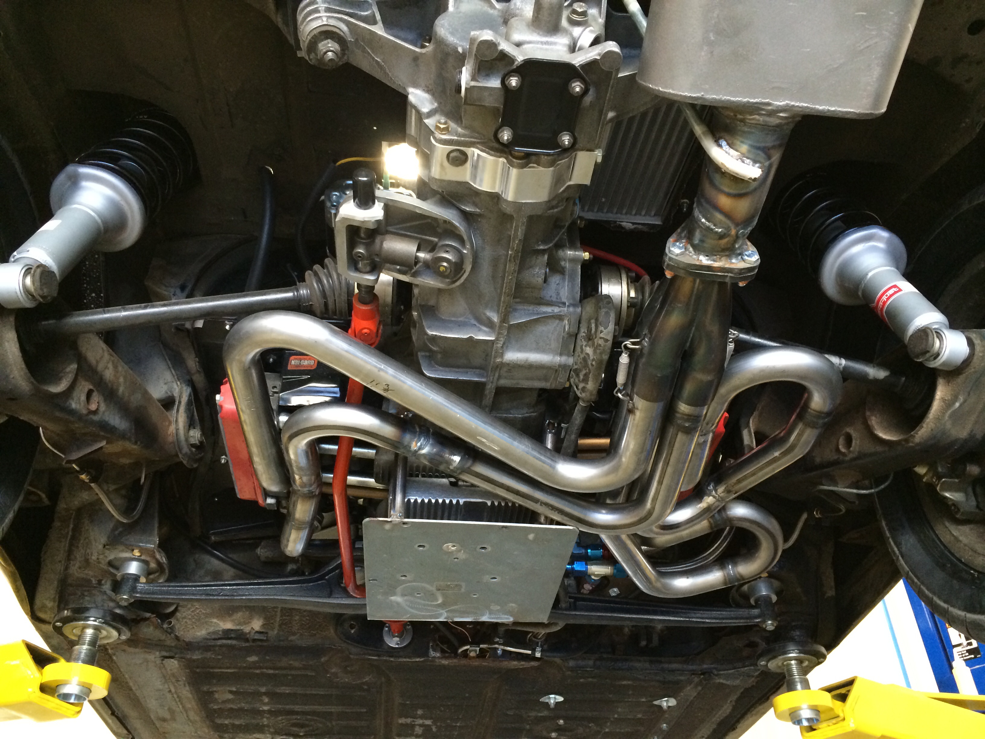

I purchased my deep sump from FAT Performance. I built a skid plate to protect it. I only race it. No issues. I also run an accusump.Click to view attachment
Elliot Cannon

QUOTE(Blm94 @ May 14 2014, 05:08 PM) *
What header is that?

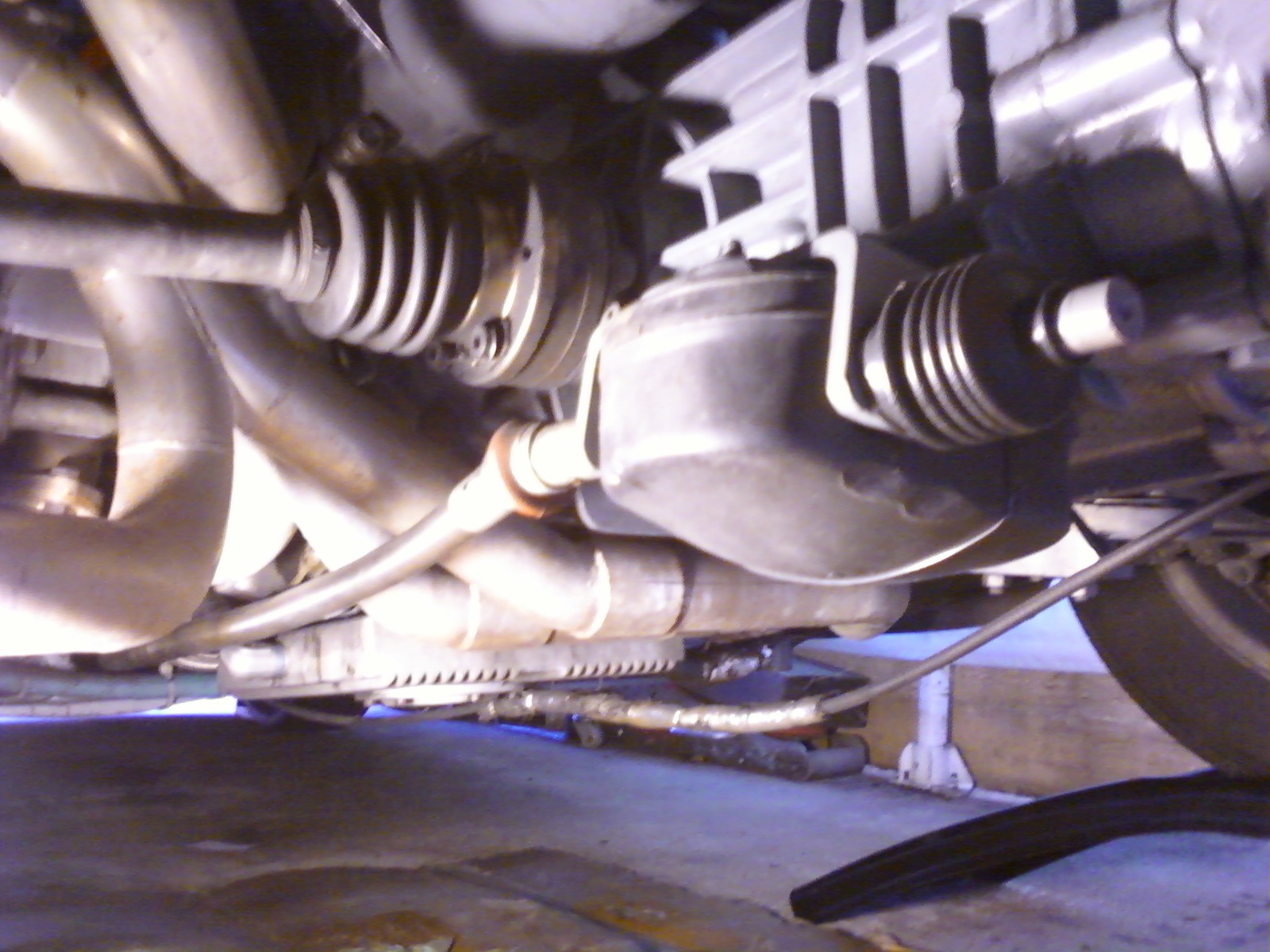

Randal
And a tuna can can be used for something more important!
vw505
Turbo return line.....

QUOTE(Randal @ May 15 2014, 08:57 AM) *
Sick!
brant
boy the webbing on the case that the stock strainer/tuna can uses for attatchment doesn't seem strong enough for this idea...
a lot of leverage is added to your can with that small line
vibration isn't going to be a friend of that engineering

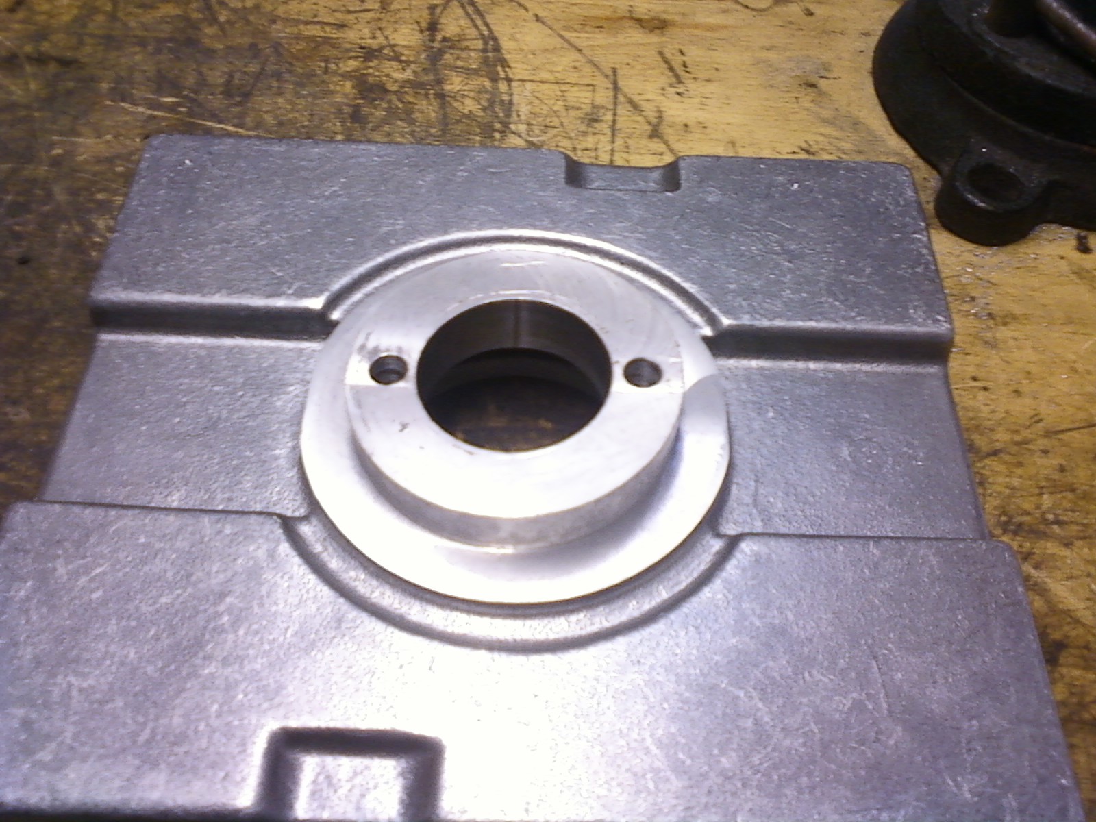

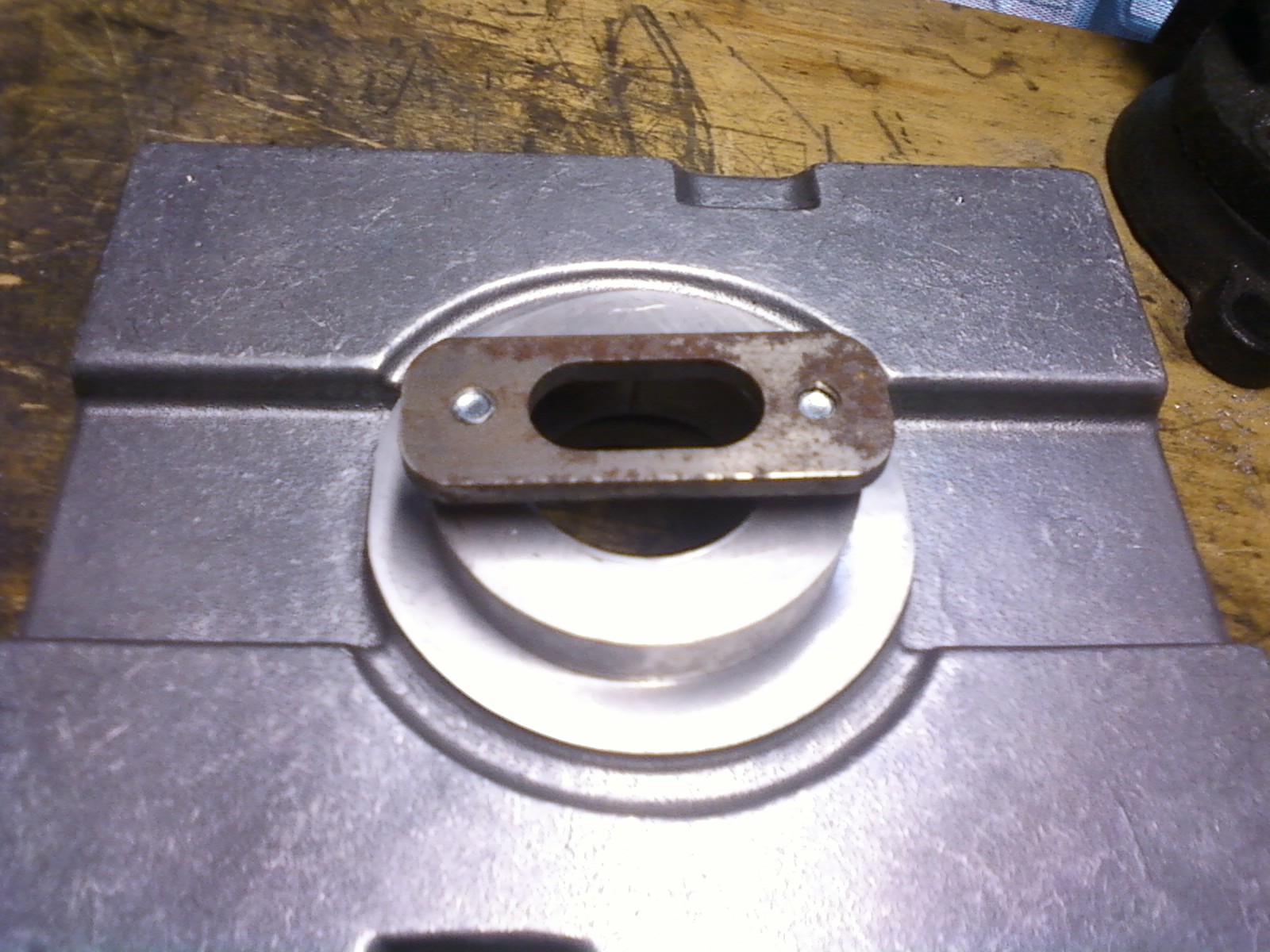

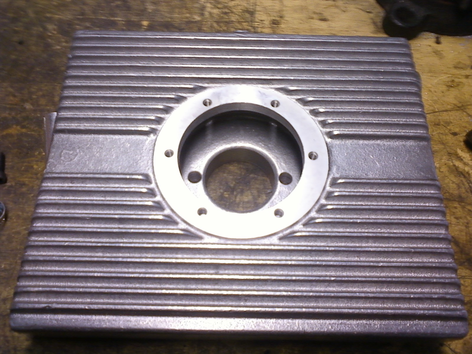

I would be interested in seeing exactly how the deep sump unit is secured to the case. On T1s and 356/912 engines, there are 6 and 10 bolts, respectively, to mount it to the case. There is no such provision on the T4. As for that "skid plate", I see no structural integrity whatsoever, it appears to be nothing more than eye candy; my eyes are old, but it looks like one glancing blow and it's gone, along with whatever it's bolted to.
The Cap'n
Bills914-4
Here you go Cap'n , this is a new one for my future twin plug smile.gif , I've modified mine
by milling an angle on the riser that sits in the step of the case so that it mounts more
flush to bottom of the motor smile.gif , Bill D.

I've always thought the deep sump fit, the way it hangs down, sucks.
I also don't like that turbo oil return line, hot foamy oil going straight to the pick-up, the engine won't live long.
I would have run it to the taco plate or machined the bus oil fill or pump boss.
Cap'n Krusty
Thanks for the picture. Is it difficult to fit that bracket between the case and the oil pickup. I don't remember how much clearance there is, but I think it's not much. All things considered, I don't think I'd use one of those.

Randal
QUOTE(brant @ May 15 2014, 09:52 AM) *
brant

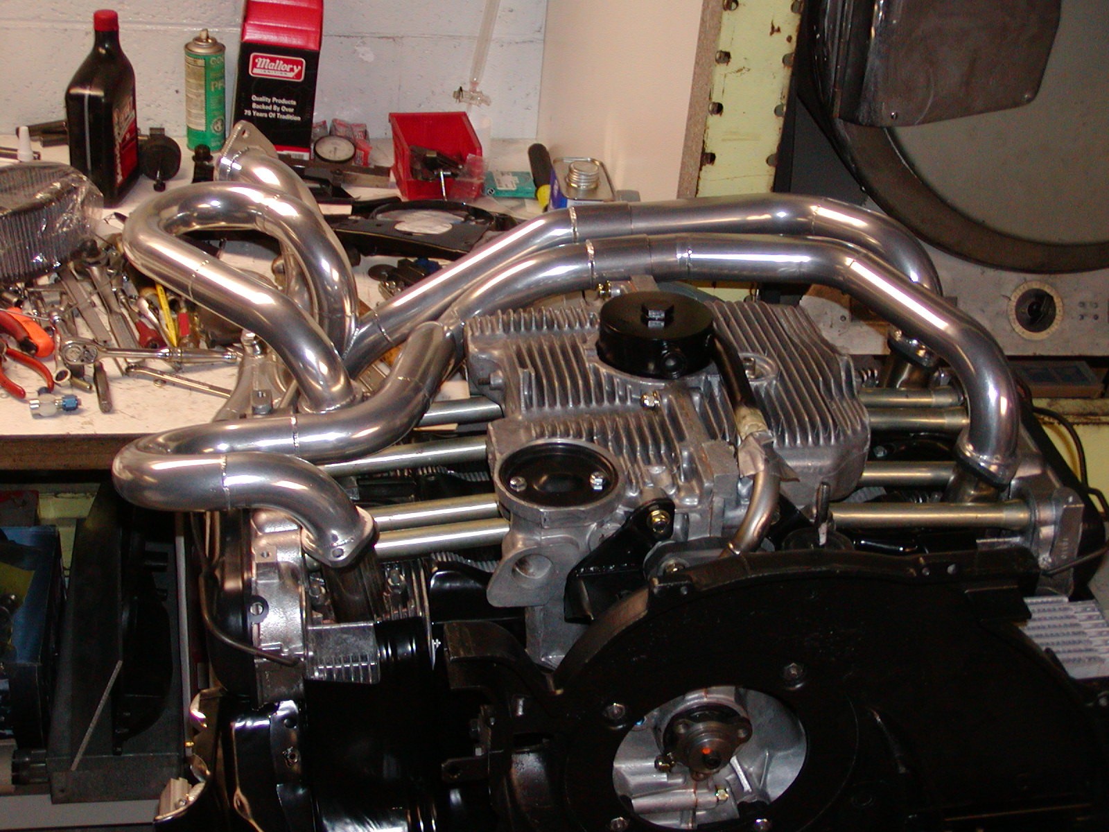

Blm94
QUOTE(vw505 @ May 15 2014, 06:39 AM) *
Built by Greg @ FAT Performance. First one. They have the jigs to build them now. I have really enjoyed working with them on the engine build and the headers.
Lots of nice work under there!
