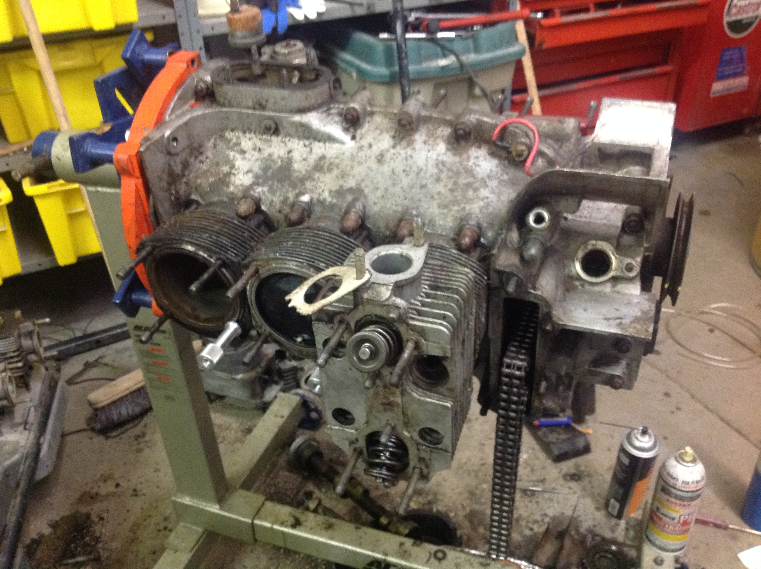

Pulling apart that Aluminum case 2.0 motor in anticipating to sell it and cant seem to get one of the heads off.
Motor has been sitting for 20 plus years and rotates freely.
4 heads came off with a little more than a ketchup bottle thump.
1 head came off with the cylinder attached
The other one, wont seem to budge. Made sure all washers were removed. been soaking with PB Blaster for a couple of days

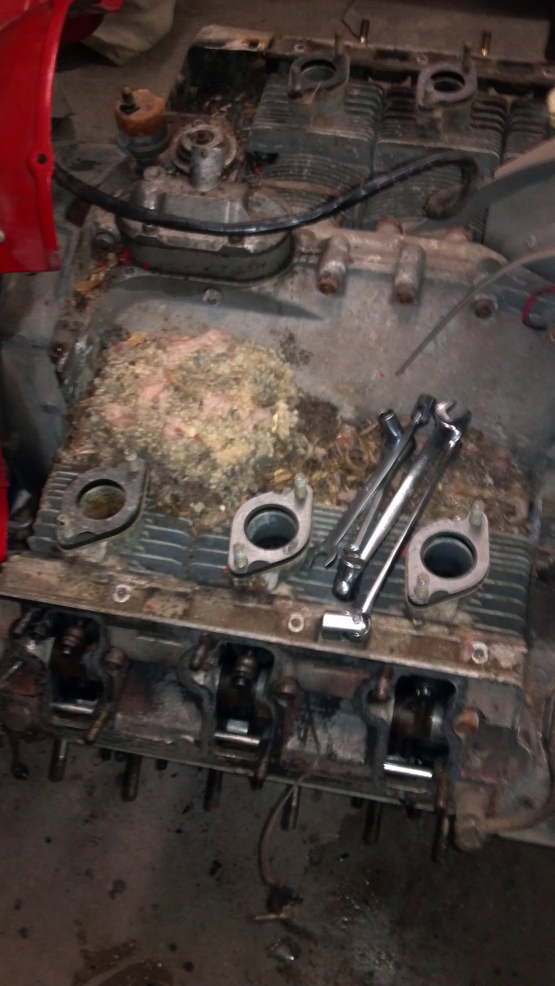

BTW: motor had been sitting for several years and a mouse had made a nest on top of that particular cylinder.
Hence - Mouse motor...

mr914   Stuck 6 cyl head   May 15 2014, 11:12 AM
stugray   I would suggest filling up the cyl with a little o...   May 15 2014, 11:21 AM
Justinp71   More power! :smash: When I did mine I remov...   May 15 2014, 11:21 AM
mr914   Stugray = you may be on the right track. With n...   May 15 2014, 11:43 AM
mr914   5 of 6 cylinders heads off 3 cylinders off   May 15 2014, 11:44 AM
Mike Bellis   Put a spark plug back in it at BDC and rotate the ...   May 15 2014, 12:17 PM
mr914   If I was going to do that, shouldn't I remove ...   May 15 2014, 12:21 PM
Mike Bellis   If I was going to do that, shouldn't I remove...   May 15 2014, 12:51 PM
Jon B   Check to make sure all cylinder head nuts are remo...   May 15 2014, 01:15 PM
KELTY360   Wouldn't the rope trick work? Get piston at BD...   May 15 2014, 01:44 PM
Scott S   Wouldn't the rope trick work? Get piston at B...   May 15 2014, 02:46 PM
toolguy   do not pry against the cylinder fins, they will b...   May 15 2014, 01:56 PM
Jon B   ...if you hit sideways it can bend the rod. Bend a...   May 15 2014, 02:23 PM
Nine_14   If none of the above given suggestions helps, brin...   May 15 2014, 02:26 PM
mr914   If none of the above given suggestions helps, bri...   May 15 2014, 02:37 PM
Nine_14   If none of the above given suggestions helps, br...   May 15 2014, 02:48 PM
mr914   Confirmed last night that all of the nuts and wash...   May 15 2014, 02:42 PM
injunmort   gently heat the seam with a torch or heat gun, the...   May 15 2014, 04:08 PM

mr914   Hmm.. Will have to post photo of universal cat car...   May 15 2014, 08:17 PM
injunmort   a little heat will cure the oxidation, just say...   May 15 2014, 08:31 PM
Bob L.   There was a recent thread about using vinegar to d...   May 15 2014, 09:38 PM
Mblizzard   Don't know if there are enough threads on thos...   May 16 2014, 06:06 PM
mr914   :beer1: Some very good ideas and some unique ones...   May 19 2014, 09:39 AM
stugray   Put it in an old crock pot full of vinegar and put...   May 19 2014, 10:42 AM
sixnotfour   I have had the same problem, and cut the stud...BT...   May 19 2014, 11:52 AM

mr914   Hmm..... Now this is a dilemma Sell or rebuild...   Jun 12 2014, 02:03 PM
mr914   Update: Had one of the cylinders stuck to the hea...   Jun 12 2014, 02:05 PM
