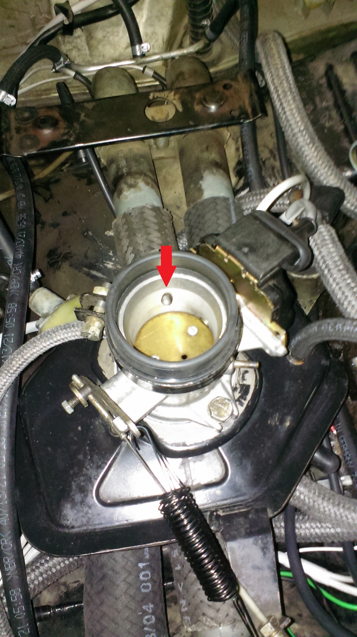

It idles too fast (1300 / 1400 RPM) considering throttle valve bypass screw is all the way in. Also, it runs lean (using WB A/F meter). I have set the mixture adjustment on the ECU full CW to get mixture around 13.7:1. I think I have covered all the common vacuum leak issues described in other threads. Any suggestions appreciated. I have two specific questions below.

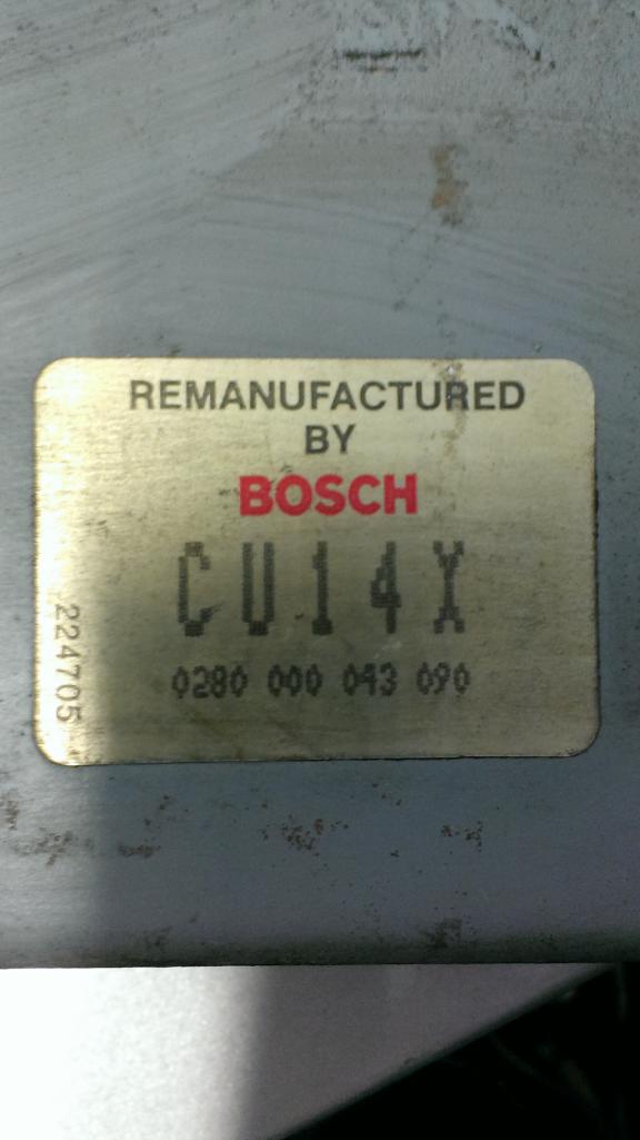

1) Is my ECU P/N correct? The base P/N is correct but not sure what the 090 suffix means.
2) With the throttle valve bypass screw turned in full CW there is still vacuum getting past the screw. Does anybody know if that is normal ? I can put my finger over the port and feel vacuum. Maybe by design it is not meant to provide positive shut off but I don't have enough experience to say one way or the other.

It's normal for air to still get through the bypass passage with the screw all the way in.
Your timing may be over advanced. But more likely, you still have a vacuum leak somewhere.

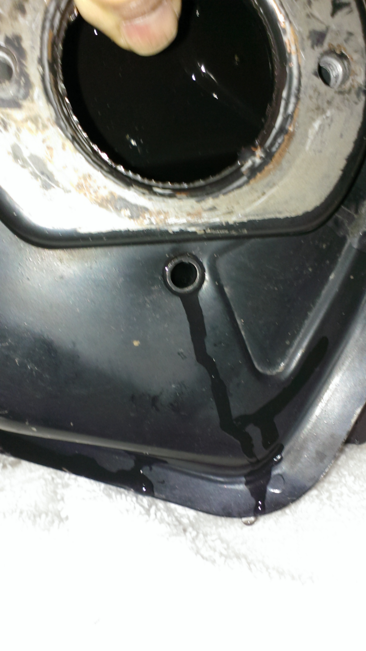

1) After inspecting my TPS adjustment multiple times I found that I was over adjusting it in order to get the switch to operate properly. As a result the stop in the TPS switch was holding the throttle valve slightly open. The throttle valve shaft is worn (wobbles) this caused me to over adjust TPS to get proper function. I removed the TPS and jumped the switch so the throttle valve would be in a closed at idle. It helped but isn't the silver bullet. I plan to get the throttle valve rebuilt. Recommendations ?
2) This one has me scratching my head. Is it possible ? It looks like the manifold box / plenum is leaking where those hollow standoffs are brazed in. Has anybody seen this before ?
Thx
Thx
I've seen 2 liter plenums cracked on the bottom - where its difficult to find the leak.

You can take out the plenum and use a eak penetrant to check for cracks.

Everything is new, injectors / seals, FI harness, and every seal on the intake system. Also, as I stated before I eliminated the AAV and decel valve by disabling (plugged at manifold /plenum).
I have narrowed it down to two items for now. Throttle body leaks, will fixed but not the primary cause. See picture below; I may have found the culprit.
