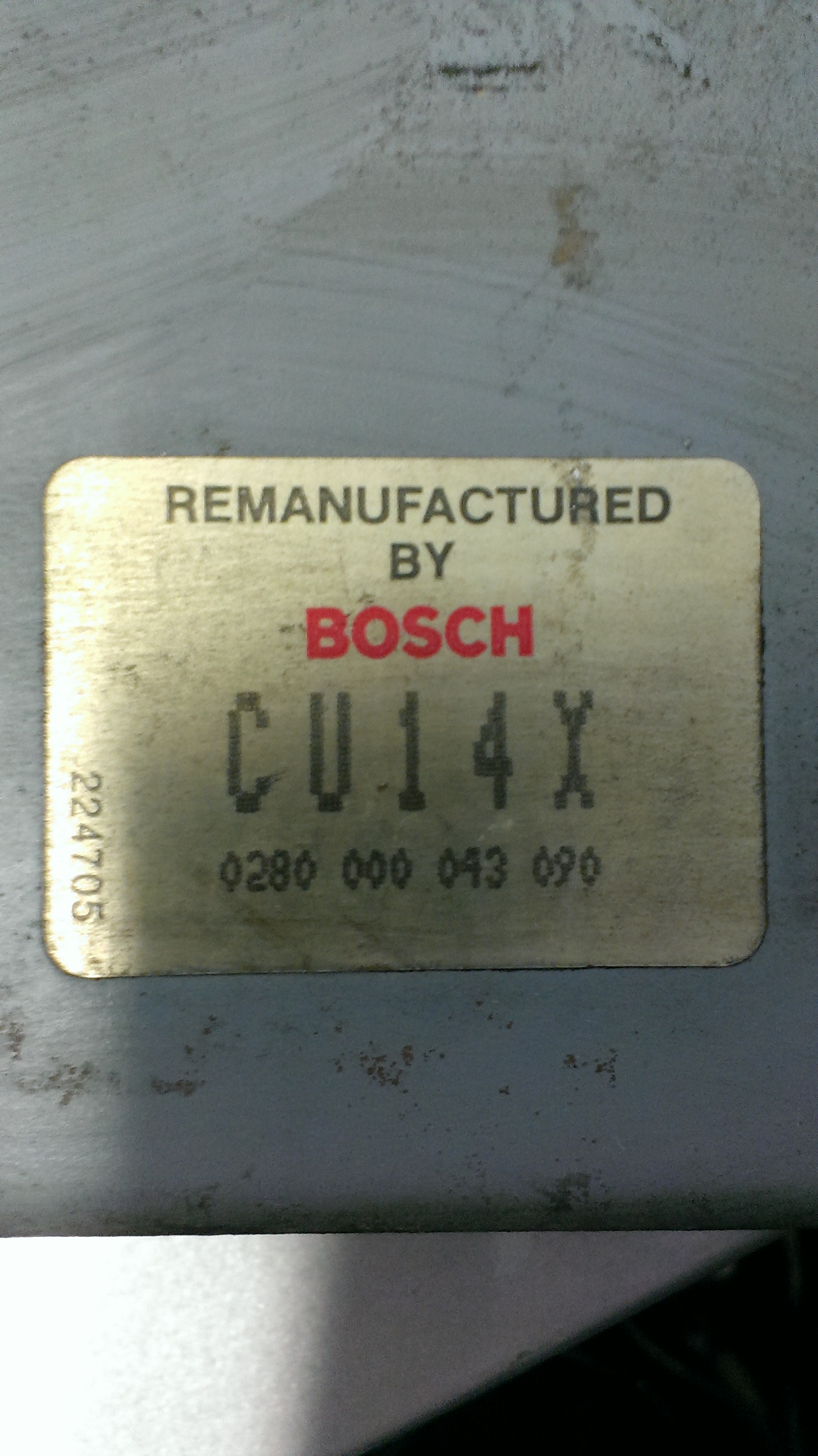

1) Is my ECU P/N correct? The base P/N is correct but not sure what the 090 suffix means.

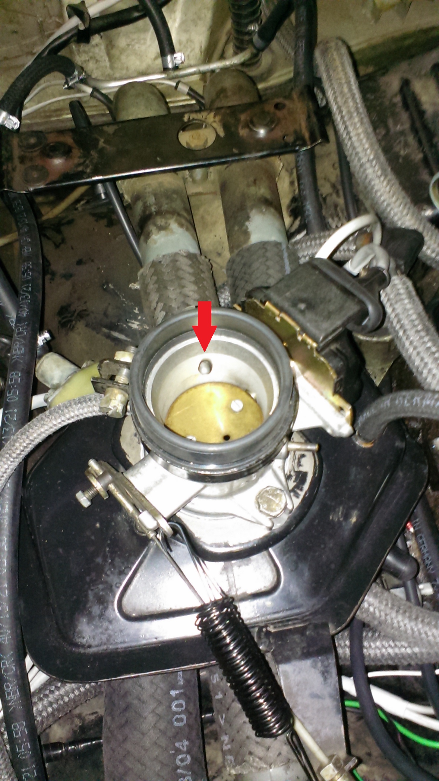

2) With the throttle valve bypass screw turned in full CW there is still vacuum getting past the screw. Does anybody know if that is normal ? I can put my finger over the port and feel vacuum. Maybe by design it is not meant to provide positive shut off but I don't have enough experience to say one way or the other.

It's normal for air to still get through the bypass passage with the screw all the way in.

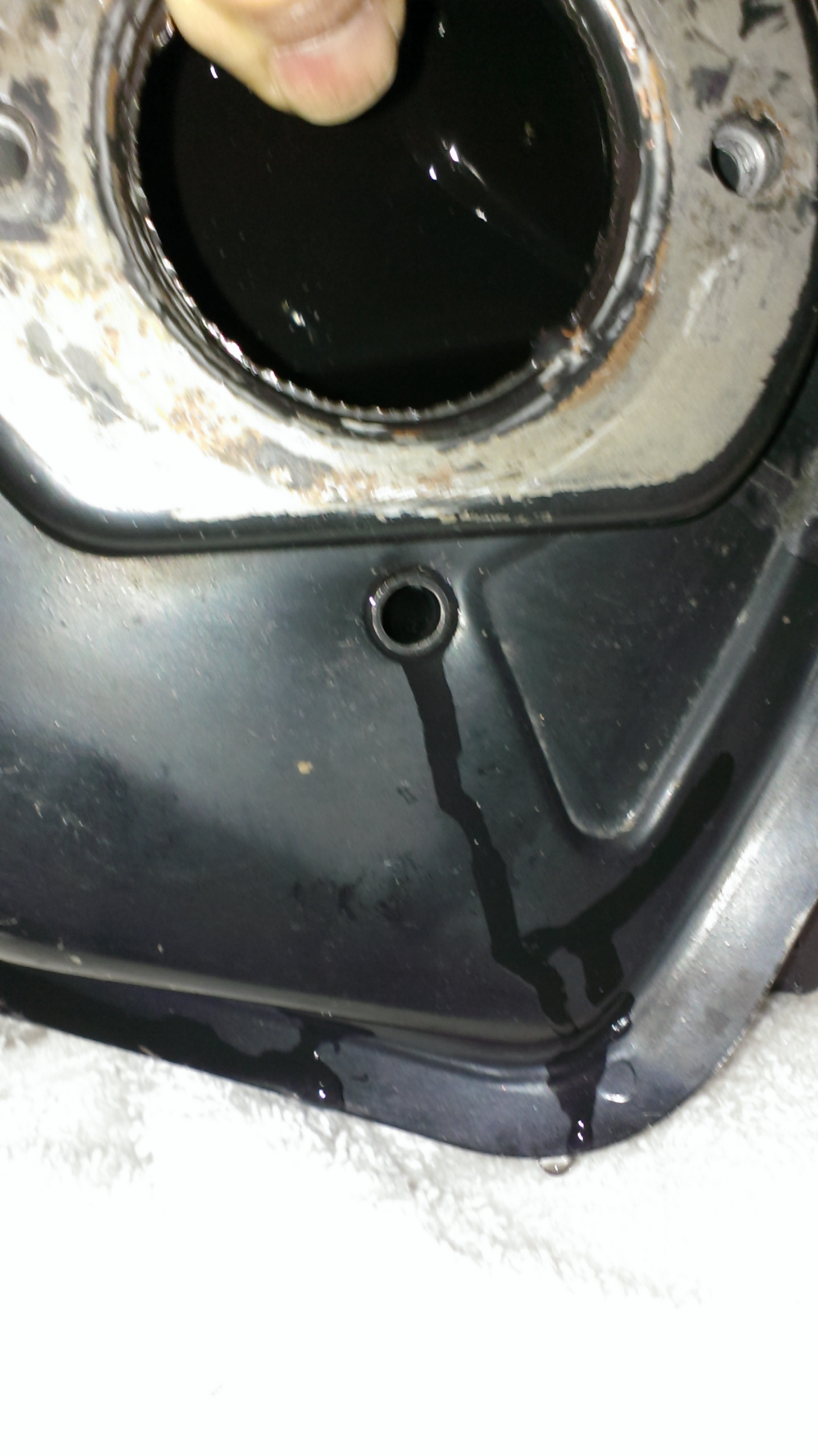

2) This one has me scratching my head. Is it possible ? It looks like the manifold box / plenum is leaking where those hollow standoffs are brazed in. Has anybody seen this before ?

I've seen 2 liter plenums cracked on the bottom - where its difficult to find the leak.
914_teener
May 18 2014, 03:47 PM
You can take out the plenum and use a eak penetrant to check for cracks.

Everything is new, injectors / seals, FI harness, and every seal on the intake system. Also, as I stated before I eliminated the AAV and decel valve by disabling (plugged at manifold /plenum).
I have narrowed it down to two items for now. Throttle body leaks, will fixed but not the primary cause. See picture below; I may have found the culprit.
Click to view attachmentClick to view attachment
