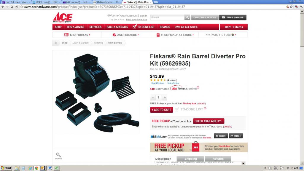

BeatNavy   I was selling some of THIS a few weeks ago. I bou...   Sep 21 2014, 06:24 PM
cary   Grabbed a tape measure before I left.   Sep 21 2014, 06:26 PM
cary   Back from Home Depot. 20 feet. Clamps at McMast...   Sep 22 2014, 09:24 PM
cary   Where did you find the rain barrel stuff? The only...   Sep 23 2014, 04:07 PM
cary   Goggled rain barrel drain tube ............. http...   Sep 24 2014, 07:56 AM
malcolm2   Goggled rain barrel drain tube ............. [ur...   Sep 24 2014, 10:12 AM
BeatNavy   Cary I think it is hit or miss on Home Depot. It...   Sep 24 2014, 08:04 AM
AvalonFal   I used the Home Depot garden tubing on both the fr...   Sep 24 2014, 08:27 AM
