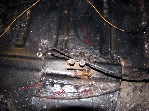

My plan is to fix the small remaining little bits of work; welding e-brake pivot plate, seat belt attachment bolt, center console wiring, recover dash. then I will shoot it with gloss black Plasti-Dip(to preserve until I can afford a quality paint job) and reassemble.

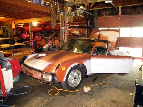

dudzy's914   Pictures.   Jun 10 2014, 06:18 PM
dudzy's914   Pictures   Jun 10 2014, 06:20 PM

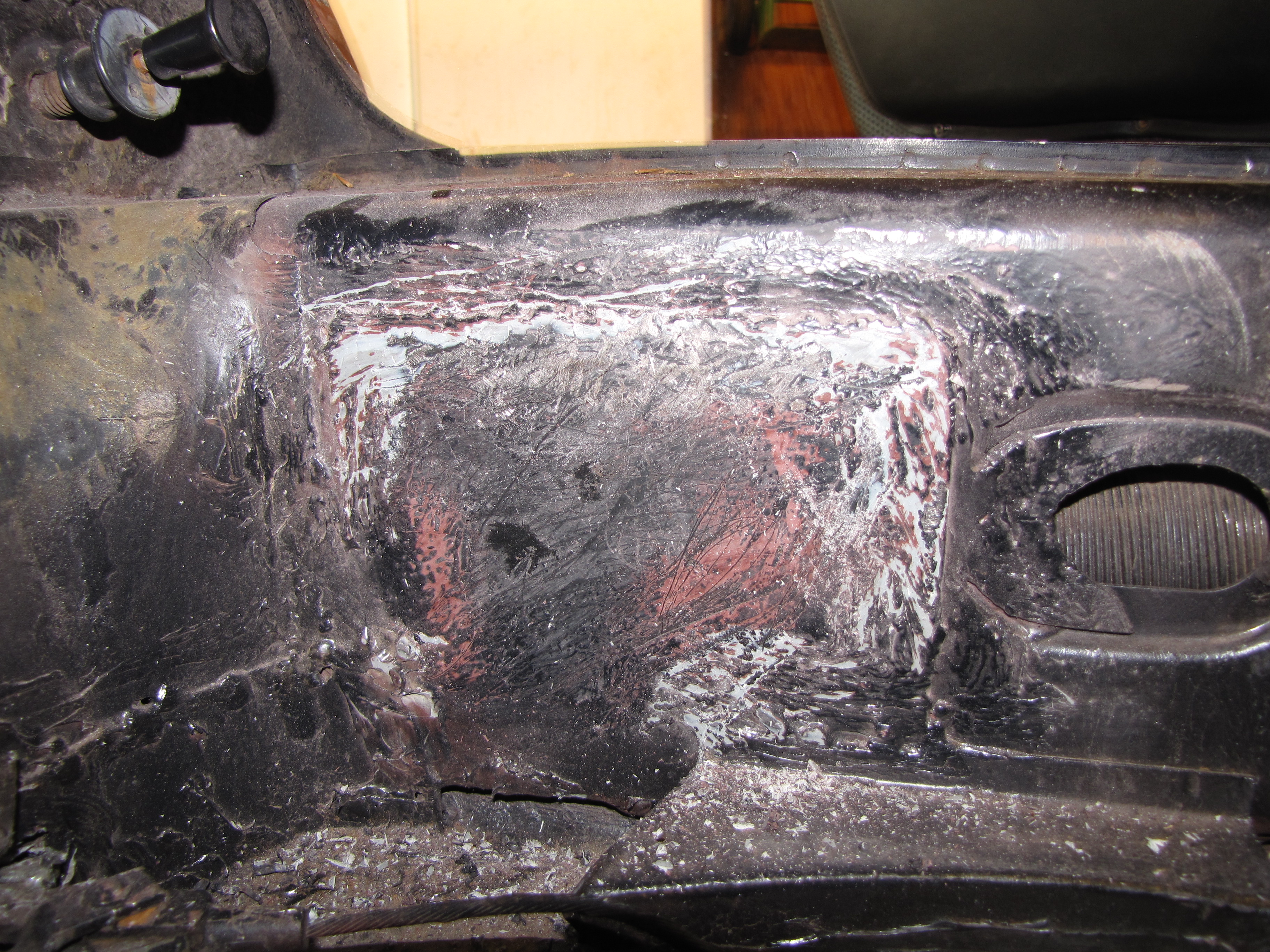

dudzy's914   Had to work inside today, rain. The PO had smeared...   Jun 11 2014, 04:30 PM
Socalandy   :wttc: I worked on cars with my Dad as well. Grea...   Jun 11 2014, 04:37 PM

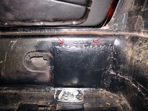

dudzy's914   The hoaky seat belt attachment patch.   Jun 11 2014, 04:37 PM
dudzy's914   Pain in the butt rubbery stuff.   Jun 11 2014, 04:39 PM

dudzy's914   I need your advise.   Jun 11 2014, 09:09 PM
r_towle   Finn, Keep it up, get a grinder and wire wheels a...   Jun 11 2014, 09:21 PM
rnellums   I would suggest getting the seatbelt mounting meta...   Jun 12 2014, 10:12 AM
dudzy's914   I would suggest getting the seatbelt mounting met...   Jun 12 2014, 03:54 PM
Racer Chris   I would suggest getting the seatbelt mounting me...   Jun 12 2014, 07:06 PM
dudzy's914   [quote name='dudzy's914' post='2049423' date=...   Jun 12 2014, 07:24 PM
Racer Chris   The correct threads for seatbelt mounting is 7/16-...   Jun 12 2014, 10:31 AM
dudzy's914   The correct threads for seatbelt mounting is 7/16...   Jun 12 2014, 10:56 AM
