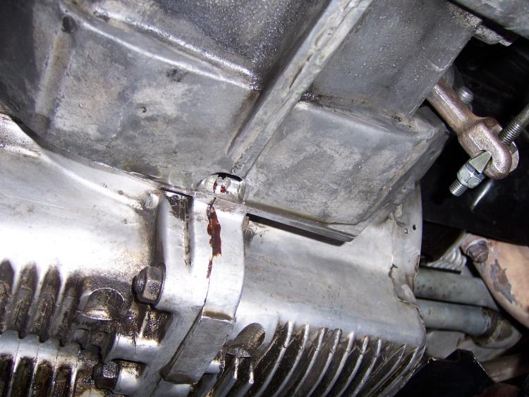

I crawled under the car to check some things out. The major concern was the oil piddles on the ground.
(IMG:http://www.914world.com/bbs2/uploads_offsite/i237.photobucket.com-17475-1403417122.1.jpg)
The engine was mostly dry and the transmission was wet. But that could just mean it was coming back from the engine so after taking the picture I went to cleaning.

Clean it well then let it run whilst parked. Driving down the road will blow the oil back. After it has run a while check again. Common areas are the push tube seals which are cheap and easily replaced; valve cover gaskets, ditto; oil cooler seals; oil pressure sender; oil pressure sender. Both the oil pressure sender and oil cooler are on the right side.

Not (just) the tranny. That engine definitely has leaks. In your first pic it looks like an oil drop about to fall from the boss at the rear of the case on the bottom.
Yes, I suspect push rod tube seals and rear main seal at the least.

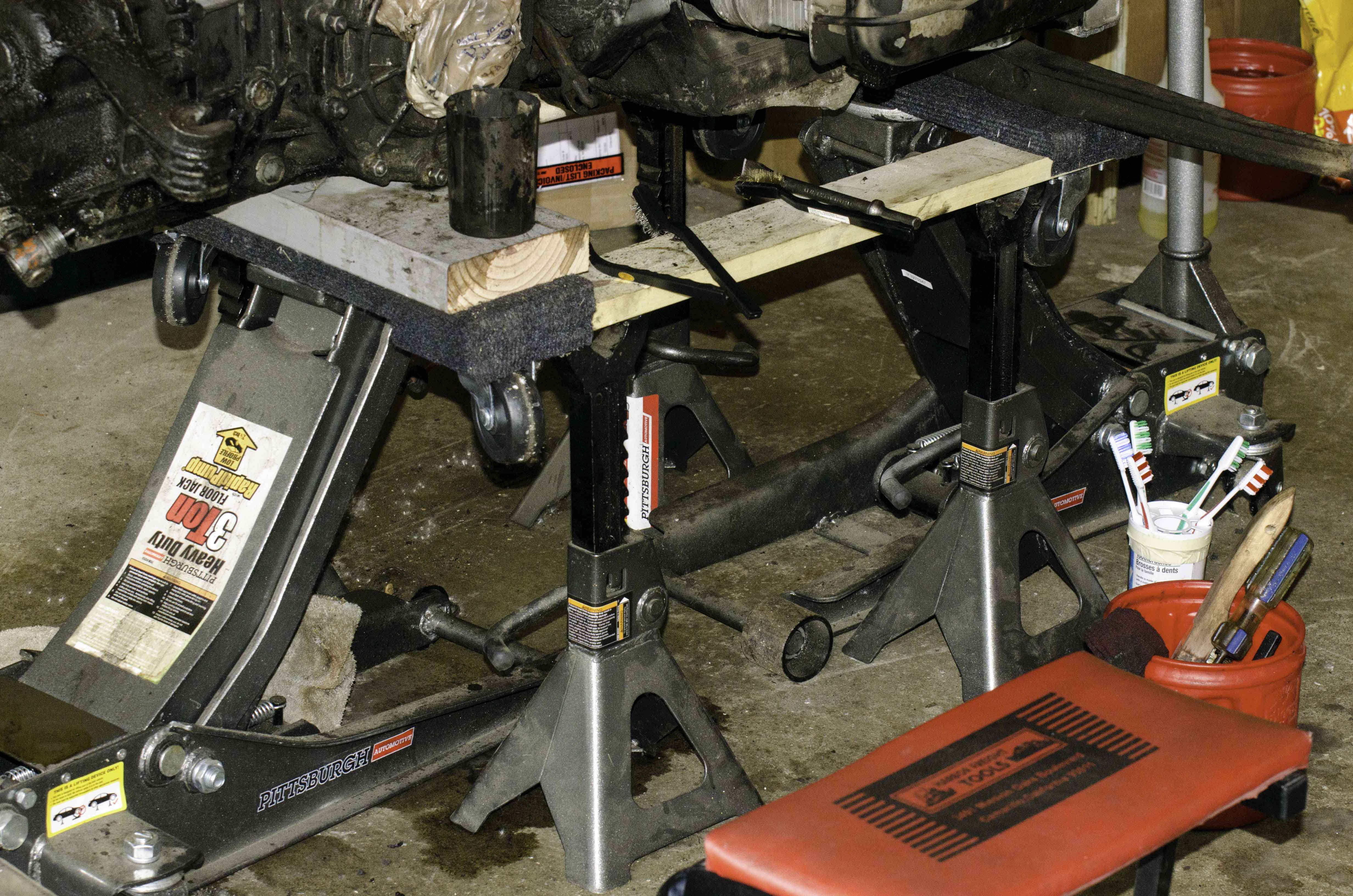

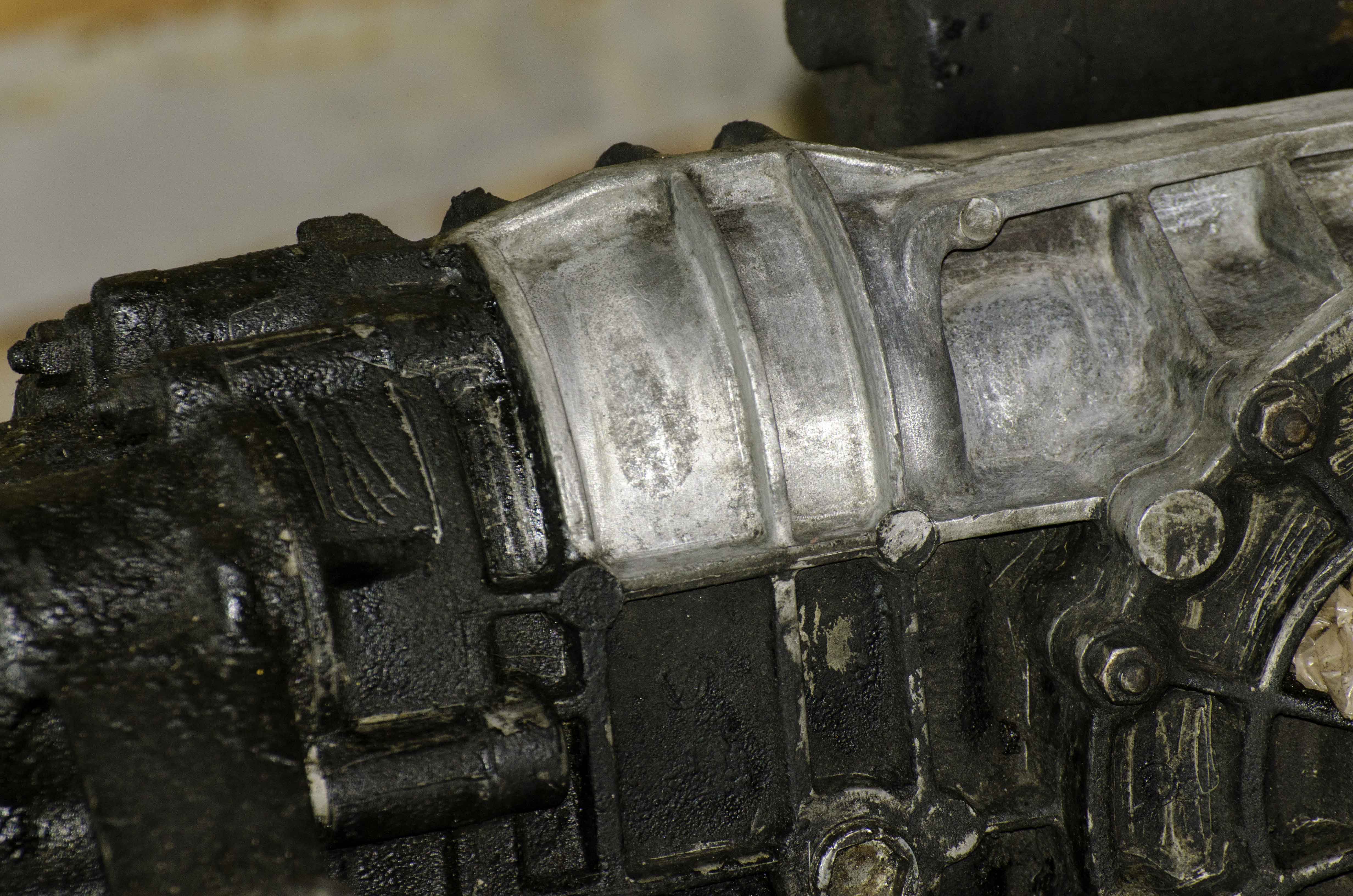

people have posted that they have changed the tube seals without removing the
engine or exhausts. it is tight for a couple of the tubes.
I have chosen to remove the engine to do all the cleaning and seal replacements.
also do the hell hole.
the advice given within the instructions found at pelican parts regarding removing
the engine that I found very helpful, was to have two floor jacks.
as you can see I used the floor jacks to lift my engine and place four stands
for extra safety.. of course each to their own/resources.
I am in the process of cleaning my engine/trans..
it would seem that the tube seals and valve cover gaskets had not been replaced
in many miles.
