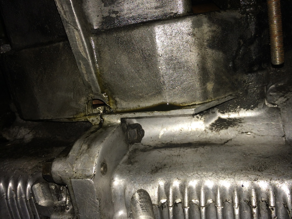

I crawled under the car to check some things out. The major concern was the oil piddles on the ground.
IPB Image
The engine was mostly dry and the transmission was wet. But that could just mean it was coming back from the engine so after taking the picture I went to cleaning.
IPB Image

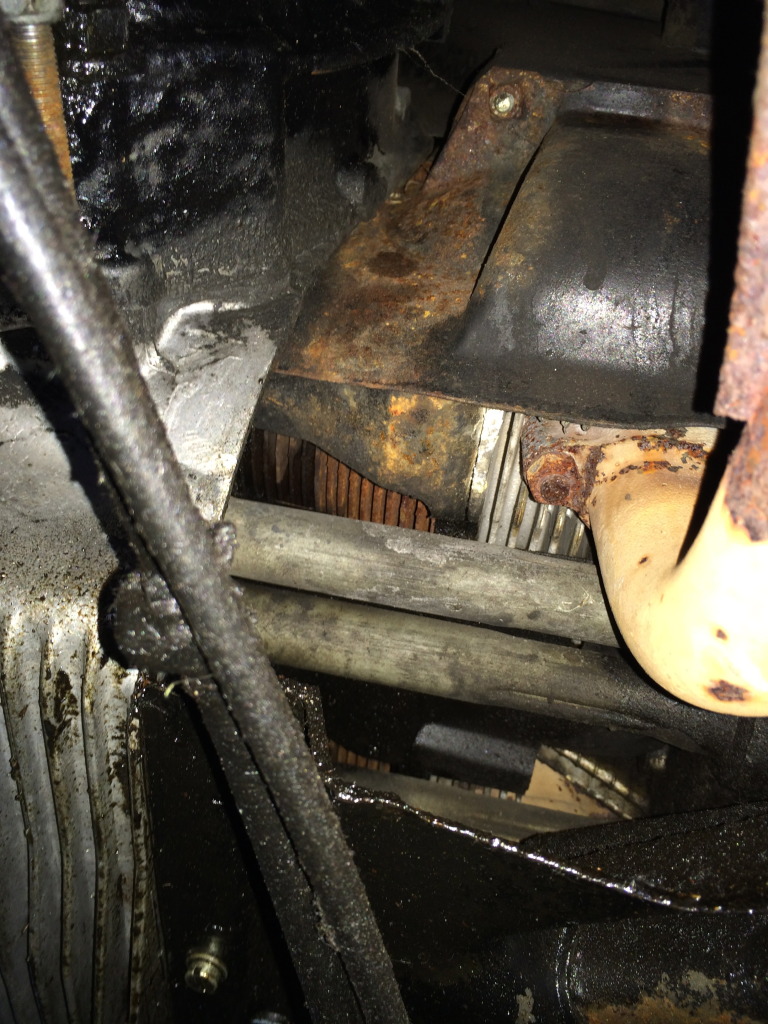

The right bank of engine had some oil on it.
Are transmission leaks common? Maybe the pushrod tubes are leaking?
76-914
Clean it well then let it run whilst parked. Driving down the road will blow the oil back. After it has run a while check again. Common areas are the push tube seals which are cheap and easily replaced; valve cover gaskets, ditto; oil cooler seals; oil pressure sender; oil pressure sender. Both the oil pressure sender and oil cooler are on the right side.
Mike Bellis
My guess is the front main seal. Unless you drive backwards all the time. Then I would guess the rear stack gasket.

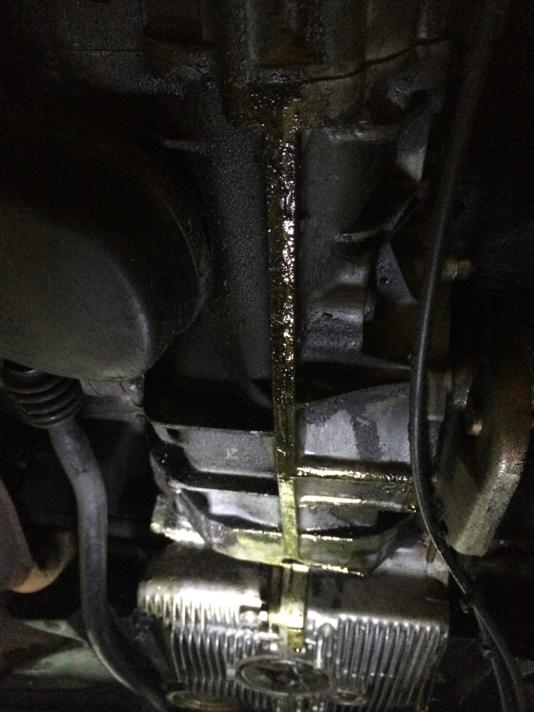

swooshdave
QUOTE(Mike Bellis @ Jun 22 2014, 12:25 PM) *
IPB Image
I think you might be right. Found this weeping at the back of the engine this morning after wiping it clean last night.
Mike Bellis
Pretty easy fix but you have to pull the tranny.

Cary came over and took at look at it. The consensus is the main seal.
Going to drop the motor at some point and do the seal and the pushrods.

Not (just) the tranny. That engine definitely has leaks. In your first pic it looks like an oil drop about to fall from the boss at the rear of the case on the bottom.

rhodyguy
Start the PBblaster routine on your exhaust stud nuts. If the rest are like the one pictured it's going to be a long process. The one we can see is as rusted up as they come. icon8.gif barf.gif

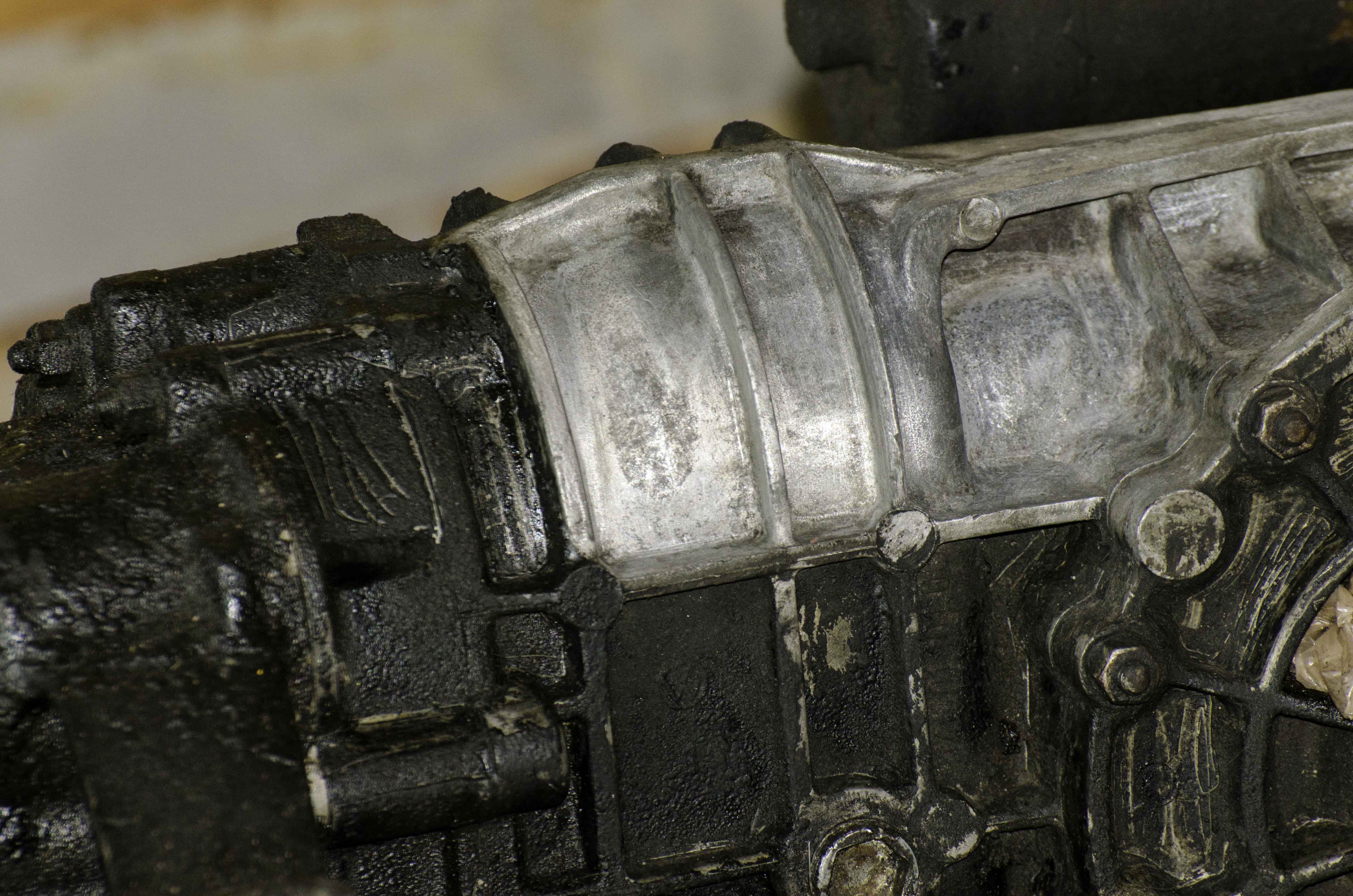

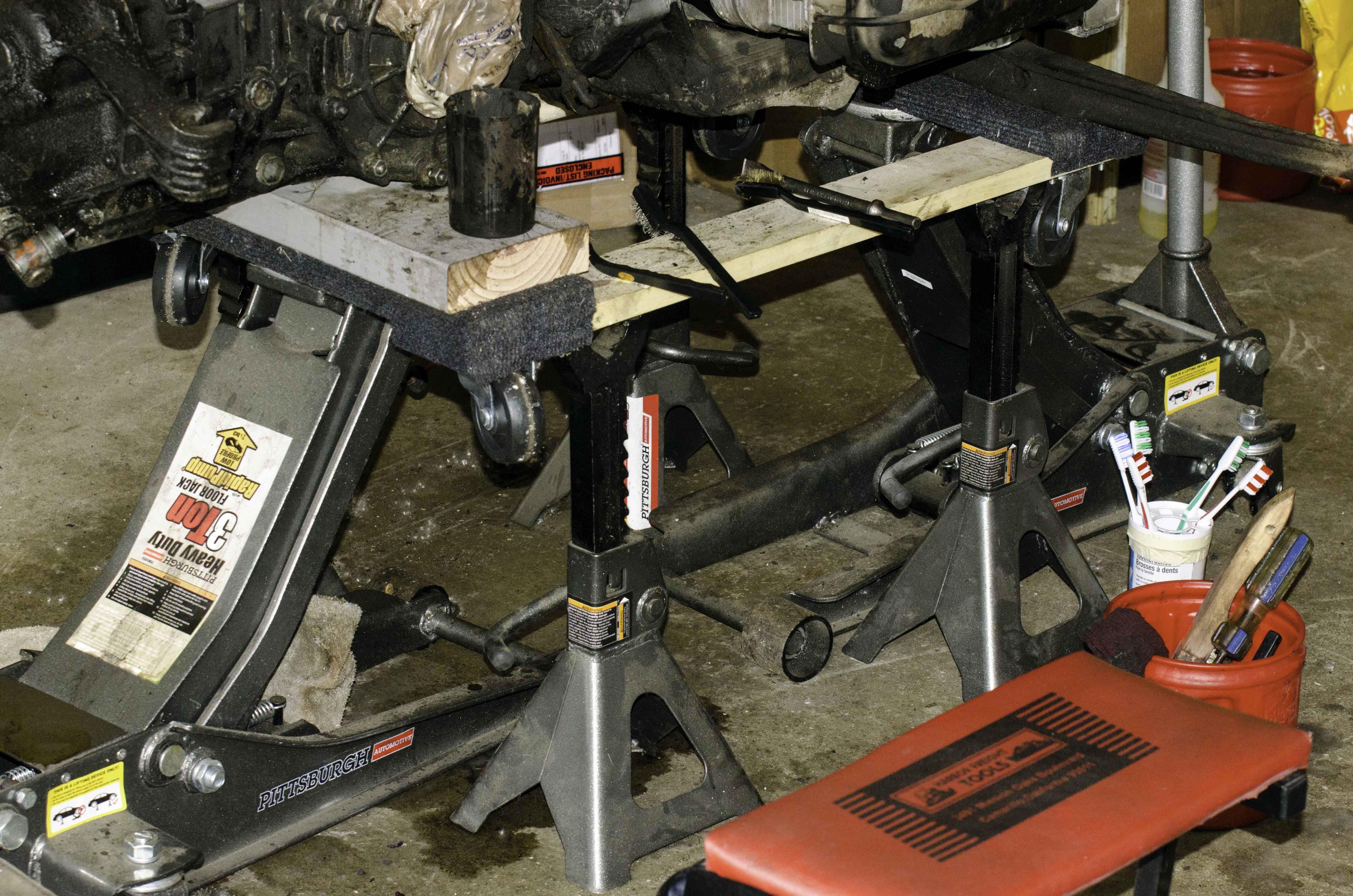

jacksun
people have posted that they have changed the tube seals without removing the
engine or exhausts. it is tight for a couple of the tubes.
I have chosen to remove the engine to do all the cleaning and seal replacements.
also do the hell hole.
the advice given within the instructions found at pelican parts regarding removing
the engine that I found very helpful, was to have two floor jacks.
as you can see I used the floor jacks to lift my engine and place four stands
for extra safety.. of course each to their own/resources.
I am in the process of cleaning my engine/trans..
it would seem that the tube seals and valve cover gaskets had not been replaced
in many miles.
