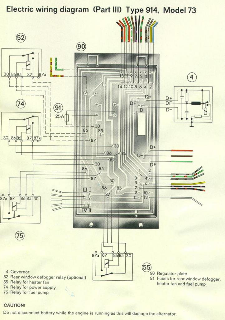

Mblizzard   Fuel pump relay is hanging off the battery tr...   Jun 29 2014, 07:27 PM
timothy_nd28   Just tried to start it and it is still doing the ...   Jun 29 2014, 07:56 PM
timothy_nd28   Ljet is a different animal, the dual relay near th...   Jun 29 2014, 07:33 PM
sixnotfour   flapper stuck closed , push it open and listen for...   Jun 29 2014, 09:24 PM
jmargush   looks like it is the relay I tapped on it a few ti...   Jun 30 2014, 05:39 AM
