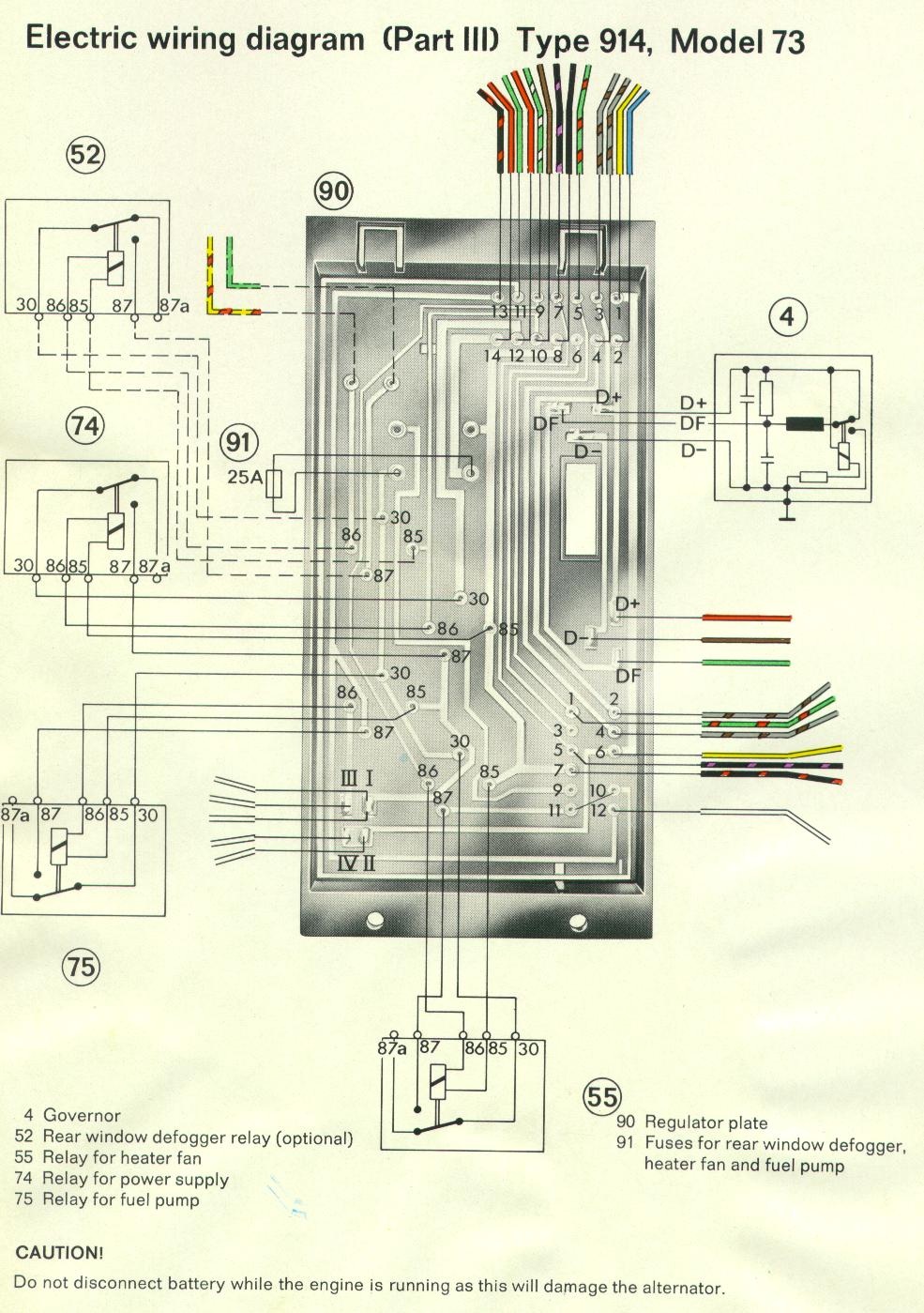

put a meter on the pump contacts and no voltage when I move the flapper in the airbox (key on).
There is voltage when the engine is cranking but as soon as it starts and I let off the starter no voltage.
Does this point to the relay?
Refresh my memory is the pump relay on the relay board in the engine compartment?
Or should I check something else?

Fuel pump relay is hanging off the battery tray. I'd check for loose or unconnected wires there for sure.

QUOTE(motorvated @ Jun 29 2014, 03:07 PM) *
QUOTE(jmargush @ Jun 29 2014, 04:49 PM) *
I don't think the fuel pump relay is located on the battery tray? It is located in the control board on the drivers side isn't it?
timothy_nd28
Ljet is a different animal, the dual relay near the battery tray runs the fuel pump.

I think you are on the right track. If you manually deflected the AFM flap, and no fuel pump action with the key on, could be one of three things. Start by testing the continuity of pins 36 and 39 at the AFMs connector. You should see 0 ohms with the flap deflected and infinite ohms when the AFMs flap is at rest. Start with this test, and report back.
