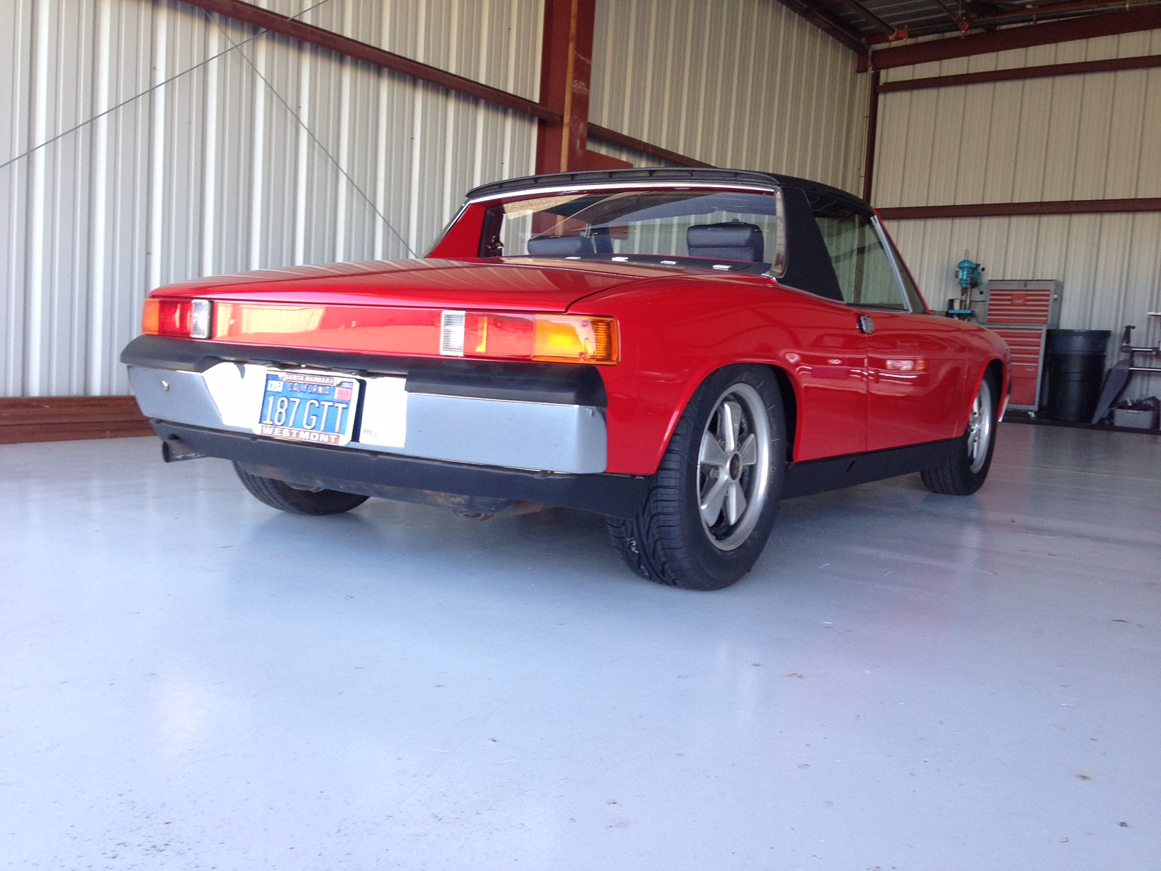

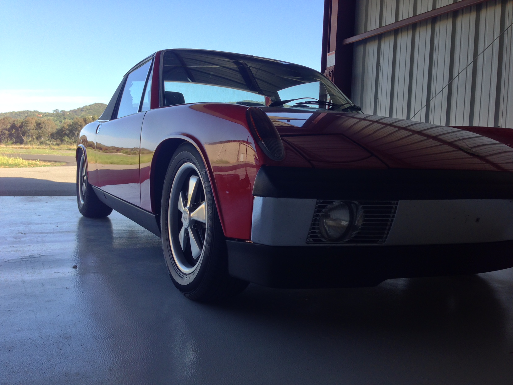

Where I started back in 2006~: A set of old, hard Yokohama AVS ES100s in 205/55R15 that needed to be replaced. This was a tire size I fell in love with on the 914 when I could get BFG Comp T/A3s in it. I disliked the ES100s, both on this 914 and on a Subaru WRX. I know a lot of people like them, but I found the sidewalls unyielding and the squared shoulders foreboding as I approached the limit of adhesion.
Didn't miss them when I got rid of them from a performance/feedback standpoint, and wanted a taller, period-correct tire. Still one of my favorite tire sizes on a narrow 914, however.
