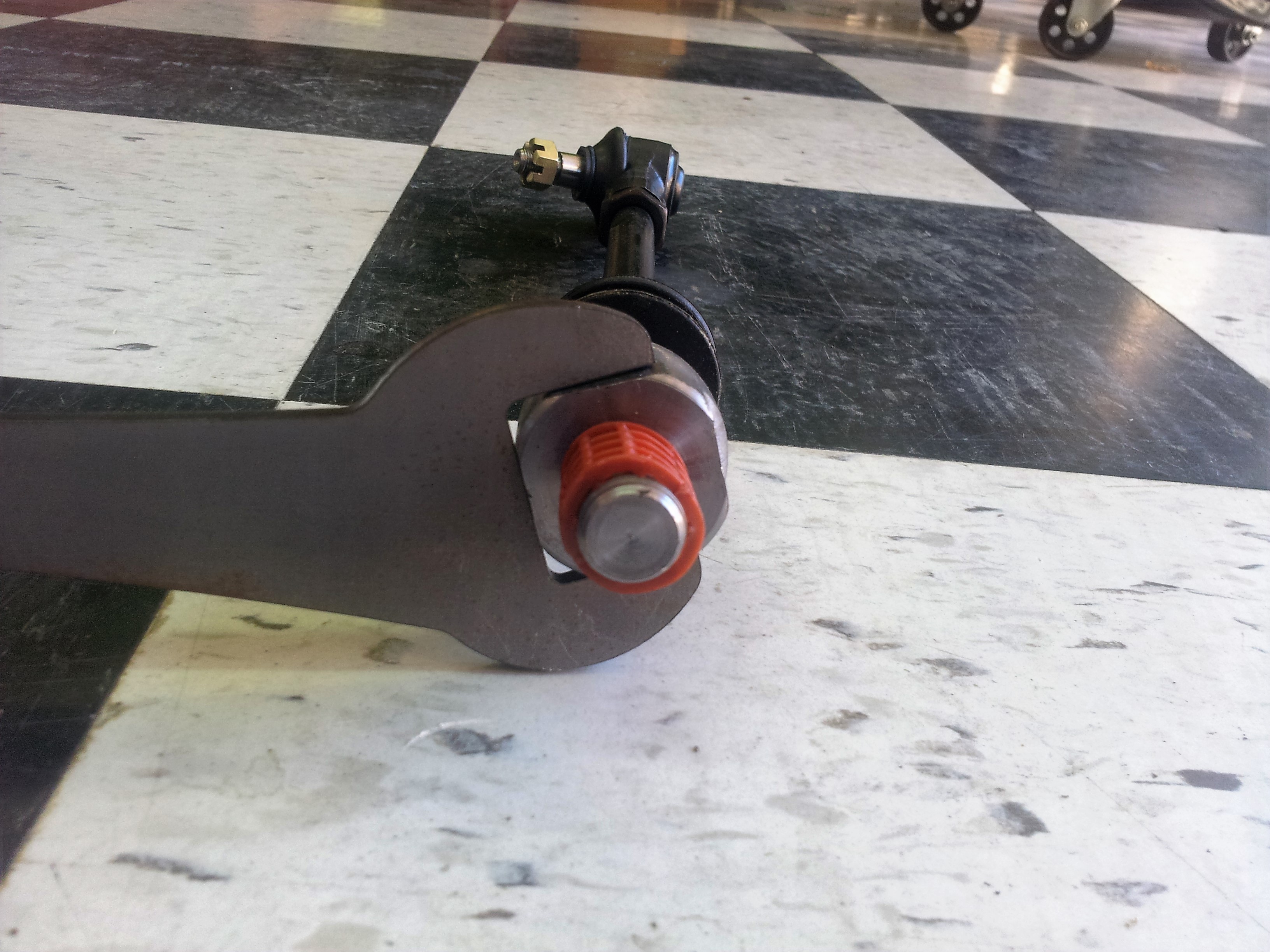

QUOTE(Eric_Shea @ Sep 29 2016, 12:50 PM) *
Has anyone used this?
We just tried it out on a customer car in the shop... too big for turbo tie rod ends. Doesn't work. (IMG:style_emoticons/default/sad.gif)
(not sure if the TT's on this car are Lemforder or not but, they measure 32mm and the wrench is 34mm)

Not seeing it discussed that this wrench is cut to the wrong size. Jeff seems to have cleared that up. Our Turbo ends measured 32mm. This wrench is 34mm.

I think you might be missing my point Mark.
I'm not concerned with stock tie rod size on one end vs. TT on the other... The problem is with the TT end of this wrench. My wrench from Doug measures 34mm on the TT end (as I would suspect all of these wrenches do) and the actual TT measures 32mm. If this is correct, all of these wrenches are wrong. (IMG:style_emoticons/default/sad.gif)
It's possible mine was cut wrong... can those of you who can find their wrenches measure them and weigh in?

Eric is correct on the 32 mm . I have 2 sets of Lemforder turbo tie rods and both sets measure 32 mm. Mark has a wrench that he measured for me before I purchased it. His was 36 mm so obviously it will not work for my use.

I think I got your point, Eric.
Apparently the TTRs have a smaller inboard nut than the stock TRs as you pointed out, so I'll take it that the wrenches we purchased are only for busting lose the stock TRs.
I haven't had the opportunity to physically tackle the project so I can't speak from real-world experience, nor have I measured the wrench size (heck, can't even find the darn thing) and my TTRs are currently in AZ.
I read what Doug posted, purchased one and thought I was good to go ... now I guess not, and will need to source a thin 32mm wrench, right?

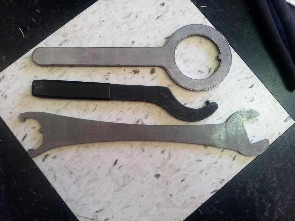

If you are a cyclist like a lot of us here; I used my spanner. I actually distorted dlee's version and had this type in my bike tool collection to put on the turbo tie rods.

I used one side of the wrench to loosen the original tie rods and a BMW fan clutch wrench (32mm) to put the new turbo ones on. The BMW wrench is just a glorified bike wrench and was around $12 (IMG:style_emoticons/default/beerchug.gif)

Check Jeff's post. Stock is 46mm, TT is 32mm. This wrench appears to be neither.

I went through this last year.
I borrowed one from Jim Hoyland.
I didn't use it.
The inboard stock nut against the rack was difficult to use inside the fender well and I used a pipe wrench to crack the thread retaining washer that has the recess for the stock boot.
The other end didn't fit- wrong size for the Lemforder TT.
I figured I could use the pipe wrench on the stock retainers because I wasn't going to use them anyway once the TT rods went on.
Think if the other end were bent at an angle and the rectangular end fit the Lemforders it would be ok.
My .02

I tested mine up against a Turbo Tie Rod end - these are pretty old (though never installed) and in a clear bag - maybe URO.
Seemed to fit fine.
While we are on it - what are the other wrenches I have so I can write what they are in Sharpie?
I think one fits the washer in the front trunk for the strut. Maybe same for the nut on the strut tube.

I found a problem with the "E"-shaped end of the wrench in that it didn't fit when I was installing my TT ends. It was too shallow to reach around to the 12 and 6 positions with the tang at 3 0'clock engaged.

Jeff - I can't put my hands on my digital caliper but I measured on two different scales and I swear it looks like 33mm...
I have a 32mm open end wrench and it is a tad larger than the 32mm. My 32mm open fits the tie rod perfect.

Turbo tie rods require a 32mm wrench, I have install lots of them over the years and I don't even own a 34mm wrench. The 32mm wrench I use I had to grind it to make it thinner, to about 5mm.
