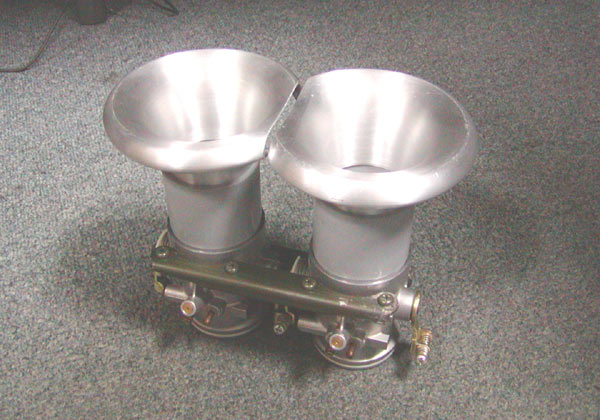

A little bit more progress....
I only have the one length velocity stack to t/b adapter tubes but it wouldn't be that hard to make a few different lengths.
You can see the overlap that I had to deal with, these are not as pretty as they should be, I screwed up and removed about .100" too much from one...no big deal, I'll figure something out (IMG:style_emoticons/default/smash.gif)
Still struggling with the aircleaner choice, I'll have a better idea once I mock these up on the motor in the car for a clearance check.

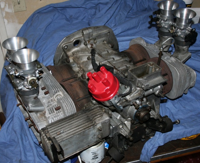

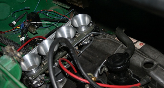

Mueller
post Nov 5 2006, 10:21 PM
Post #108
914 Freak!
Posts: 17,157
Joined: 4-January 03
From: Antioch, CA
Member No.: 87
finally worked on them again...all 4 manifolds are machined...now to tackle the linkage and the air cleaners...

if you didn't notice, I modified the air-horns...makes the install a little nicer and simpler without the overhang of the original ones...hope you don't mind too much Paul (IMG:style_emoticons/default/biggrin.gif)

spunone
post Nov 6 2006, 02:22 PM
Post #113
Posts: 945
Joined: 6-April 04
From: Anaheim CA
Member No.: 1,901
Mike you Hack what did you do to the stacks???? (IMG:style_emoticons/default/chairfall.gif) If ya need a different type let me know ie taller or shorter bigger or smaller.They look great and great job trimming down that can be alittle tricky. (IMG:style_emoticons/default/thumb3d.gif) CYA

QUOTE(spunone @ Nov 6 2006, 12:22 PM) *
I thought you'd get a kick out of it, hahaha
For trimming them down I made a holder for the base and a large diameter bull nose live center..worked like a charm, took a few minutes per stack...
for machining the manifolds, I got that down to less than 15 minutes per manifold...the setup was a PITA...I'd make a fixture if I was going to do them again which I don't plan on (IMG:style_emoticons/default/smile.gif)
great thing about the CNC is that you can walk away while it's working and do something else.....
I saw the stacks I'm guessing you made for Jake for those aircleaners??....pretty slick and tempting to duplicate (for personal use only Jake (IMG:style_emoticons/default/smile.gif) )
