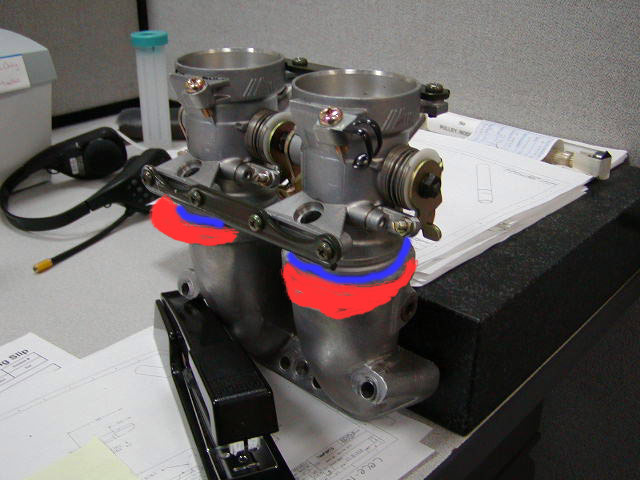

been a while since I've touched these parts...so this weekend* I'll be machining the manifolds by removing the material in red and cutting 2 pockets for the T/Bs to slip/rest into
once placed inside, I shall weld the T/Bs to the manifold, only negative things I can think of is that due to the manifold design, long studs will have to be used and installation of the T/B-manifold assembly to a motor already in the car might be a PITA
*(unless someone can give me a good proven reason not to (IMG:http://www.914world.com/bbs2/html/emoticons/smile.gif) )

why weld them on? bolt on or clamp on would be THE hot tip....

I have heard that the original motorcycle mounting is the same bolt spacing as an IDF? I mate has used a set of Suzuki Hyabusa bodies on his Alfa 2.0ltr powered sports car with great success.
Mueller
post Mar 24 2006, 04:52 PM
Post #60
914 Freak!
Posts: 17,157
Joined: 4-January 03
From: Antioch, CA
Member No.: 87
QUOTE(Aaron Cox @ Mar 24 2006, 02:50 PM)
no real reason for bolt-on or clamp on....usually attachment methods like that are for "universal" or more than one type of application (the manifold accepts a weber, a dell(?) or off the shelf throttle bodies such as Jenvey or TWM's)
doing it this way will just means that this assembly will only work with a Type IV motor (1.7/1.8 or 2.0 heads)
The TB's shouldn't need to be removed from the manifold, wrong size TB?? Well, sell these and buy new ones...manifolds are $50 to $80 per pair, not that big of a deal....
Even "if" the TB's need rebuilding down the line, they can still be taken apart..........
