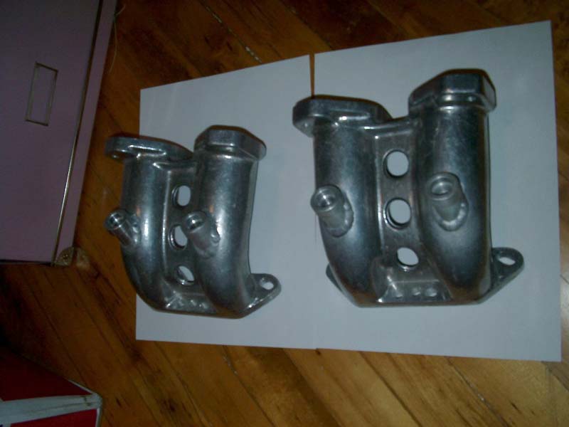

mike, surely those manifolds have what looks like the bosses for the 4 stud 1.7/1.8 heads. You just have to drill them.

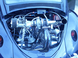

Found an engineer/fabricator in Alviso, maybe time for lunch again...
Check out his turboed bug:
2110 Turbo VW engine
New fully prep VW race case
Cima Pistons
Straight cut gears
MSD Ignition
Forged 82mm stroker crank
T3 RayJay Turbo Charger
Bugpack Stroker Rods
Street Eliminator Heads 42X37
Camshaft 298X515
Kennedy 2500lb clutch W/4 puc Feramic disc
Large Oil Cooler
Doghouse Fan Shroud
Horsepower 300 @ 18 psi boost
42mm Dellorto side draft

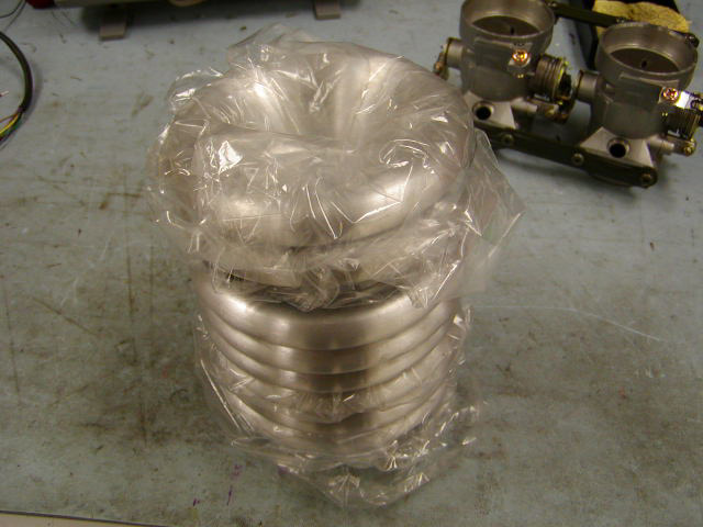

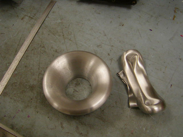

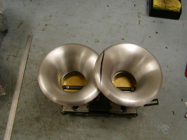

A big thank you to non-member SpunOne (IMG:style_emoticons/default/pray.gif)
He made these spun aluminum velocity stacks for my throttle bodies...
As you can see there is some overlap which is okay, I'll mill off the offending material and butt weld the 2 together. For my applications, I doubt I'd be able to tell or notice any negative effects from doing this.
Oh yea....one stack tried to "escape"...and got "squished" underneath my Hyundia (IMG:style_emoticons/default/alfred.gif) ...luckly Paul made 9 (IMG:style_emoticons/default/blink.gif)

QUOTE(thesey914 @ Apr 3 2006, 12:48 PM) *
That's what I thought , too. Just like the CB Performance manifolds that Andy shows in his photo. Those work with both three and four bolt heads. (IMG:style_emoticons/default/idea.gif)

QUOTE(maf914 @ Apr 19 2006, 01:03 PM) *
there was an aluminum plug that popped right out with a little (IMG:style_emoticons/default/smash.gif)

Umm. Mike, you used a some rair Solex manifolds.
Looks cool. How many hours are in it right now?
B

QUOTE(Brad Roberts @ Apr 19 2006, 01:10 PM) *
Umm. Mike, you used a some rare Solex manifolds.
really?? oh well, I didn't pay much for them (IMG:style_emoticons/default/smile.gif)

michel richard
post Apr 19 2006, 03:35 PM
Post #100
Posts: 1,291
Joined: 22-July 03
From: Longueuil, Québec
Member No.: 936
overlapping stacks are very cool. Some 356 had them.
