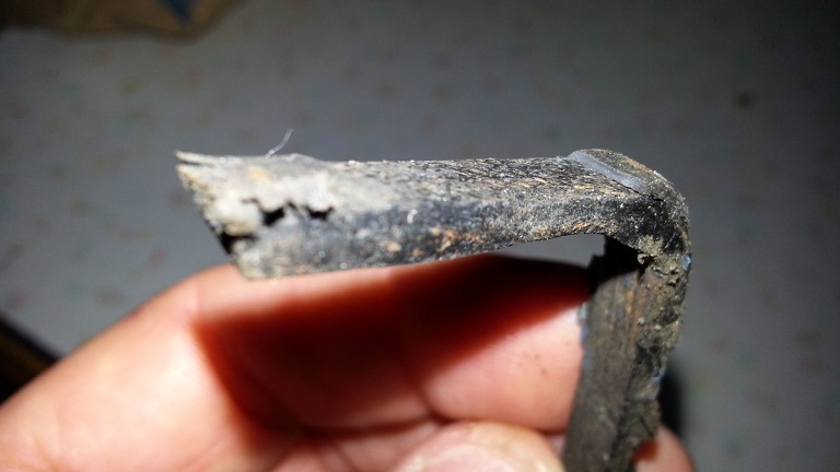

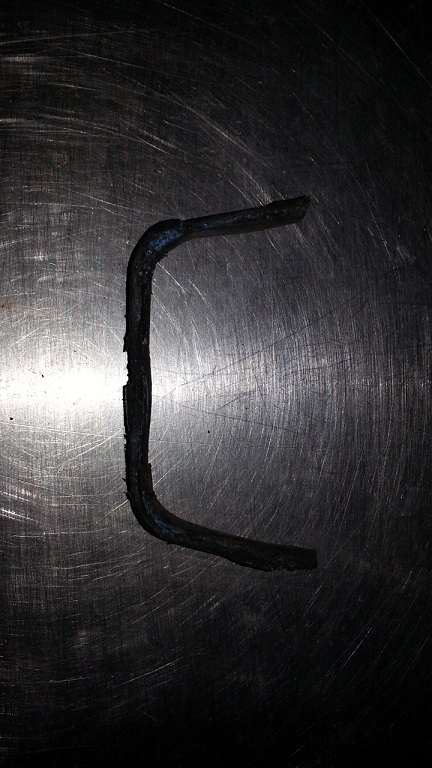

I pulled the engine to replace the oil pump cover .... drip, drip, drip.
But this gasket came apart when I pulled the heater tin.
It goes inside heater tin that attaches to blower housing. #24. Keeps moisture from getting inside the heating system I assume.
Dug thru both AA and Pelican and found nothing. Made an attempt at Bus Depot but I have no idea what its called or the part number. I know that I replaced them around 7-8 years ago.

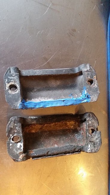

post Sep 21 2014, 09:45 AM
Posts: 3,900
Joined: 26-January 04
From: Sherwood Oregon
Member No.: 1,608
Here's what I finally did. It's been curing since July. As you can see I only filled in the missed section. Should work.
