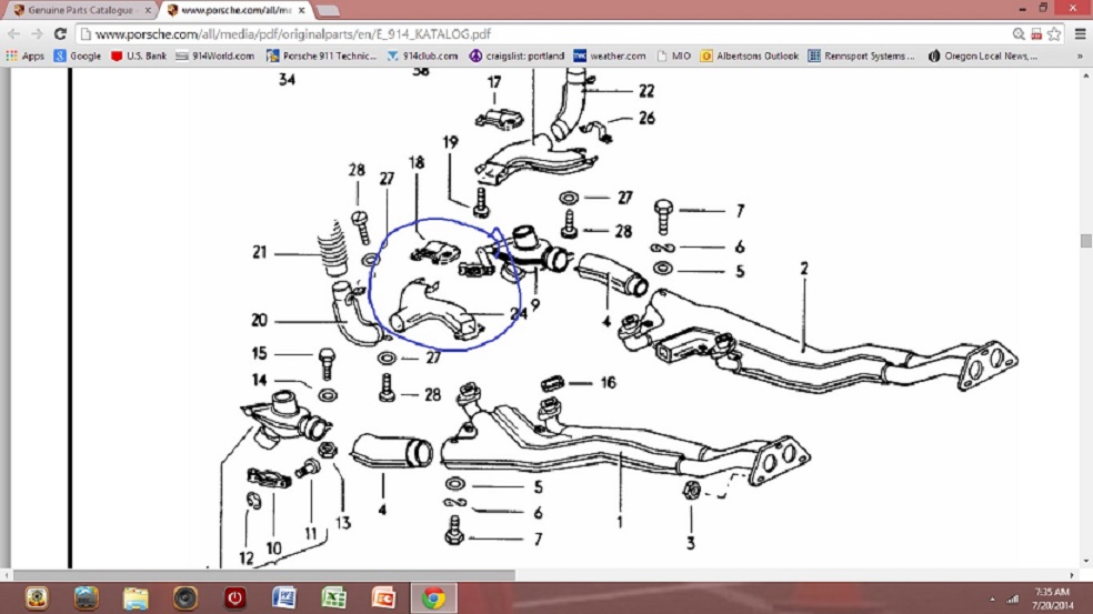

I pulled the engine to replace the oil pump cover .... drip, drip, drip.

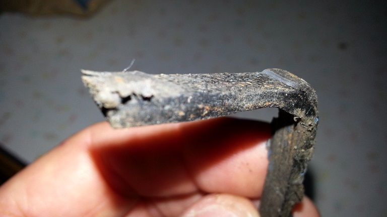

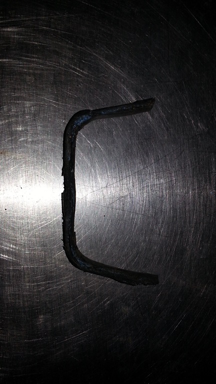

But this gasket came apart when I pulled the heater tin.
Click to view attachmentClick to view attachmentIt goes inside heater tin that attaches to blower housing. #24. Keeps moisture from getting inside the heating system I assume.
Click to view attachmentDug thru both AA and Pelican and found nothing. Made an attempt at Bus Depot but I have no idea what its called or the part number. I know that I replaced them around 7-8 years ago.

I think what you're looking for is called a "branch piece gasket" by AA. From the PET 202-15, no figure number as it doesn't seem to appear in the figure,
021.256.325 A gasket for cover and
021.256.326 A "
here is the part in AA:
skip this linkhttp://www.autoatlanta.com/results.phpif the link doesn't show the part, search the AA catalog for 021.256.325A (and don't search for 021.256.325 A, notice the space before the "A")
and the link above doesn't get to the part. Try
http://www.autoatlanta.com/porsche-parts/h...;section=202-15and scroll down, the gaskets are in the parts list after 18 and (18) ...

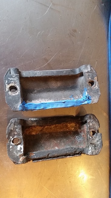

cary
Sep 21 2014, 09:45 AM
Here's what I finally did. It's been curing since July. As you can see I only filled in the missed section. Should work.
