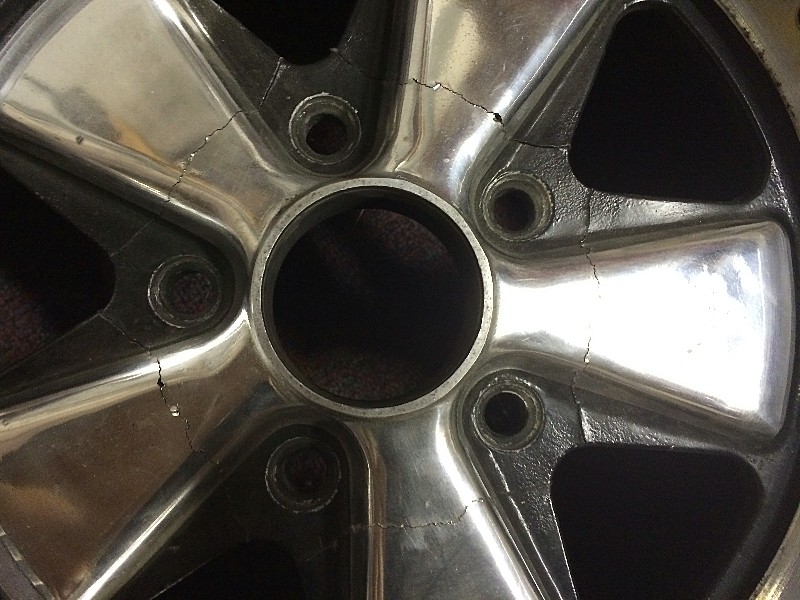

Buy a new one. Forged wheels have a specific grain structure from the high impact forging process. Welding it will melt the metal and, at a minimum, change the forged grain structure into something weaker.
Not sure if the Fuchs are preciptation hardened to get the strength up (T4, T6) but if they are, applying heat will knock them down to T0 - which is dead soft and easily bent.

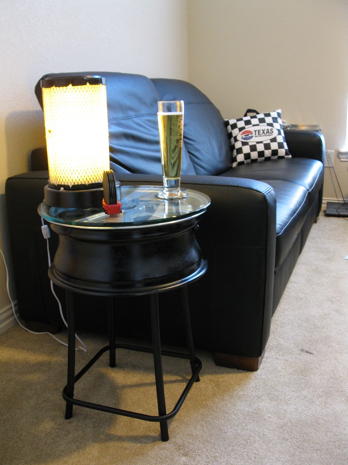

Here is what we did with the nicely polished one that cracked:
It now resides in our 914 themed den.
The light is made with an early 911 air filter for a shade. The beer glass is from the PCA Parade in 2004 in Fort Worth, and the coasters are miniature brake rotors in a caliper for a holder.

This just points out for people to check your wheels regularly. A Forge Wheel should be the strongest wheel out there - much stronger than Cast Wheels and much Stronger than the aftermarket (for the most part) wheels.
As much as I think they are the best looking wheel for a 914-6, I would never put a set of the Mahle Gas-Burners on a car. They were the Lightest Wheel ever put on a Porsche due to their Magnesium construction. However Mag gets brittle as it gets older (one of the "new" problems of older 911 Engines), developes cracks & break

Good thing you found it now or this could have happened... Found while at speed...on a racetrack....a friend was driving Huey and thought a tire was going down!
YES, check your wheels!!

larryg - don't mess with it. Buy a new one, not worth the consequences.

Actually very good point. No it was not...so another word of warning, DO NOT use wheels made in China for track use.
If you think about it, the stress that gets put on the wheels is enourmous, so age, weather, 'spirited' driving/autocross/track, temperature changes, etc. all contribute to wear down our wheels, just like any other metal or item on our 40+ year old cars.

Clay, your table rocks. (IMG:style_emoticons/default/aktion035.gif) Could you give some details of how you made it? If one of my wheels should happen to have a crack in it...

Buy a wooden top stool from IKEA. Shorten the legs about 4 inches so that the top of the wheel is a little lower than the arm of the couch. Throw the wooden blocks for the stool top away. Go to the hardware store and buy nuts and washers to fit the stock steel lug bolts. Center the wheel on the stool and drill the 4 holes for the lug bolts. Deburr the holes, then paint the top of the stool with a very thick coat of silver paint. Wait for it to partially dry, then take a paint brush and wipe the top of the stool in a circular motion. This will make the metal top of the stool look like a used brake rotor. Paint the tire mounting surface black and bolt the rim on the stool. Then get a 17 inch circular piece of glass and some silicone rubber disks to stick to the rim to insulate the glass. The center cap hole is filled by a 356 emblem that was no longer usable, but you can put whatever you want in there.

Thanks for the great writeup. It almost makes me hope I find a bad one. Almost.
