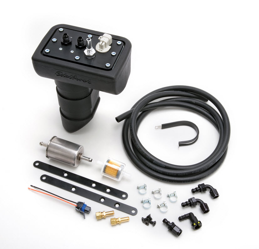

expensive but here is one to use almost out of the box..

QUOTE(d914 @ Aug 16 2014, 01:06 PM) *
ok, so is that a fuel accumulator?? where do you put it? Upstream or downstream from the existing fuel pump? It works with fuel injected set ups, yah?
the pic came thru but not the source....
thanks
td
d914
post Aug 18 2014, 06:12 PM
Posts: 2,349
Joined: 12-July 03
From: Atlanta, ga
Member No.: 904
low pressure from the gas tank.. high pressure to the fuel rails.. edelebrock, for use with their superchargers..
