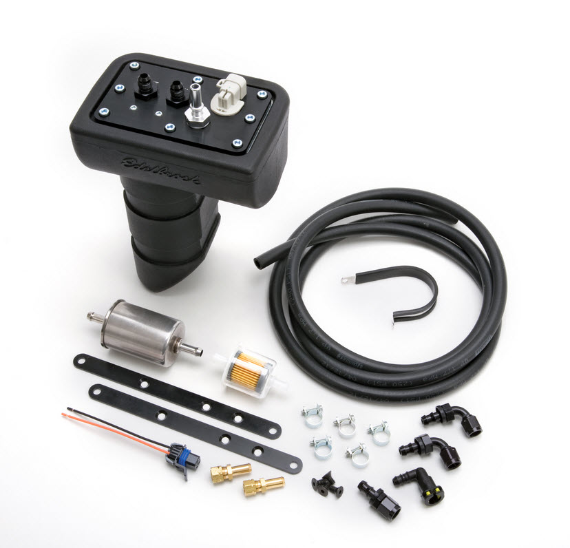

expensive but here is one to use almost out of the box..

QUOTE(d914 @ Aug 16 2014, 01:06 PM) *
ok, so is that a fuel accumulator?? where do you put it? Upstream or downstream from the existing fuel pump? It works with fuel injected set ups, yah?

d914
low pressure from the gas tank.. high pressure to the fuel rails.. edelebrock, for use with their superchargers..

ChrisFoley
QUOTE(tadink @ Aug 18 2014, 06:49 PM) *
A fuel accumulator is a small tank (1 quart or more) fed by a low pressure pump drawing from the tank, with a return line that goes back to the tank.
The return fitting is at the top of the tank so it stays filled at all times.
The primary fuel injection system draws fuel from the bottom of the accumulator and returns the excess back to the accumulator.
That way the high pressure FI system never sucks air unless the fuel tank is totally empty.
