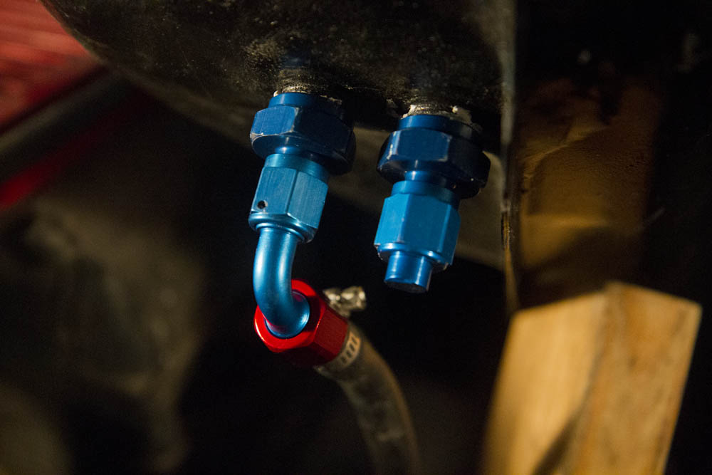

I successfully found adapters that will fit on our fuel tanks, just wanted to share. No need to drill tap the tank - these fittings go on the existing threads. You can go to -6 or -8 AN. They come with an internal o-ring but I added thread sealant just for extra protection.
http://www.cbperformance.com/ProductDetail...roductCode=3288
http://www.cbperformance.com/ProductDetail...roductCode=3289
I plugged one with a cap and the other with a 90 degree AN to hose barb fitting if you don't want to use AN hose.

I bought a pair of these too. -8 & -6 (supply & return) I'm happy there is a nice solution to rubber hoses on the tank. (IMG:style_emoticons/default/smile.gif)

That's funny, I just installed mine today, now all my fuel lines are -6 AN (IMG:style_emoticons/default/shades.gif)
