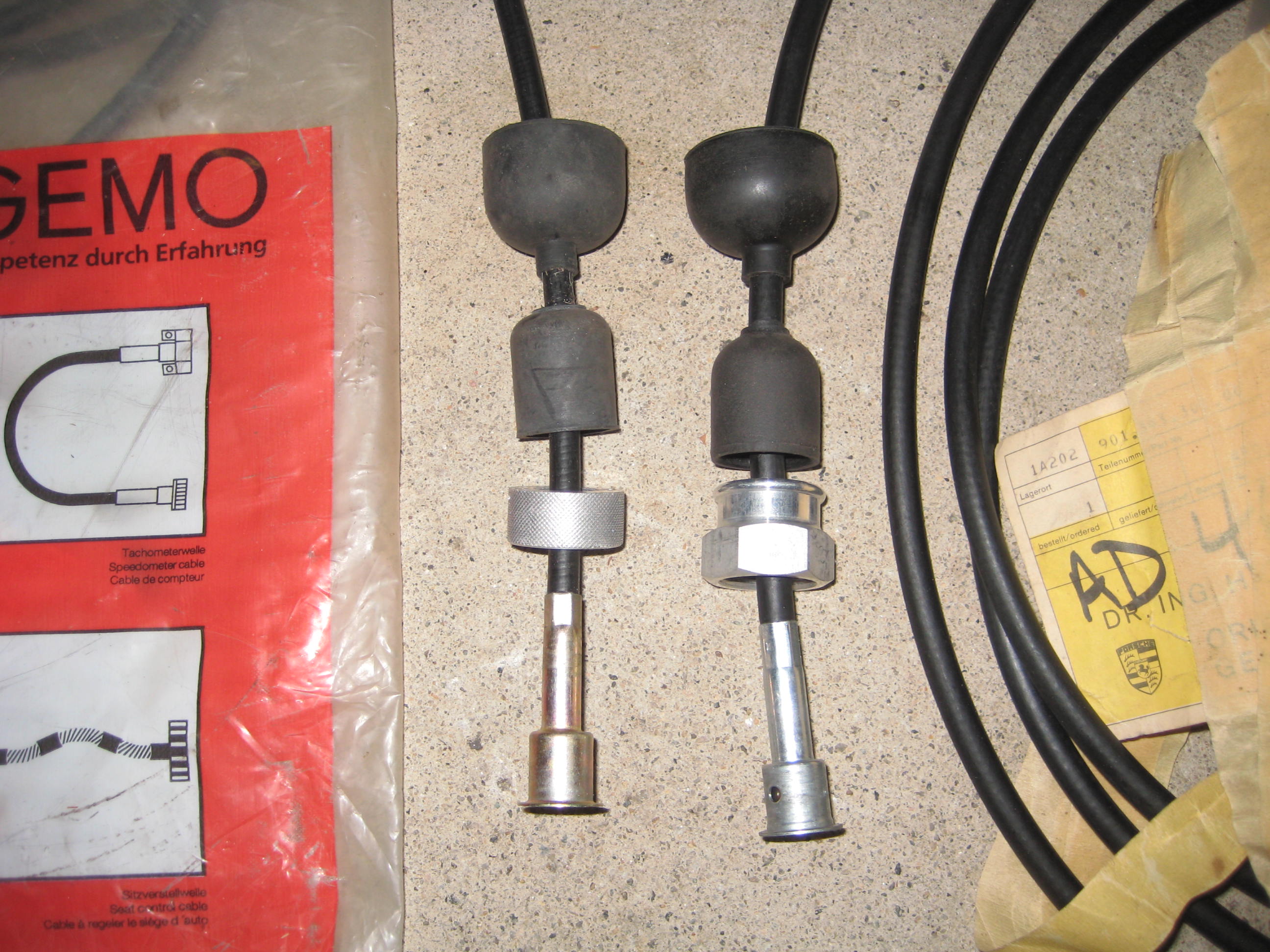

Here is a pic of my new speedo cable. This is the tranny end. The boot appears to be on the wrong way. Got this from the bird. Any one else have this issue? I am starting to loose faith in these guys.

Dr Evil   How is that on the wrong way? It is supposed to sl...   Aug 23 2014, 03:19 PM
mepstein   its correct. you'll see when you install.   Aug 23 2014, 03:33 PM
jeffdon   its correct. you'll see when you install. H...   Aug 23 2014, 03:40 PM
Dr Evil   Jeff, I am not following you. You dont take it off...   Aug 23 2014, 03:48 PM
JawjaPorsche   Jeff, I am not following you. You dont take it of...   Aug 23 2014, 04:30 PM
jeffdon   Jeff, I am not following you. You dont take it of...   Aug 23 2014, 06:25 PM
mepstein   Jeff, I am not following you. You dont take it o...   Aug 23 2014, 06:44 PM
jeffdon   [quote name='jeffdon' post='2077336' date='Aug 23...   Aug 23 2014, 08:05 PM
bluhun   [quote name='jeffdon' post='2077336' date='Aug 2...   Aug 24 2014, 01:51 AM
bluhun   [quote name='jeffdon' post='2077336' date='Aug 2...   Aug 24 2014, 02:05 AM
bluhun   [quote name='jeffdon' post='2077336' date='Aug 2...   Aug 24 2014, 02:20 AM
jeffdon   [quote name='jeffdon' post='2077372' date='Aug 23...   Aug 24 2014, 06:41 AM
bluhun   [quote name='jeffdon' post='2077372' date='Aug 2...   Aug 24 2014, 09:14 PM
Dr Evil   Here is the official pic from the PET. The lower p...   Aug 25 2014, 08:37 AM
Dr Evil   OK, I just replaced my speedo cable with a new Gem...   Sep 5 2014, 06:50 AM
eyesright   I have bought two cables for two cars in the past ...   Sep 5 2014, 08:36 AM
Dr Evil   I bet if we get Glenns attention to this thread he...   Sep 5 2014, 09:15 AM
Jacco   Had the same experiece with the speedo cable. Aske...   Sep 5 2014, 02:06 PM
mepstein   Had the same experiece with the speedo cable. Ask...   Sep 6 2014, 07:23 AM
rgalla9146   I don't know about the bulkhead boot. I do k...   Sep 5 2014, 07:56 PM
ClayPerrine   The boots have been reversed on the cables for yea...   Sep 6 2014, 07:09 AM
Jeffs9146   The boots have been reversed on the cables for ye...   Sep 6 2014, 09:44 AM
rgalla9146   The problem is not with the boots. It's a hard...   Sep 6 2014, 08:15 AM
jeffdon   How is one supposed to get a proper cable?   Sep 6 2014, 09:55 AM
mepstein   Is it worth keeping the old parts to remake a new ...   Sep 6 2014, 10:06 AM
rgalla9146   Sure, remove the angle drive end from the sheath o...   Sep 6 2014, 10:49 AM
jeffdon   Sure, remove the angle drive end from the sheath ...   Sep 6 2014, 01:53 PM
rgalla9146   ......my response was a bit tongue-in-cheek. may...   Sep 6 2014, 02:43 PM
bluhun   ......my response was a bit tongue-in-cheek. ma...   Sep 6 2014, 06:08 PM
jeffdon   ......my response was a bit tongue-in-cheek. m...   Sep 6 2014, 11:08 PM
