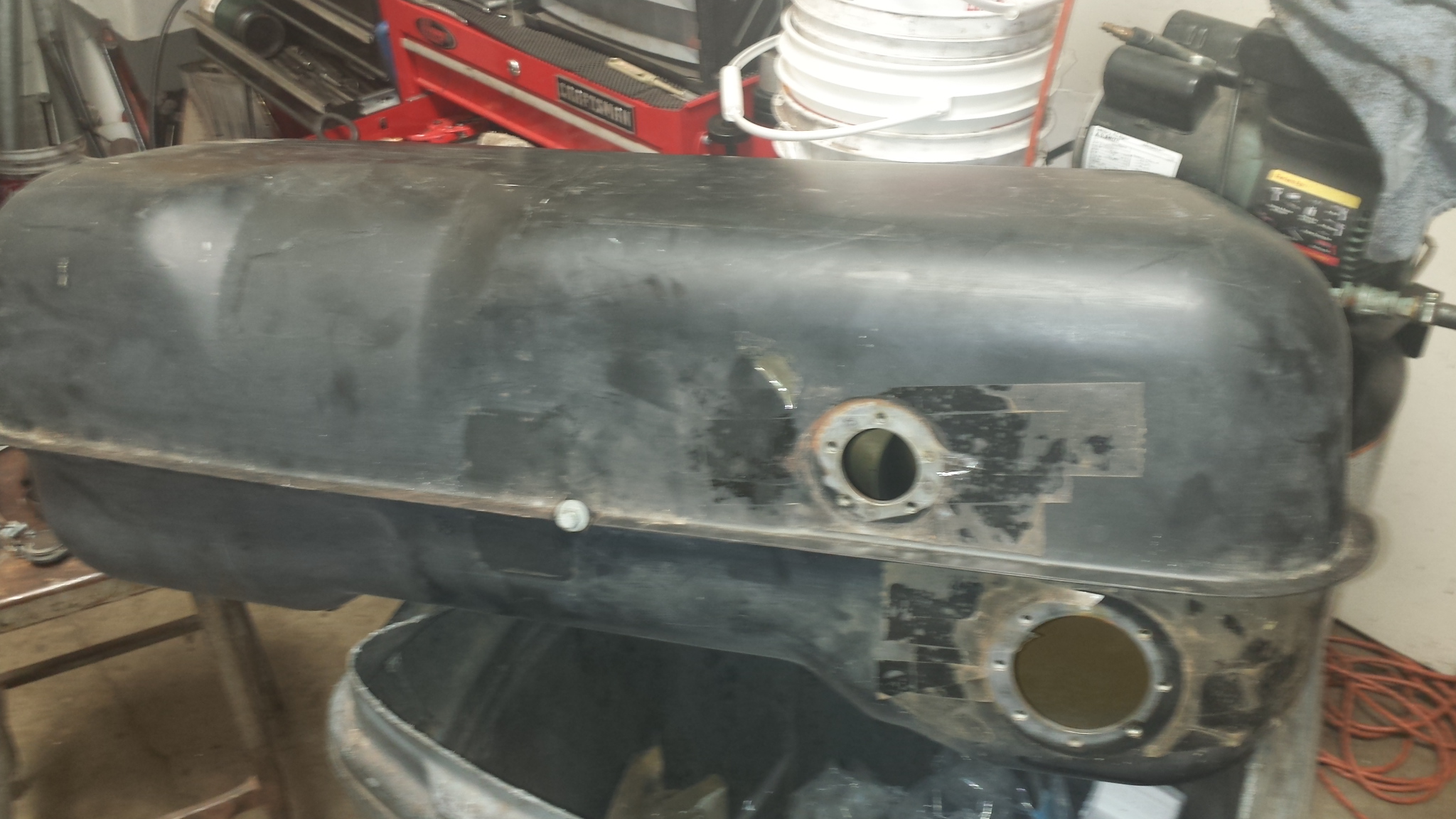

I have a couple of good clan late tanks. Hear are some pics of one of them if either of you are interested.
