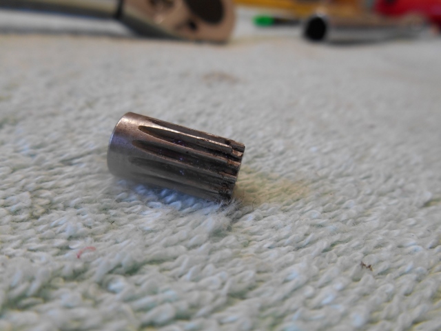

1970,1.7
my back passenger side brake is hanging up. found that the ebrake arm on caliper will not travel the distance it should, pulled the little gear from inside where you set the vent clearance and the teeth are chewed up and a couple missing. where can i get this one and would this cause the arm not to move??????? also would the little gear from a vw work????? (IMG:style_emoticons/default/mad.gif) (IMG:style_emoticons/default/headbang.gif) |

here is pic of gear,
can I cut it off and then... Sep 19 2014, 02:51 PM
Bob L. You can always borrow the one in the other caliper... Sep 19 2014, 02:58 PM
bdstone914 The other gear is probably damaged too. You should... Sep 19 2014, 03:01 PM
Cap'n Krusty There is no vw equivalent. I suggest you bite the... Sep 19 2014, 03:21 PM
Mblizzard :agree:
I am a cheap SOB. But after taking the ... Sep 19 2014, 03:54 PM
Cap'n Krusty Forget what I know about cars and stop for minute ... Sep 19 2014, 04:32 PM
