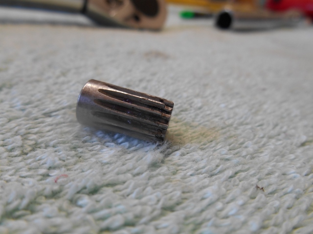

my back passenger side brake is hanging up. found that the ebrake arm on caliper will not travel the distance it should, pulled the little gear from inside where you set the vent clearance and the teeth are chewed up and a couple missing. where can i get this one and would this cause the arm not to move??????? also would the little gear from a vw work?????

here is pic of gear,
can I cut it off and then use stainless steel washer behind it when i put it back in???

You can always borrow the one in the other caliper. As for the lever not moving and the broken gear, Possibly. Either way I would want to look inside.

The other gear is probably damaged too. You should get a core caliper for parts and fix it right.

There is no vw equivalent. I suggest you bite the bullet and send both rear calipers to Eric at PMB. After all, IT'S YOUR BRAKES!
