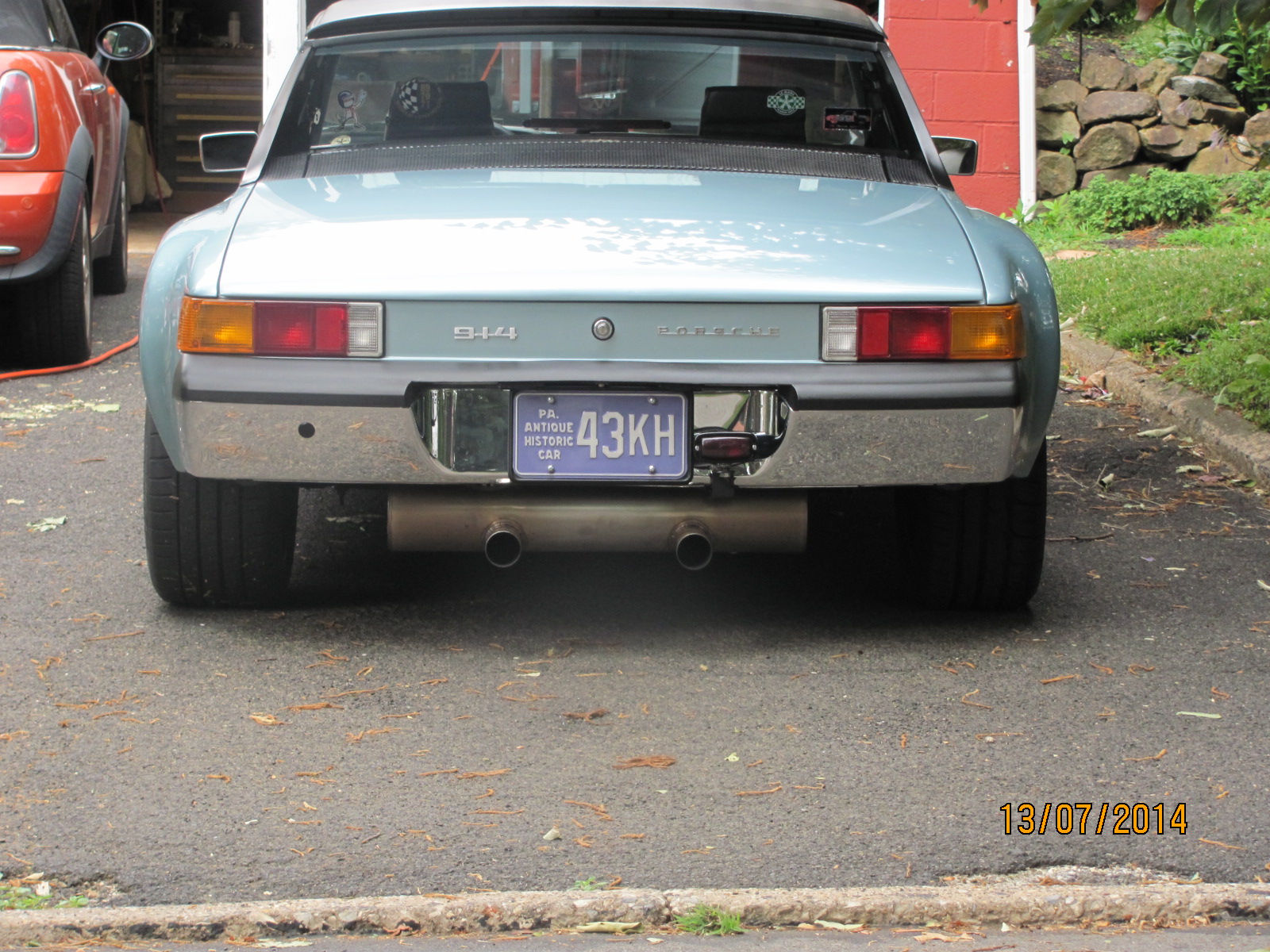

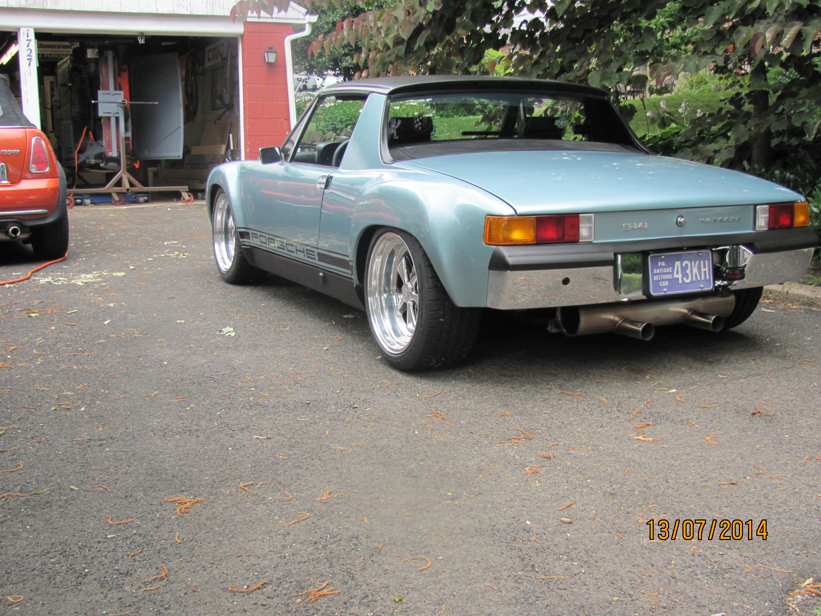

I have 9 x 17 Lindsey wheels with the 911 turbo 9 x 16 Fuchs offset and they fit with 245 tires. They actually have more inboard offset than the 911 8 x 16 Fuchs. So you can space them to get the optimum fit. There are wheel offset charts posted on Pelican that are helpful with the comparison. There are others here that have run the 9 x 16s, hopefully they will chime in. Good Luck Here's a pic of the Lindseys mounted.

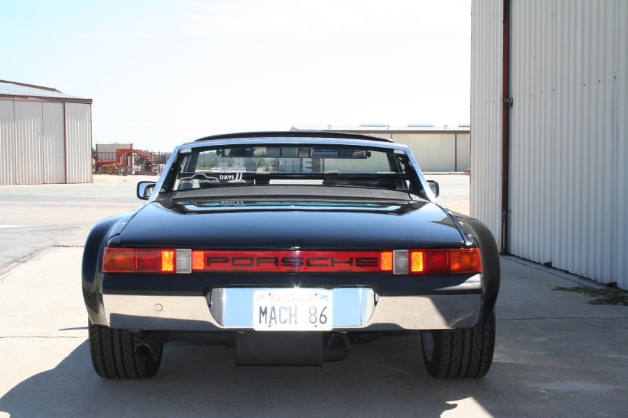

I have 9x16 under my flared car.
9x16 ATEV, early offset, ET15
8x16 with 3/4" spacer (1986 944 Turbo early offset, ET23 I think)

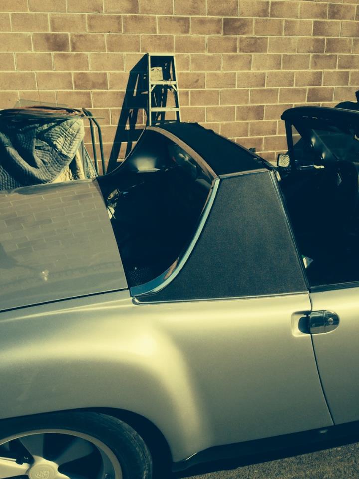

I have custom built 8.5"X16" Weidman Wheel built Fuchs on my car. Harvey knows the exact offset needed to fill the factory flare completely as there isn't a bit of room left.
Also, your factory flares have a different flange than the reproduction flares. The reproduction has a 1/2" or so of flange that has to be trimmed if you are going to get real wide...
Side view from above... Original Customs installed the flares and there isn't a bit of room left in the rear.

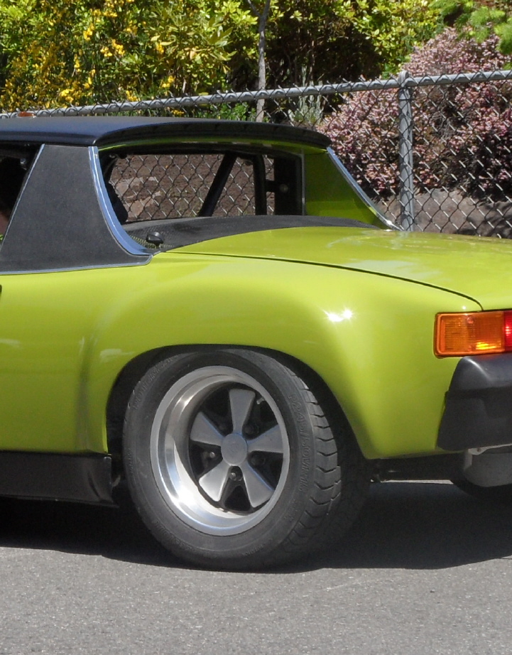

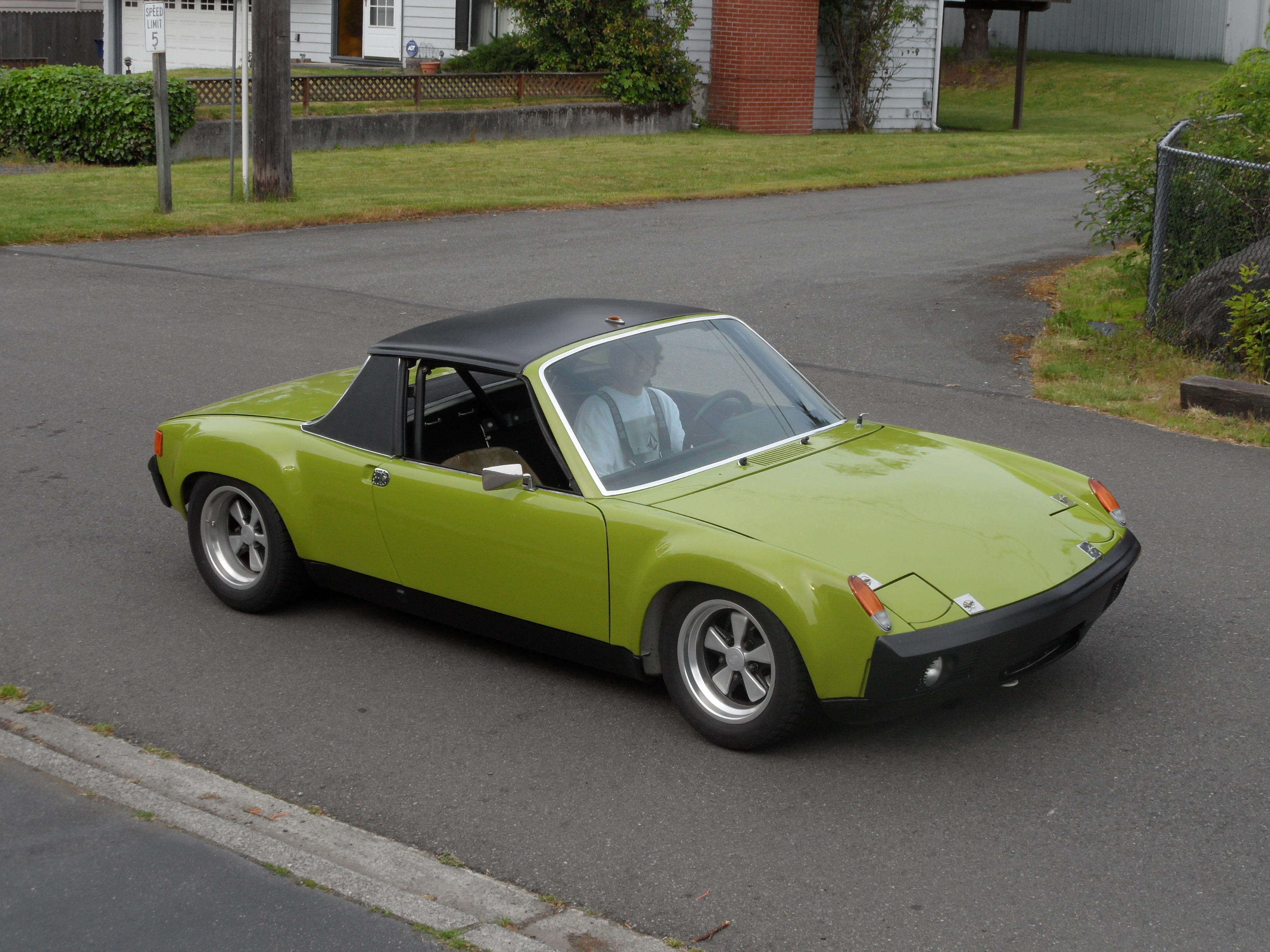

I also have Fuchs 16x9 in the rear under flares. They are AA repro flares, though.
