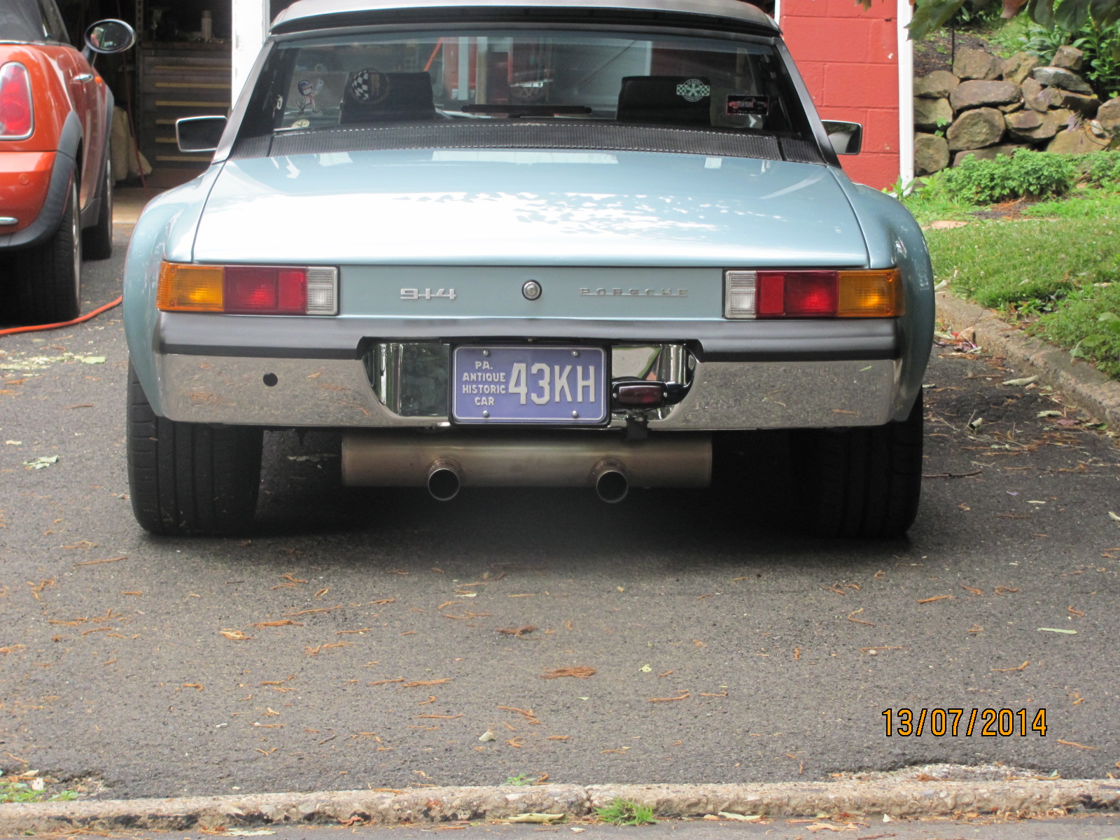

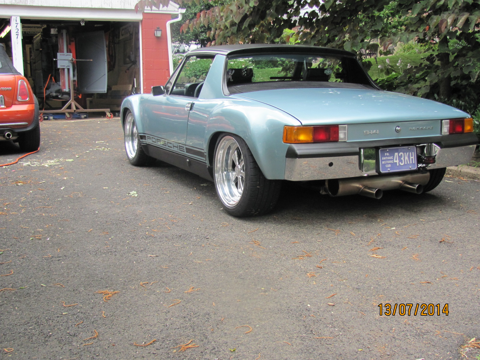

I have 9x16 under my flared car.
9x16 ATEV, early offset, ET15
Click to view attachment8x16 with 3/4" spacer (1986 944 Turbo early offset, ET23 I think)
