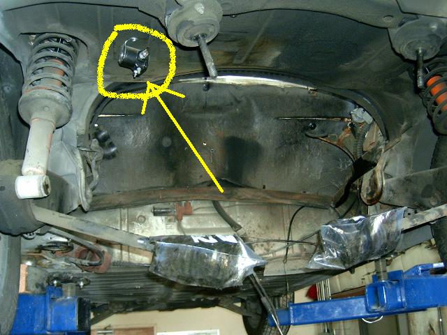

I was working in the trunk on some rust issues and noticed 2 self tapping screws sticking up from below. This is what I found. I don't think it's supposed to be mounted like this. Where is it supposed to be?
Headrage   Starter Relay?   Jan 28 2005, 01:57 PM
CHAFF   Looks like a ford solenoid to me   Jan 28 2005, 02:02 PM
scott thacher   there is no starter relay on a 914, its built in t...   Jan 28 2005, 02:06 PM
bondo   Yeah, that's a ford solenoid. You don't ne...   Jan 28 2005, 05:10 PM
SLITS   That's a cat crap/pisser hot shot shocker....i...   Jan 28 2005, 05:13 PM
Cap'n Krusty   We've been here just this week. The Bosch rel...   Jan 28 2005, 05:53 PM
