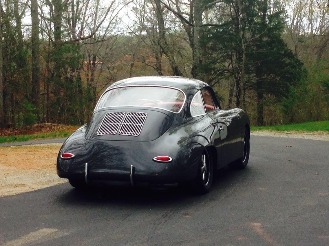

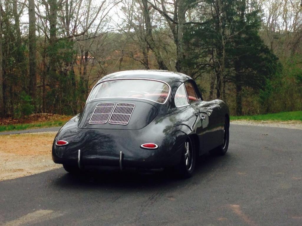

I have an Emory 356 that puts out about 120hp at the wheels and weighs in at about 1600lbs.
Here's my Raby Typ456 Outlaw, built from a 64C. It makes 185 at the wheels and isn't conventional. Weighs around 1520 with lexan windows and most other lightweight goodies. It was a SCCA/VSCCA race car for 40 years and its just as light now, as it was then, maybe a little lighter since I pulled the cage out of it when akin it into my street car again.

Damn! That thing looks like it would bite if you got too close.

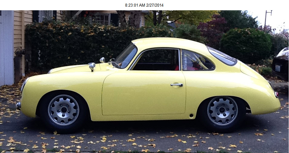

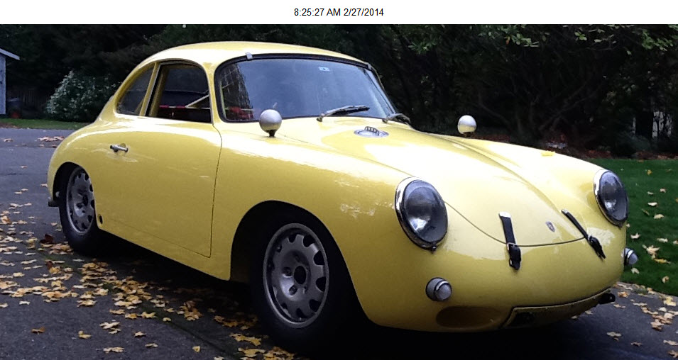

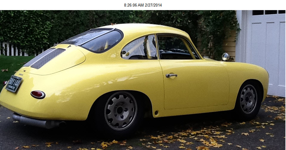

Here's my Outlaw.....Just for fun!Attached Image Attached Image Attached Image

I have to say, being brand spanking new to the 914 world, but not new at all to all things Porsche, that I've never had such a challenge dipping into the well spring of experienced builders, racers, drivers and owners to get the details of tied and true solutions and sources. In both the 911 and 356 worlds it would take you all of one evening on the forums to figure out all the details of virtually any build you wanted to pursue. Clearly, the artistry of actually doing the build is another thing, but figuring out what the community has tried and likes and what the details are to get there has been really challenging. I think I'm cranky tonight (IMG:style_emoticons/default/headbang.gif)
