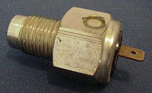

JeffBowlsby
post Feb 1 2005, 08:41 AM
Posts: 9,264
Joined: 7-January 03
From: San Ramon CA
Member No.: 104
From PP

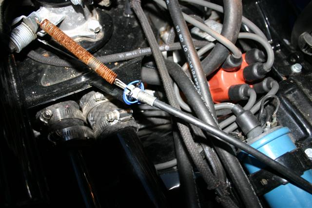

It is located in the background behind the throttel cable end housing, the silver part that you see are the threads and the dark shiny part is the bracket. Thats inbetween the cable end and the cloth covered vacume line. Hope you can see this.
Joe

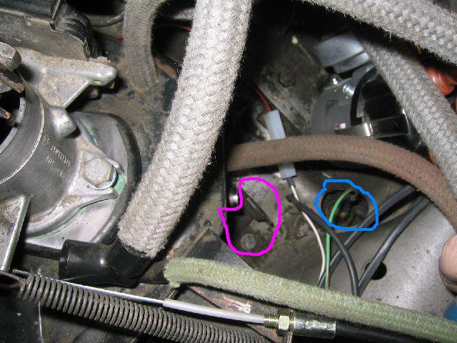

eldiosyeldiablo
post Feb 4 2005, 09:55 PM
Posts: 129
Joined: 19-August 03
From: Roswell, GA
Member No.: 1,047
I am still unable to find the TTS.
Jeff, thank you for the picture. The closest thing that I could find is what I believe is the oil pressure switch.
I have circled what I think is the oil pressure switch in blue.
Is the TTS suppose to be where I have the pink circle?
What will happen if I leave the TTS off or not plugged in?
Thank you,
David

post Feb 4 2005, 10:07 PM
Resident German
Posts: 42,483
Joined: 21-January 03
From: Oakland, Kalifornia
Member No.: 179
QUOTE (eldiosyeldiablo @ Feb 4 2005, 07:55 PM)
yes!
it's supposed to be screwed in there, you should be able to see the big threaded hole in the bracket right there ...
(IMG:http://www.914world.com/bbs2/html/emoticons/wink.gif) Andy
