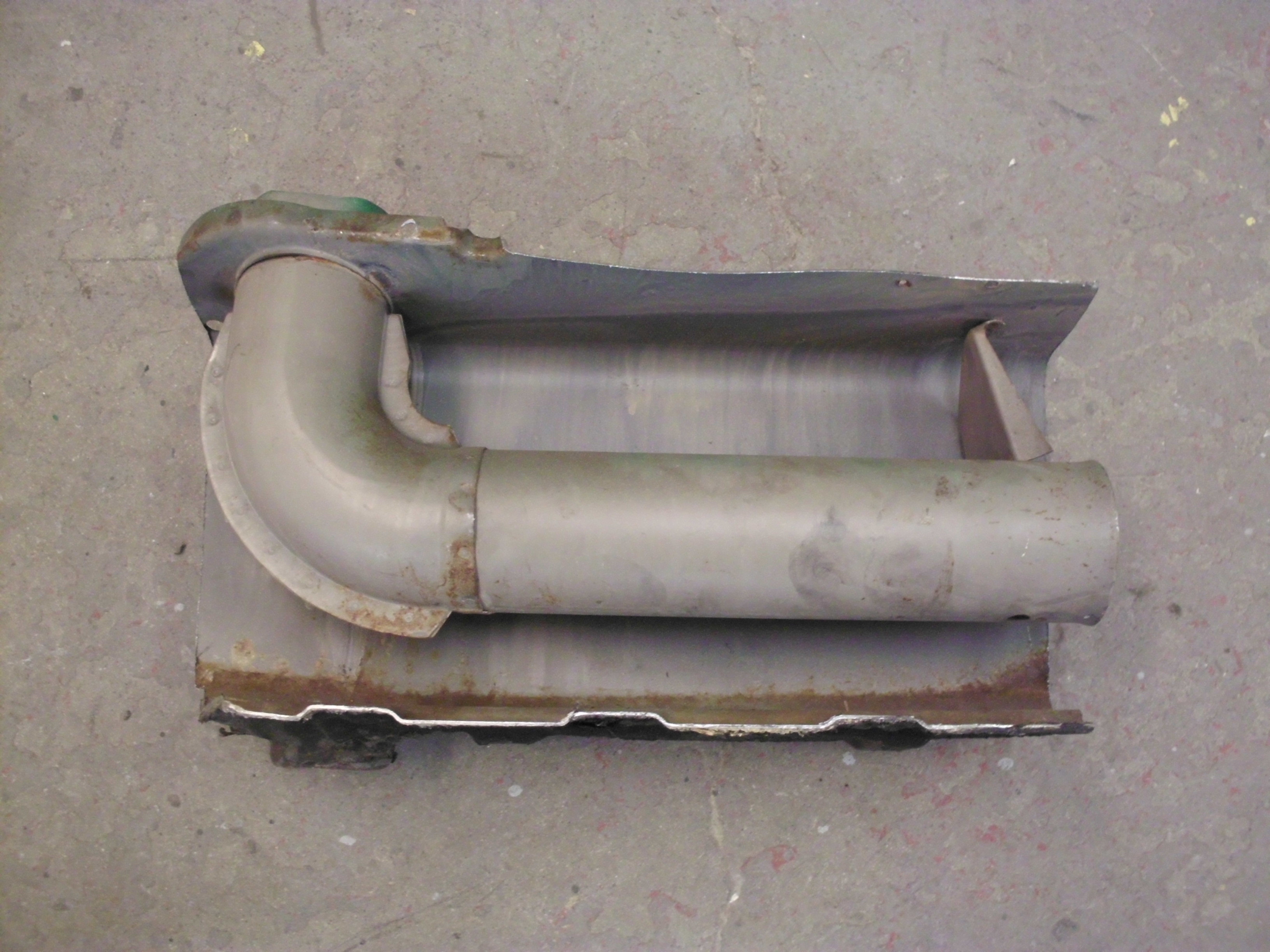

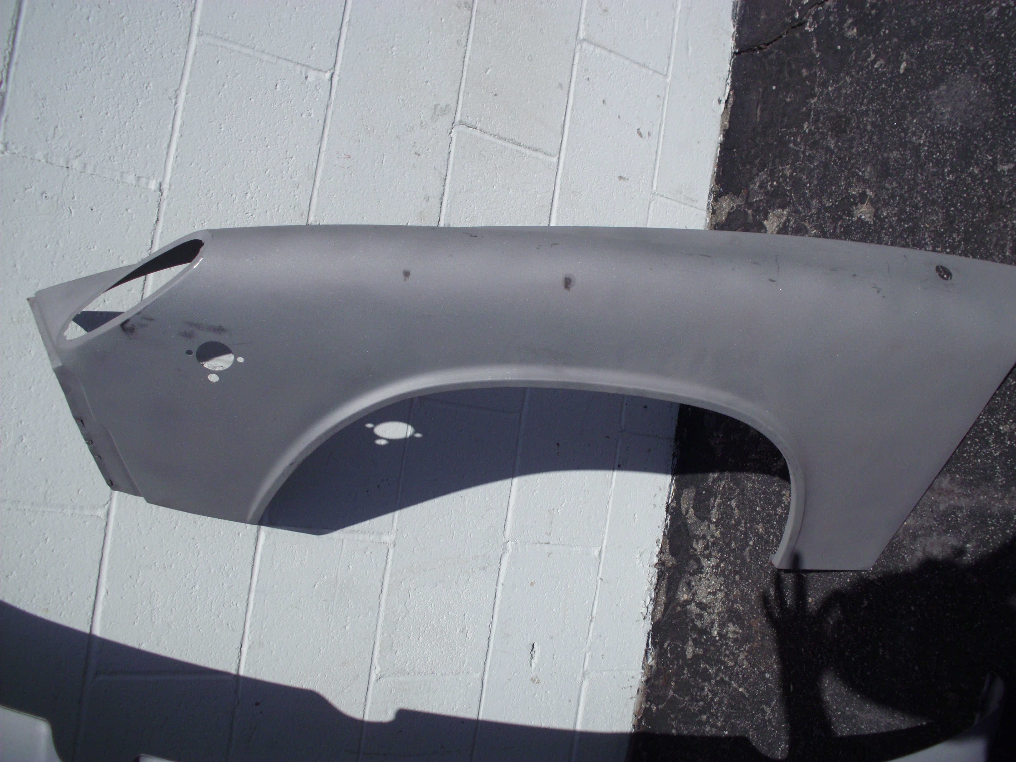

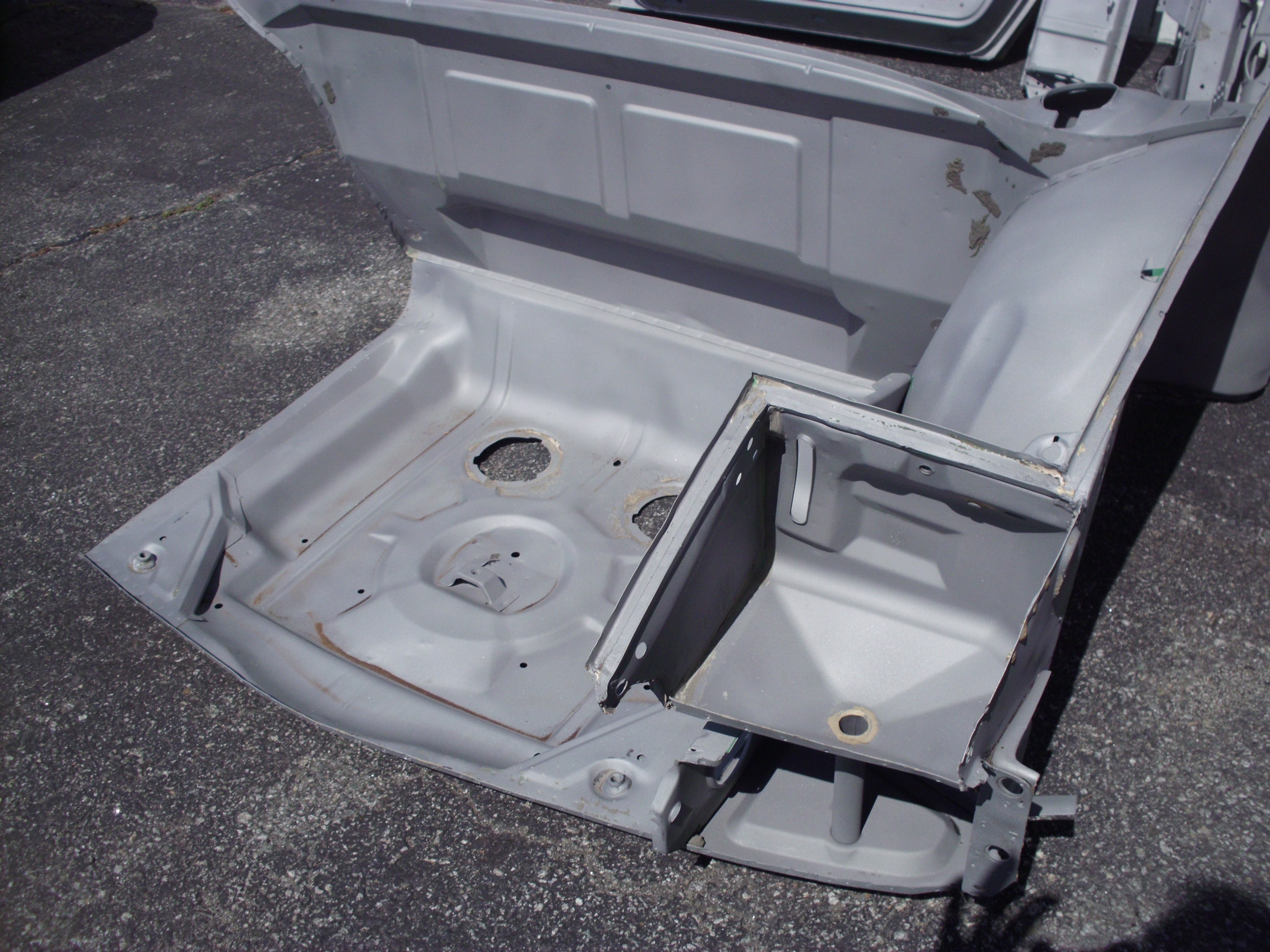

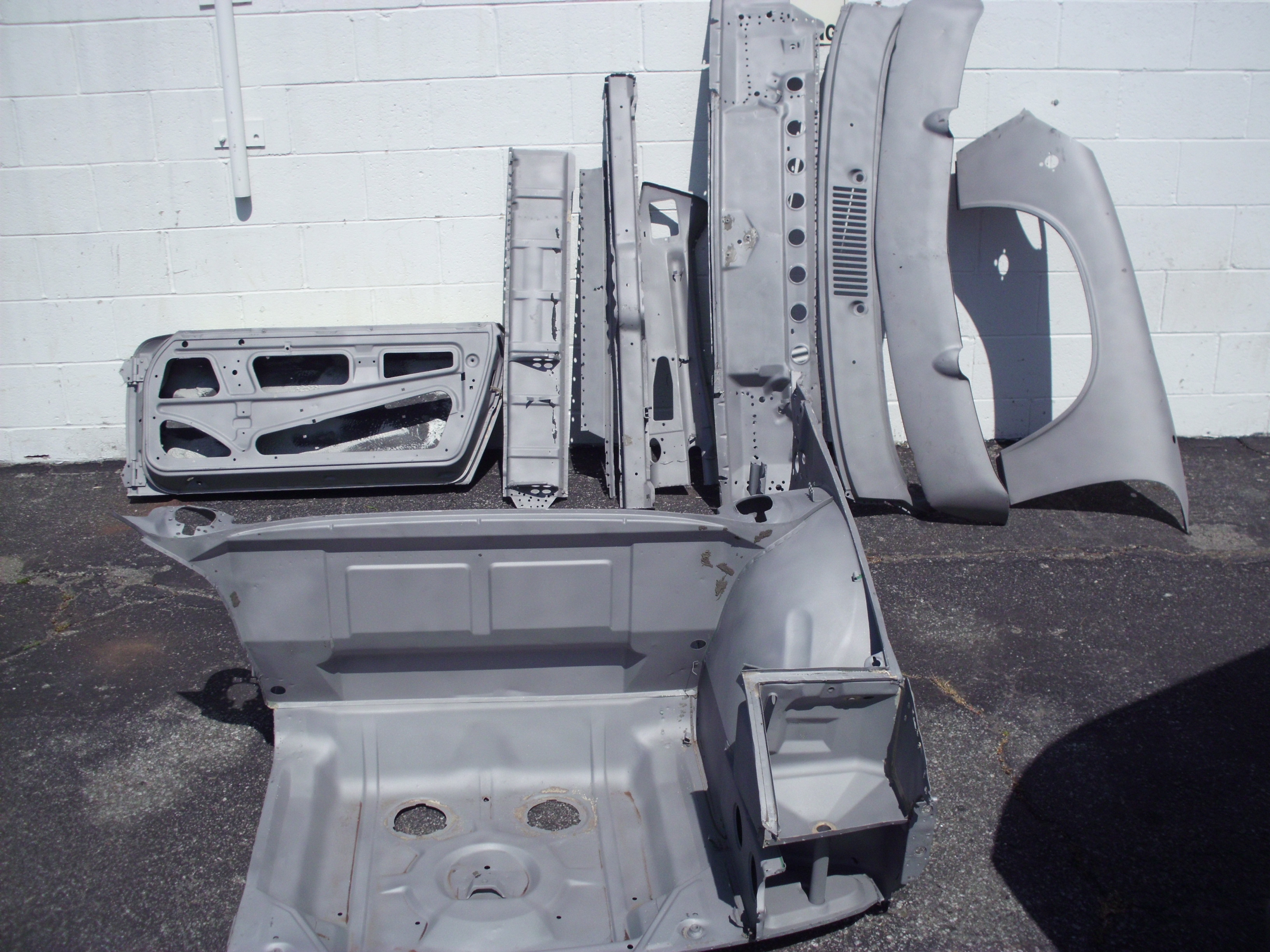

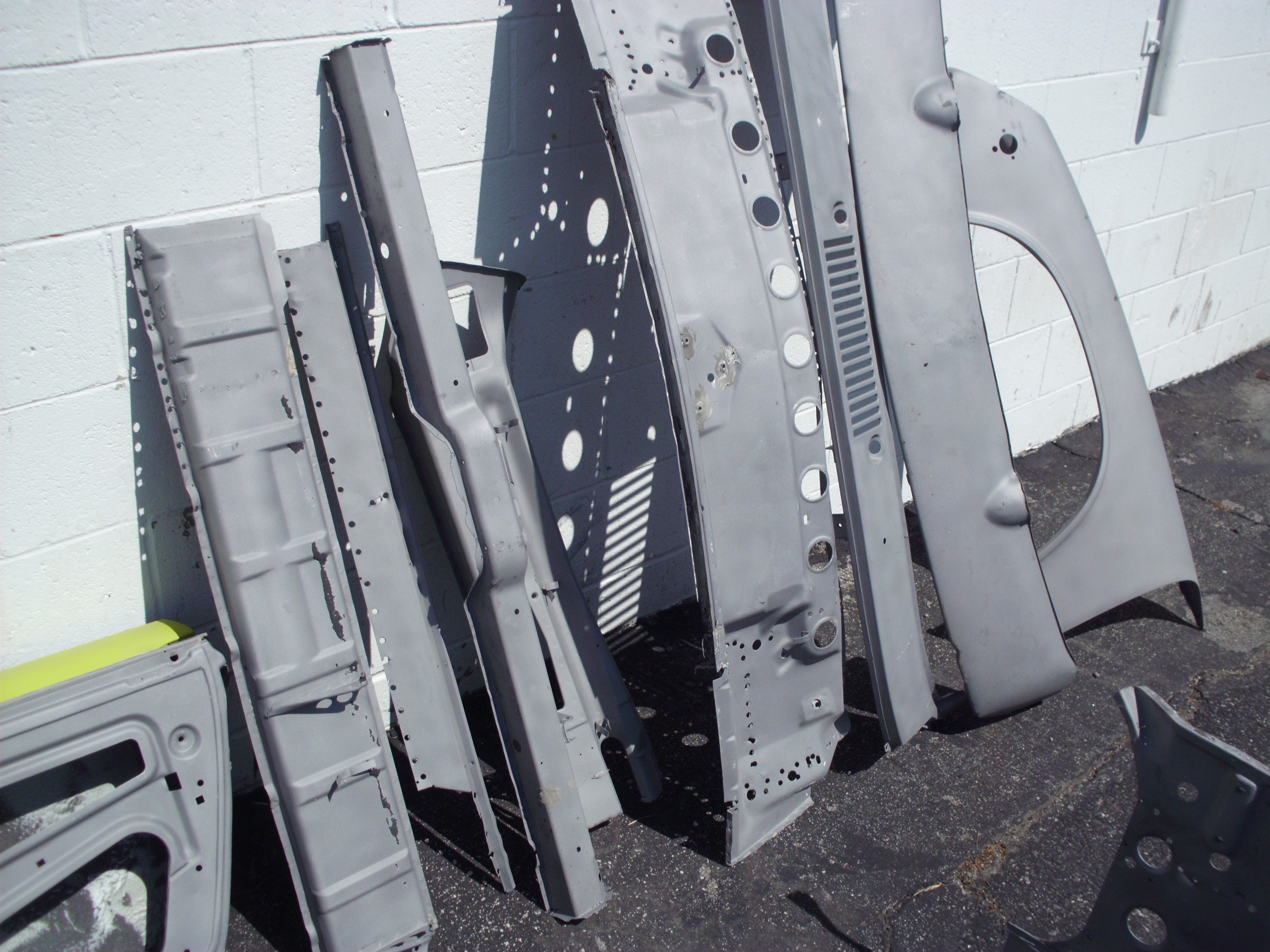

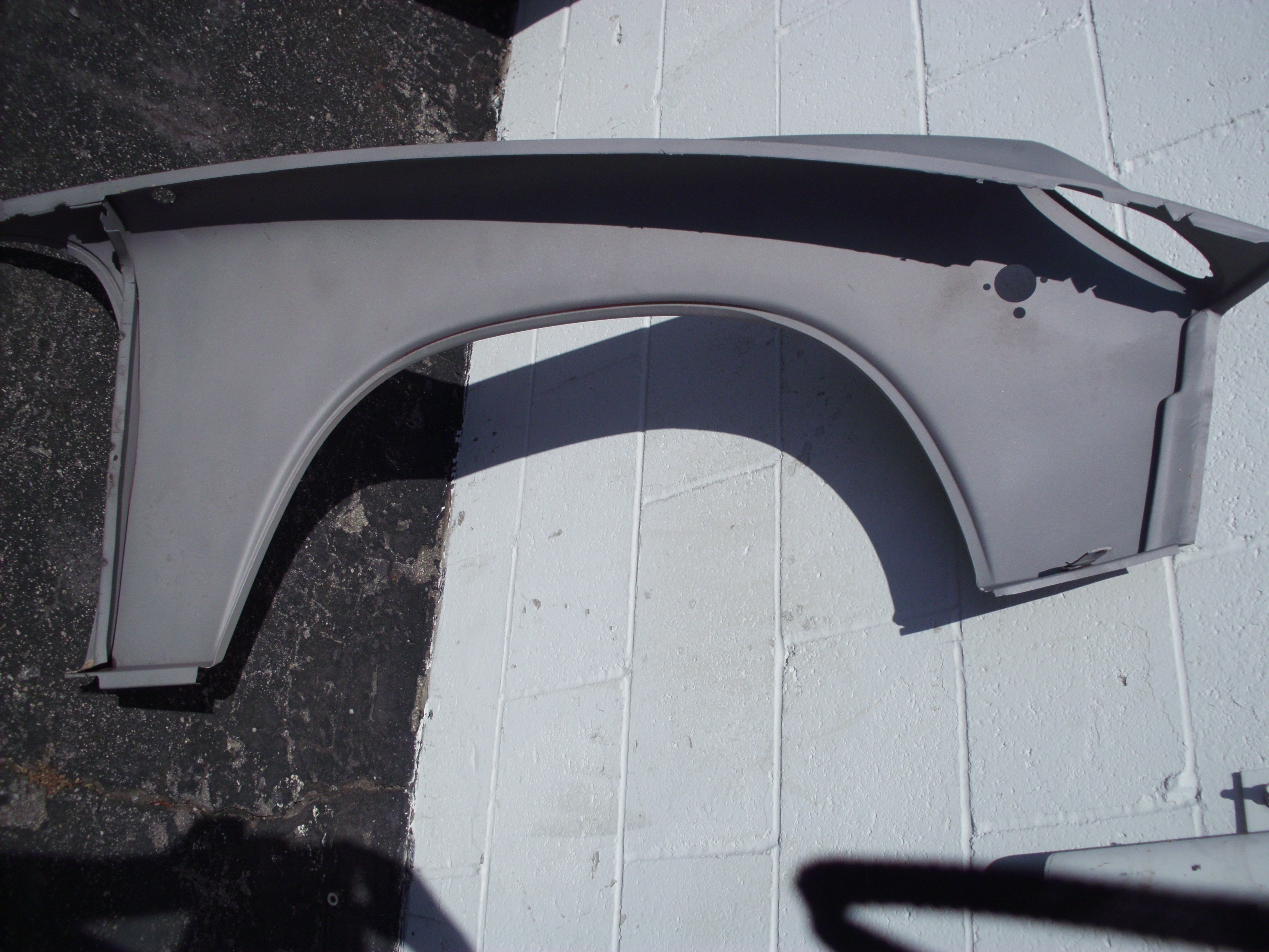

Got a load of parts back from media blasting today. Now I can start putting it back together.

I tied the doors together so they only blast the jams and inside and don't warp the skins. I will strip the skins with Aircraft stripper.

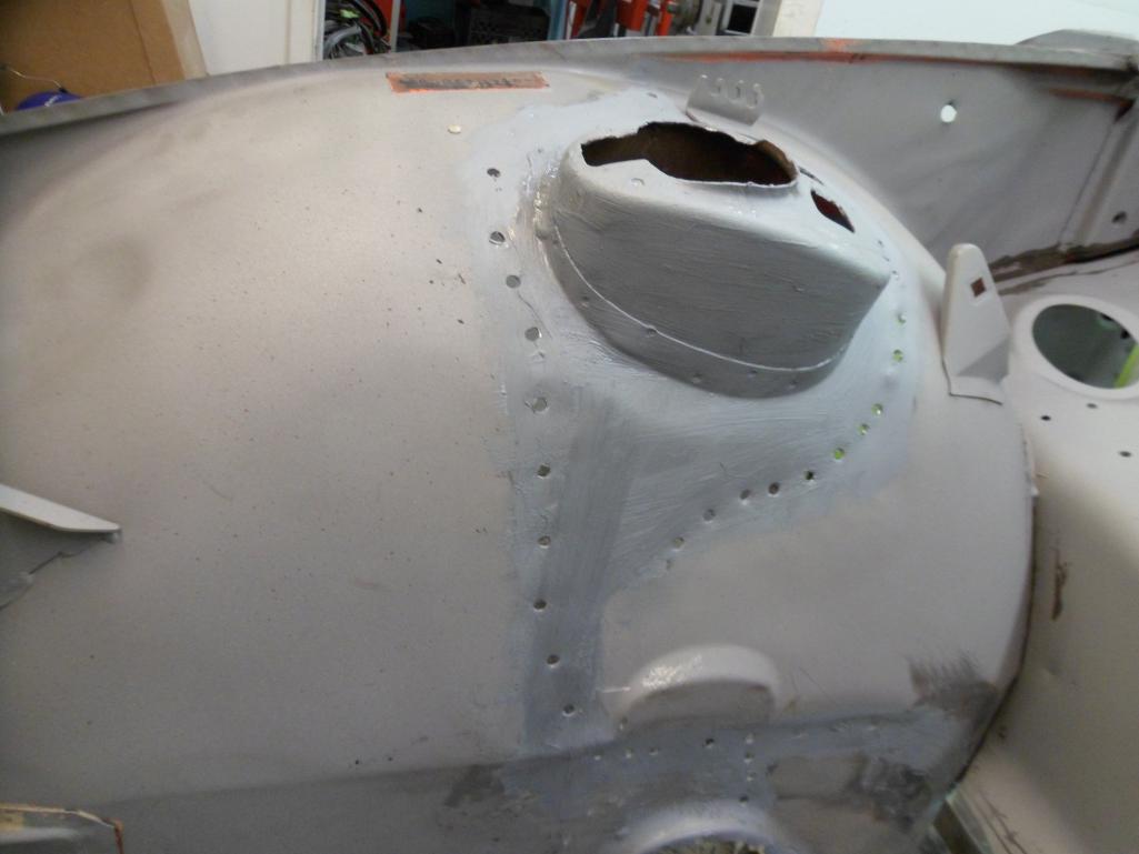

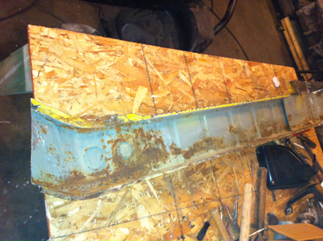

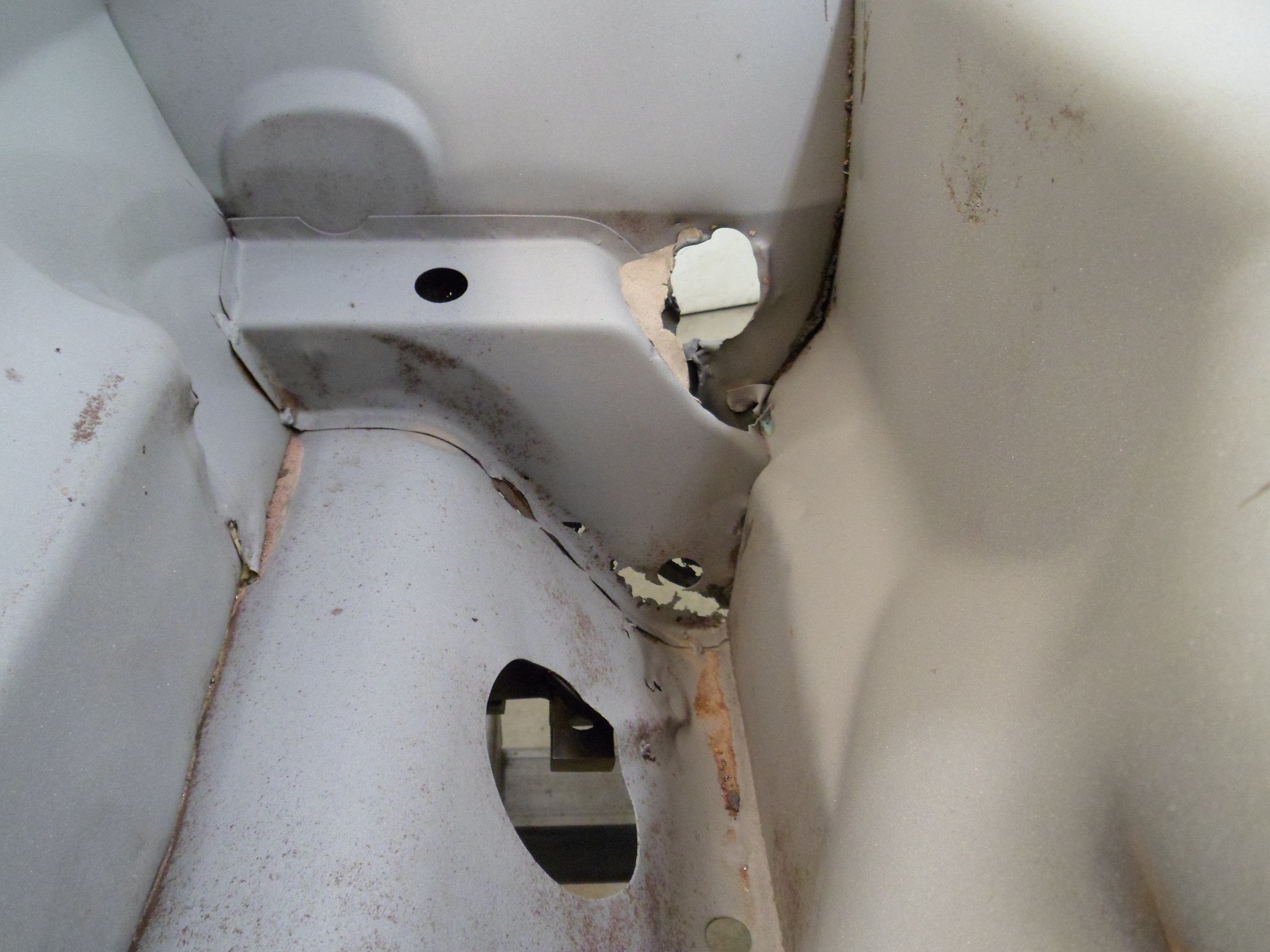

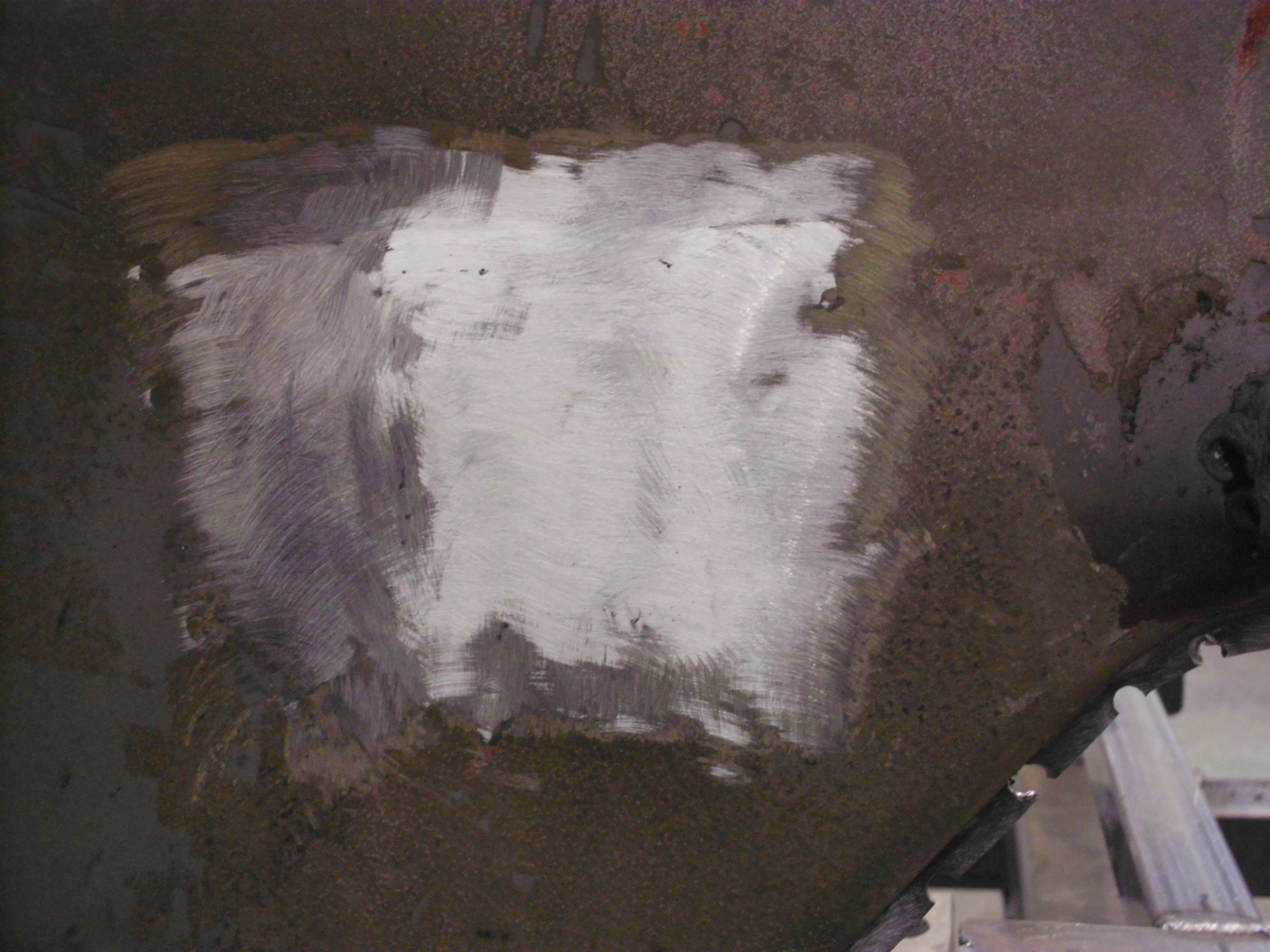

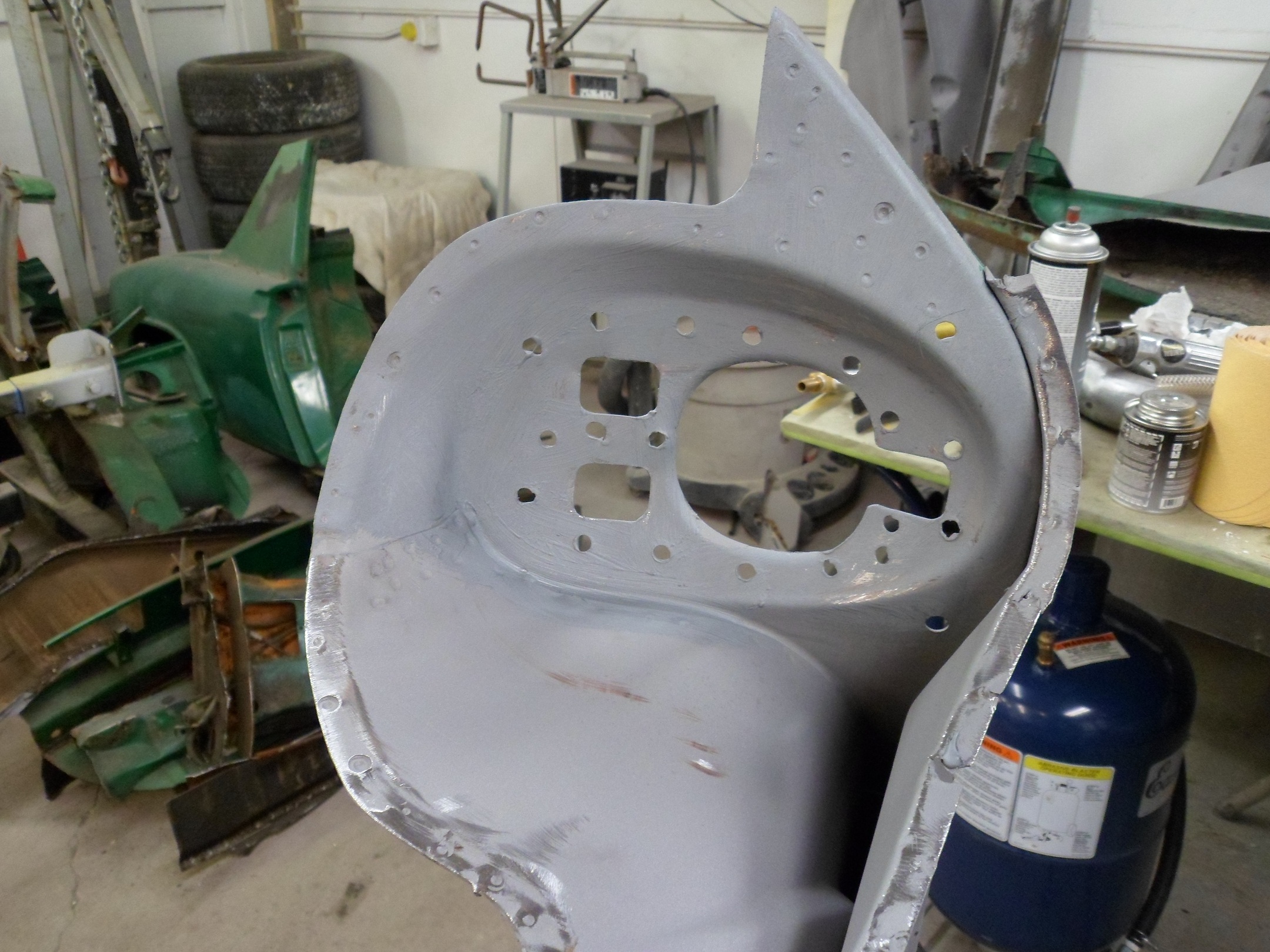

a PO had crudely punched/torn a hole in the inner fender to run lines.

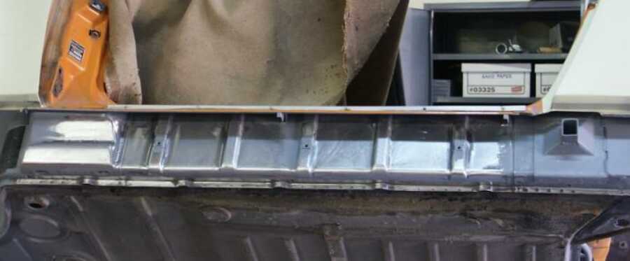

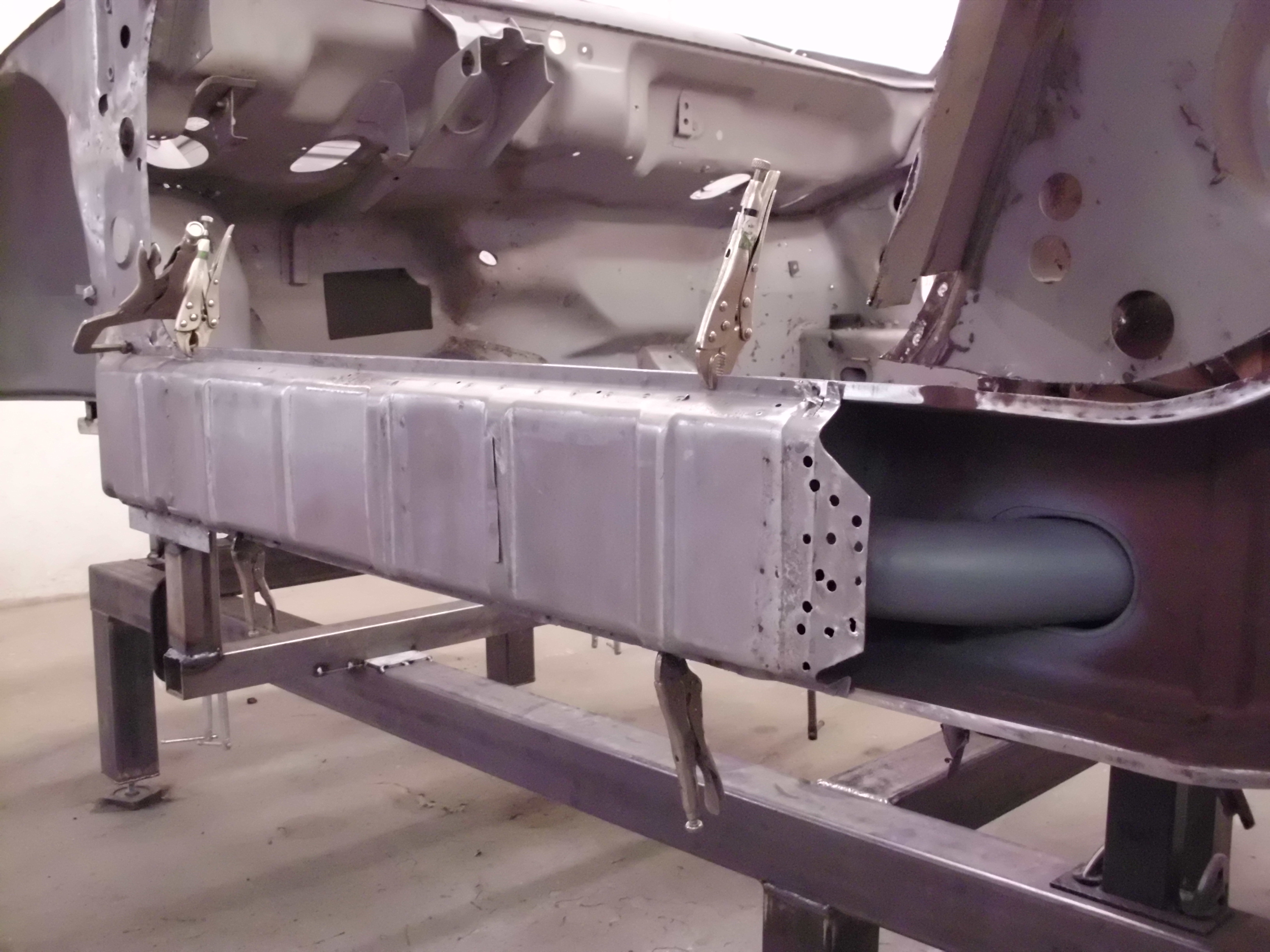

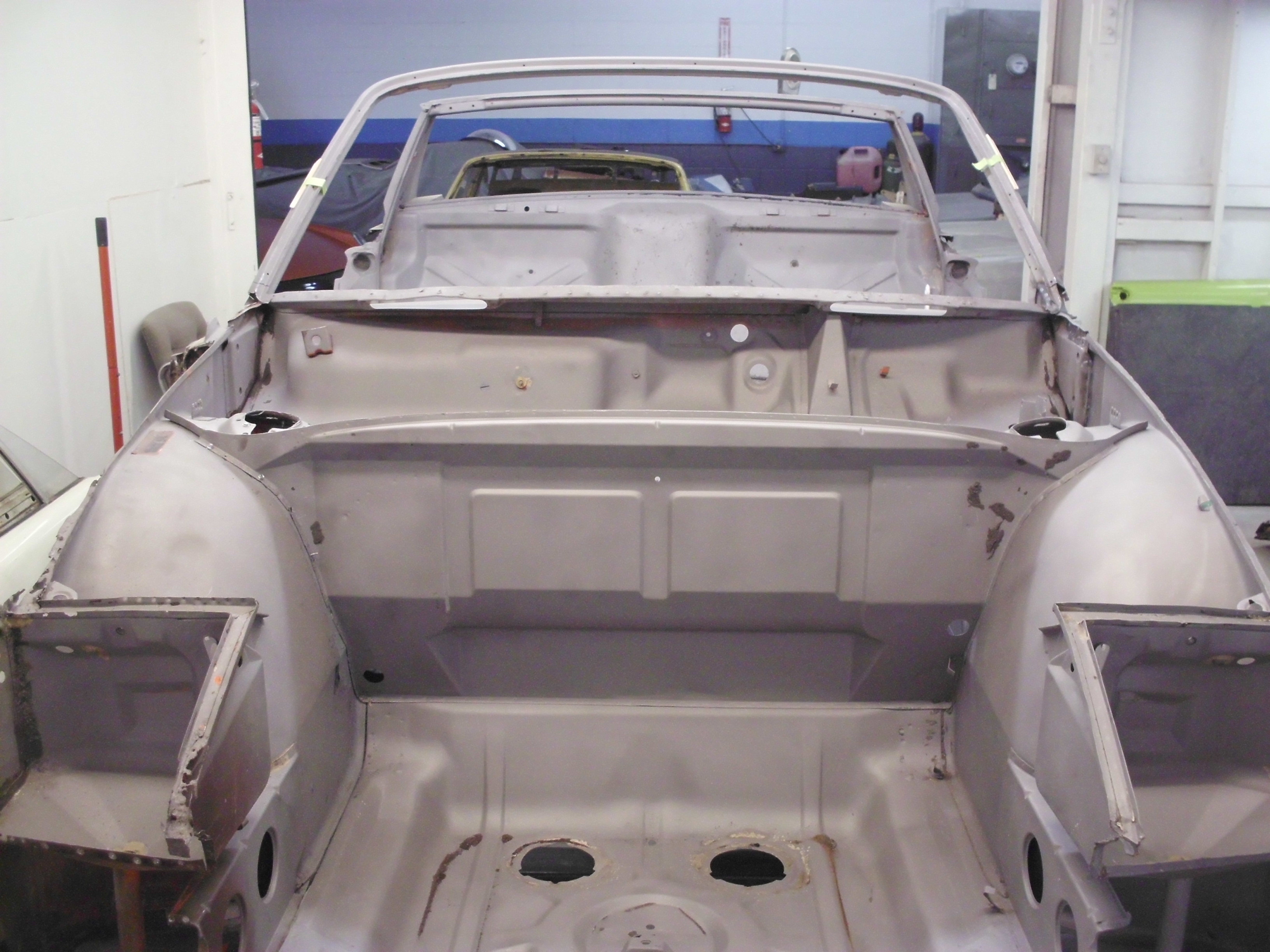

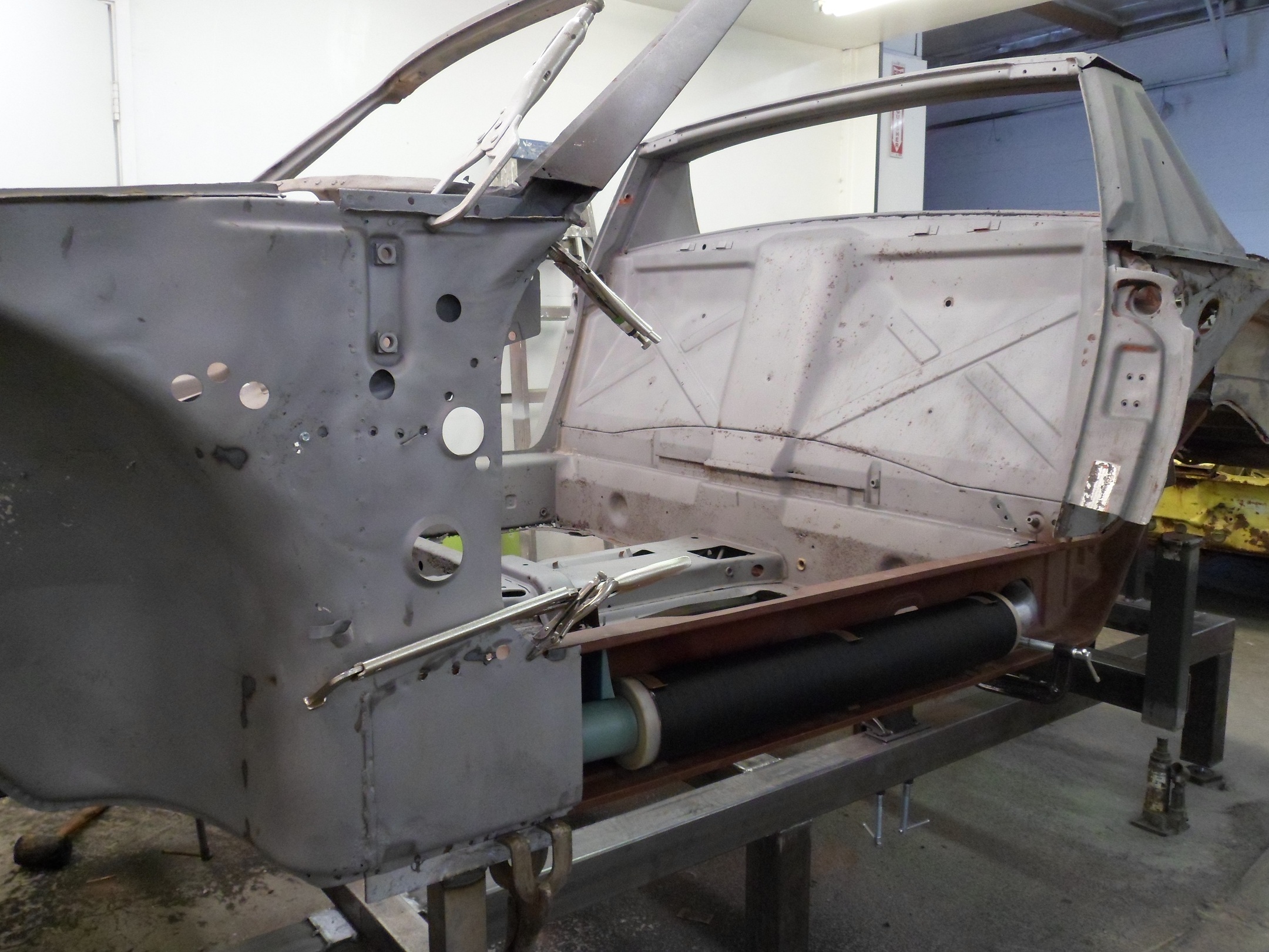

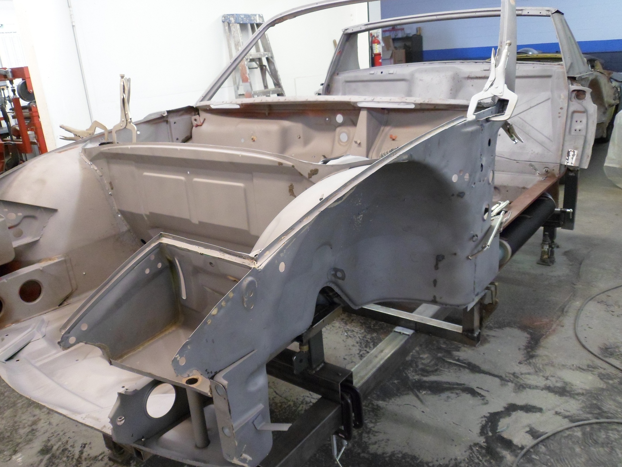

More progress today.

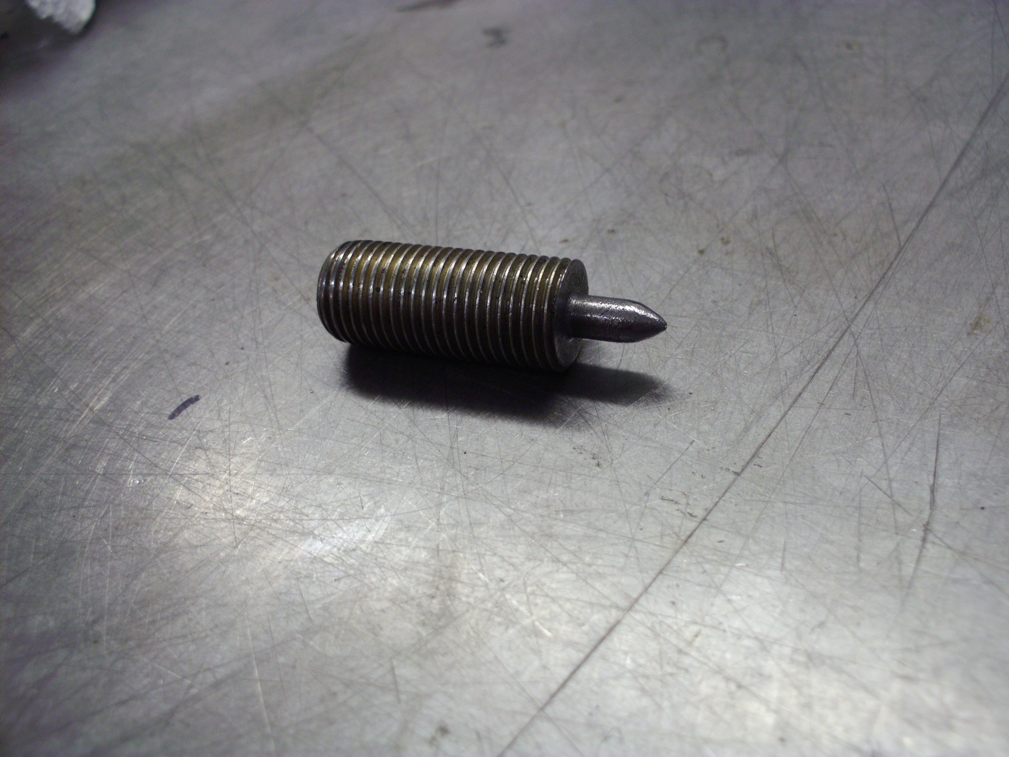

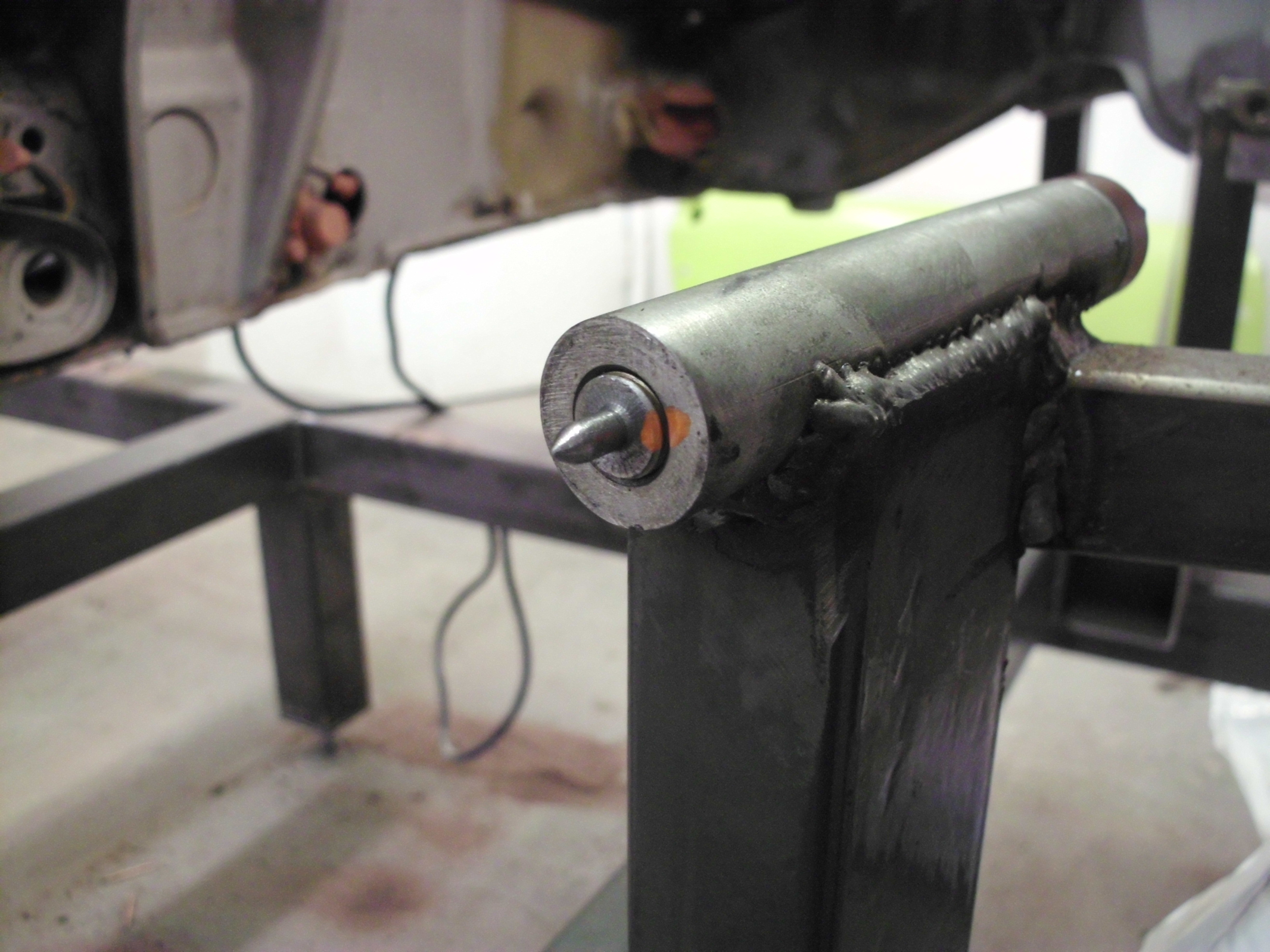

I made this punch that screws into the Jig. Once the long is welded in place, with a lite tap on the suspension consol, It will leave a dimple and I will have perfect center for boring the hole that the suspension arm mounts to. I'll drill the hole once the car is on the rotisory.

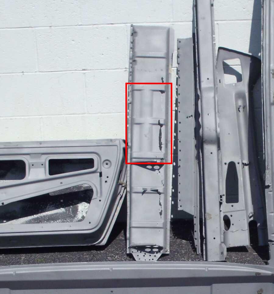

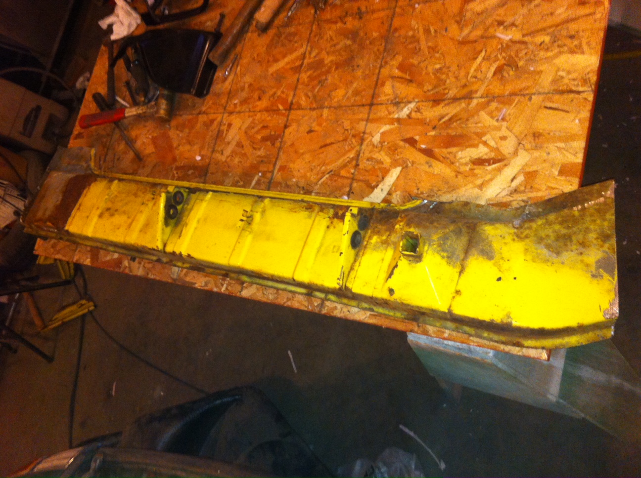

BTW the inner rocker cover you have is incorrect for an early (70-72) car
This is the correct part
rick 918-S
post Mar 22 2015, 07:30 PM
Post #154
Hey nice rack! -Celette
Posts: 21,352
From: Now in Superior WI
Member No.: 43
QUOTE(gms @ Mar 22 2015, 07:48 PM) *
looking good!
If you end up needing that outer panel I have the correct section. Just needs blasting
914350
post Mar 22 2015, 07:56 PM
Post #155
Posts: 548
Joined: 21-April 14
From: Torrance Ca.
Member No.: 17,275
Ah Ha! I see. This part came off the 73 Donor. Thanks for catching that and letting me know. I would have probably noticed...after I welded it on.
I'll PM you about the peice/section that you have.
Thanks again.
914350

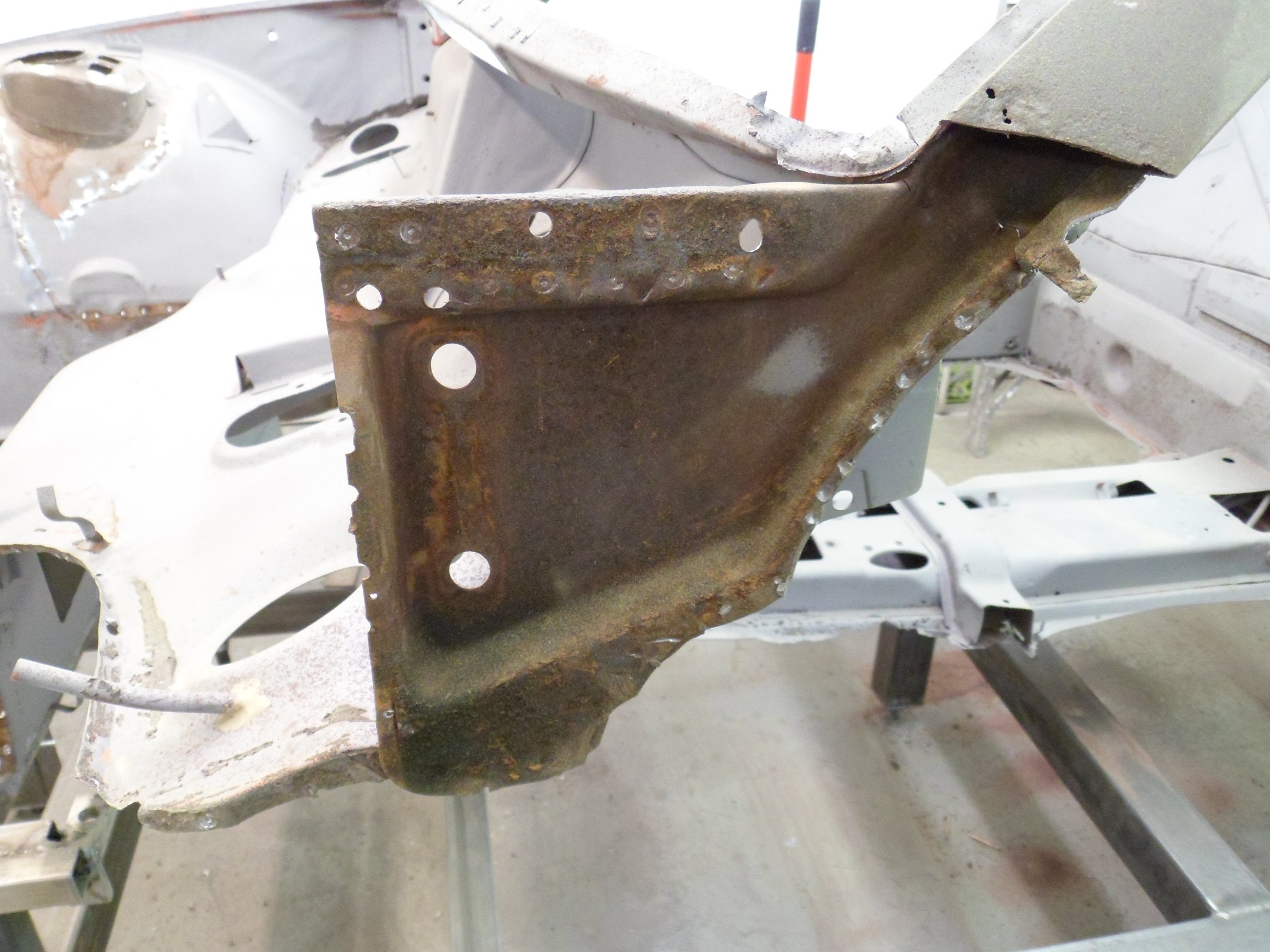

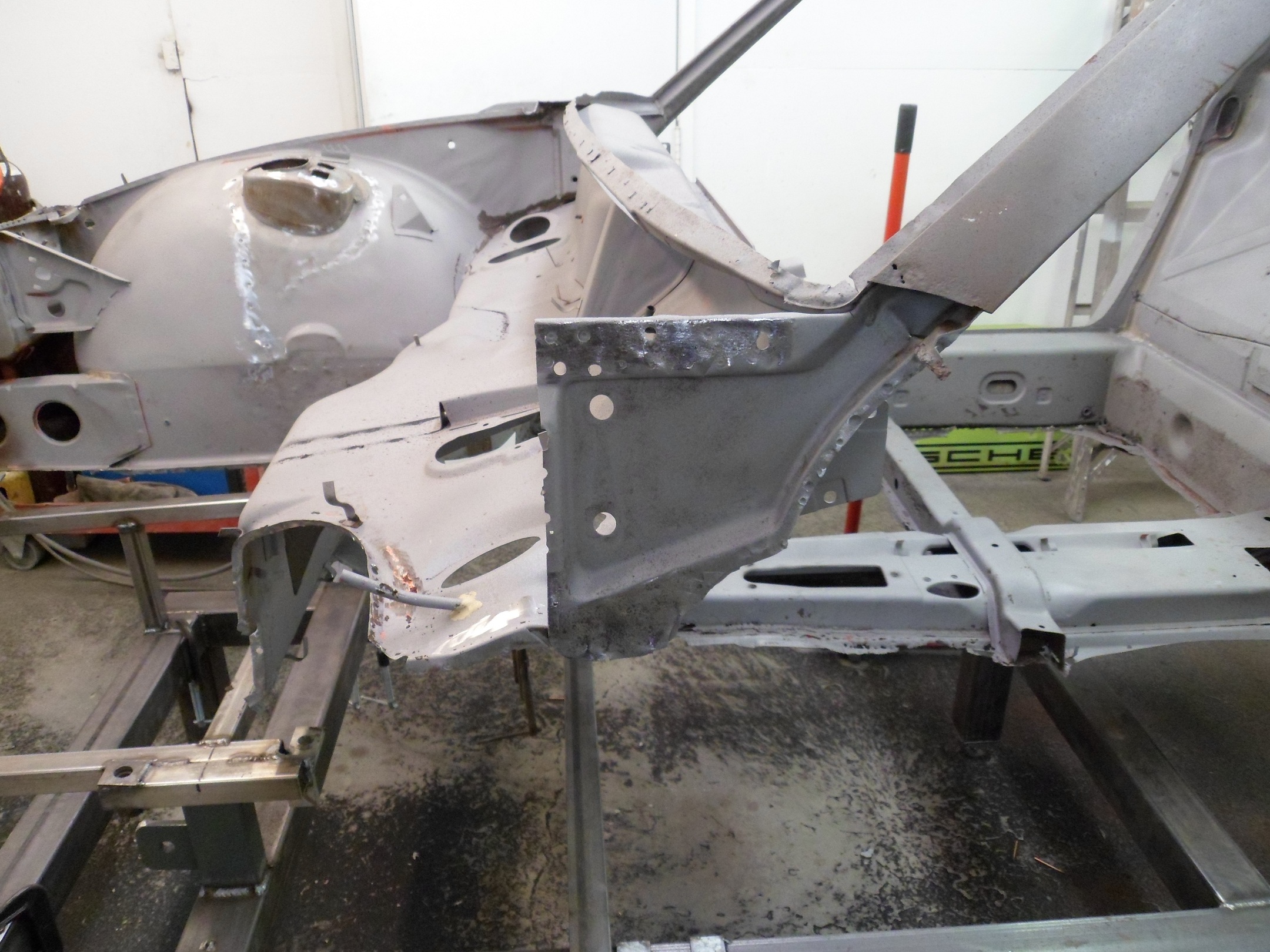

post Mar 31 2015, 08:36 AM
Post #156
Posts: 548
Joined: 21-April 14
From: Torrance Ca.
Member No.: 17,275

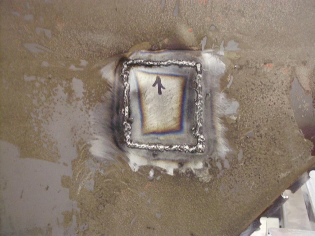

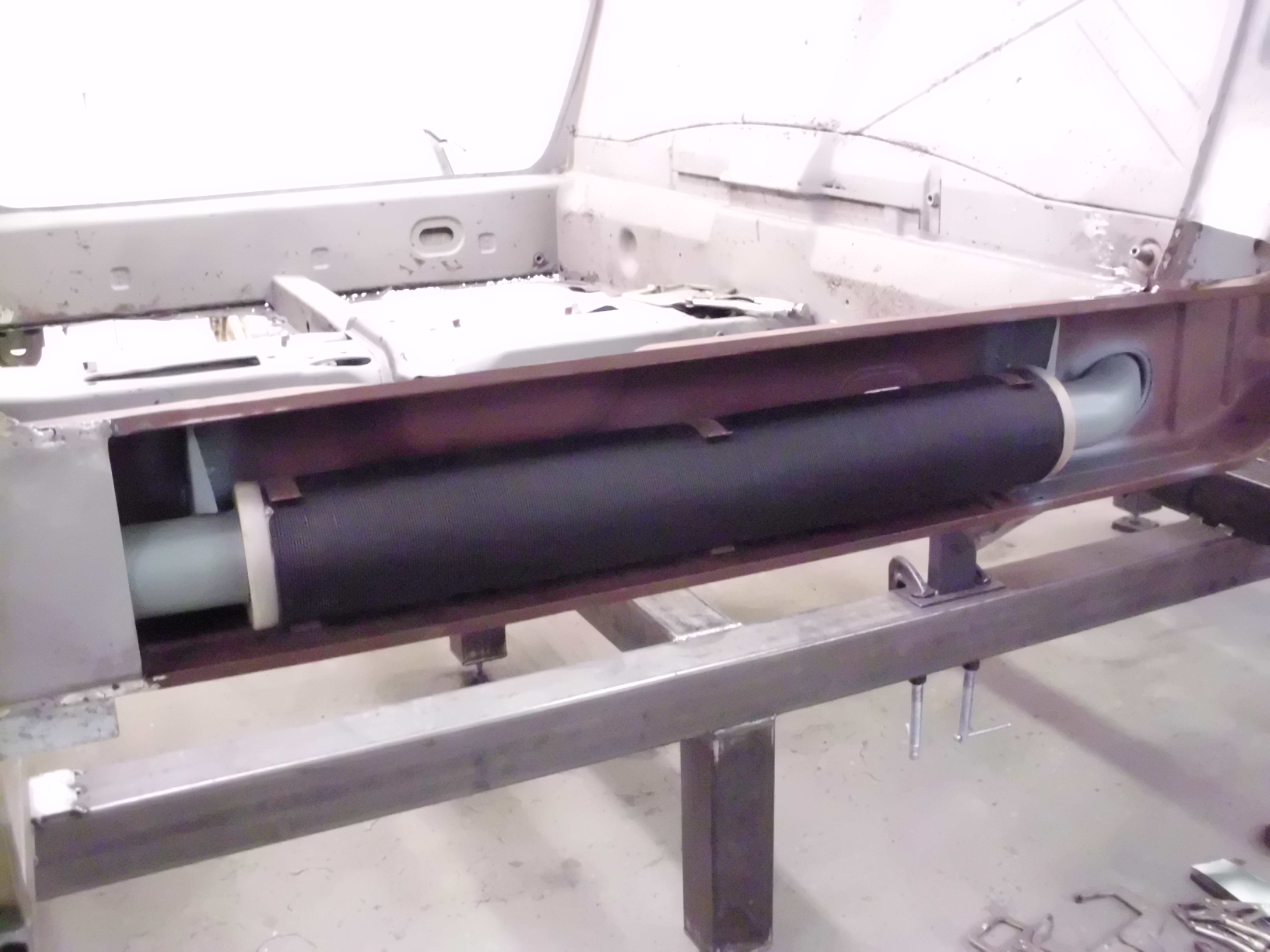

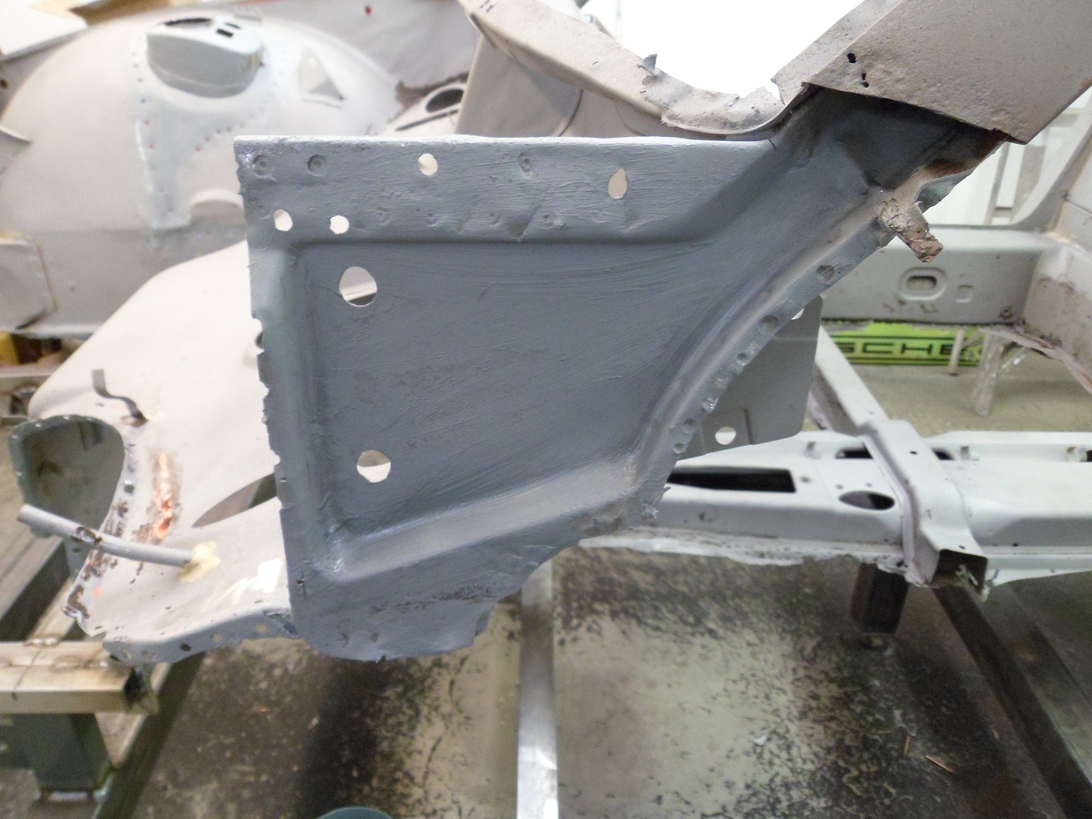

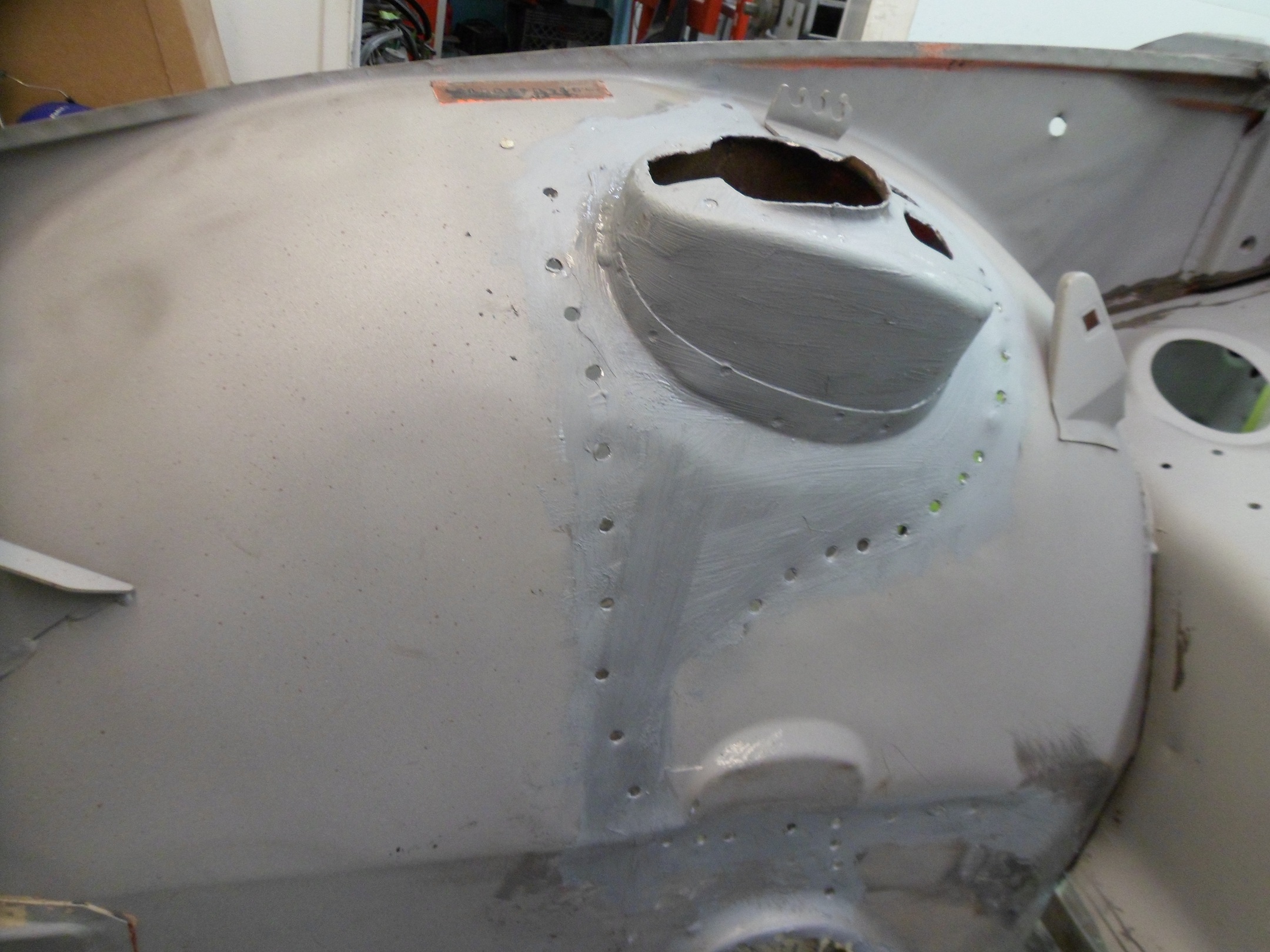

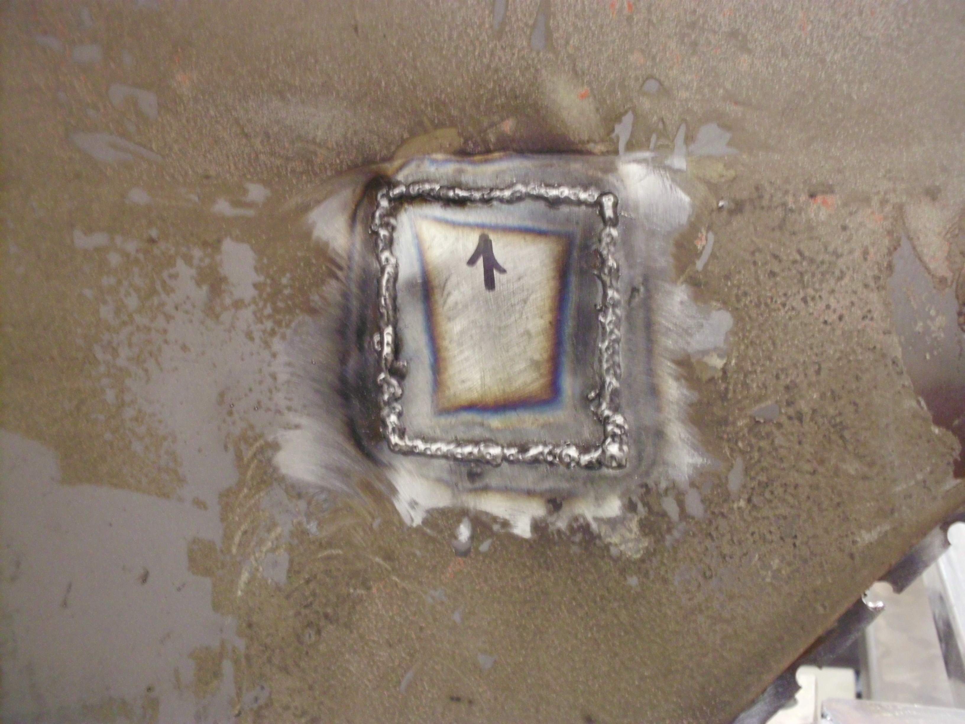

Got the front corner clip and inner long tacked in place. I blasted then coated the areas with brush on weld through primer. As it is heated when welding, it melts and coats the weld area to protect it. All these areas will also be sprayed with a primer once the car is completed using internal frame coating spray.
914350
post Mar 31 2015, 08:38 AM
Post #157
Posts: 548
Joined: 21-April 14
From: Torrance Ca.
Member No.: 17,275
More pics.

QUOTE(rick 918-S @ Mar 22 2015, 09:30 PM) *
looking good!

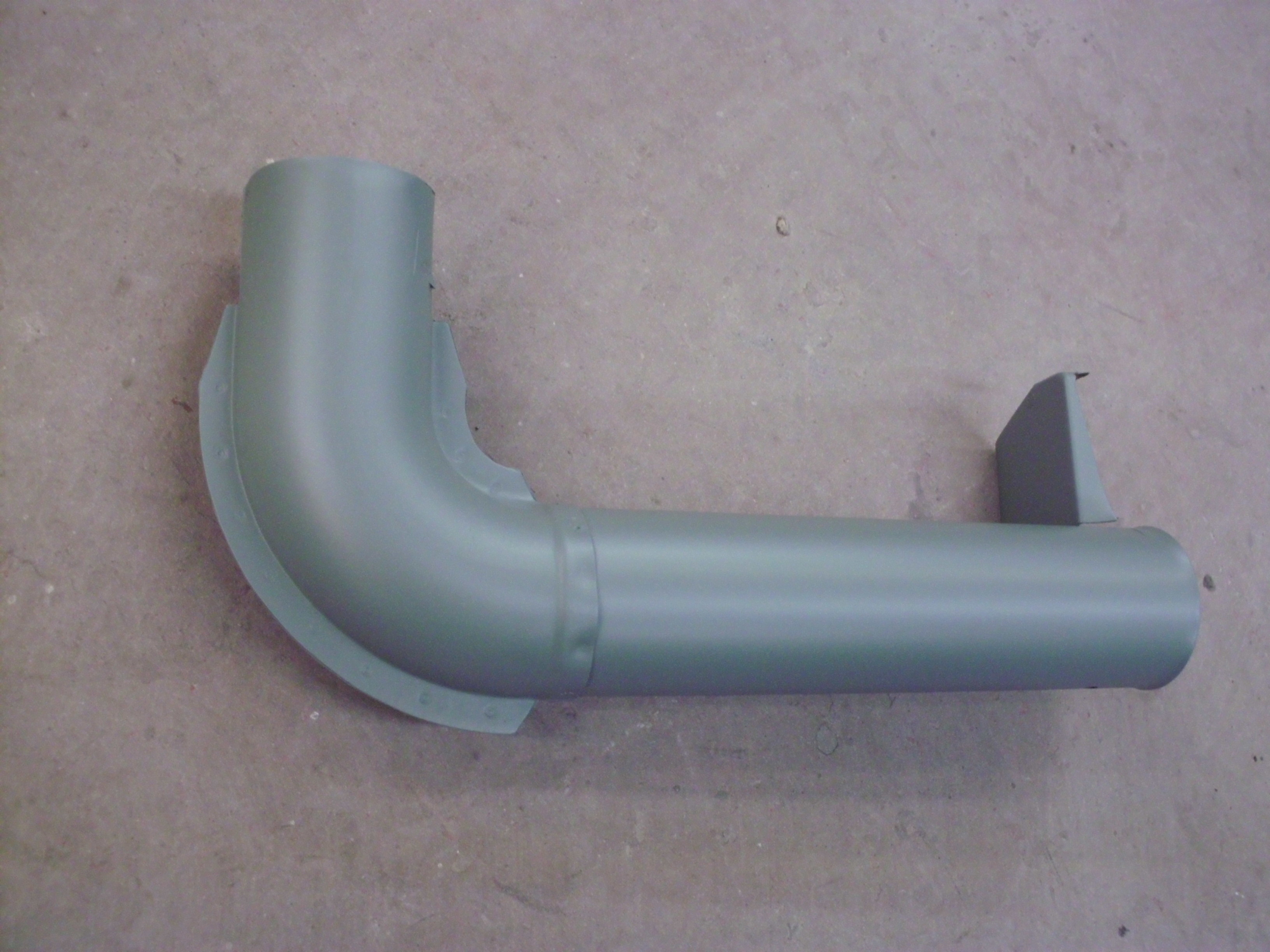

So, Restoration Design only makes the inner rocker panel (left) for the late cars? Their part has the two curved bump outs:
http://www.restoration-design.com/store/product/PP301L

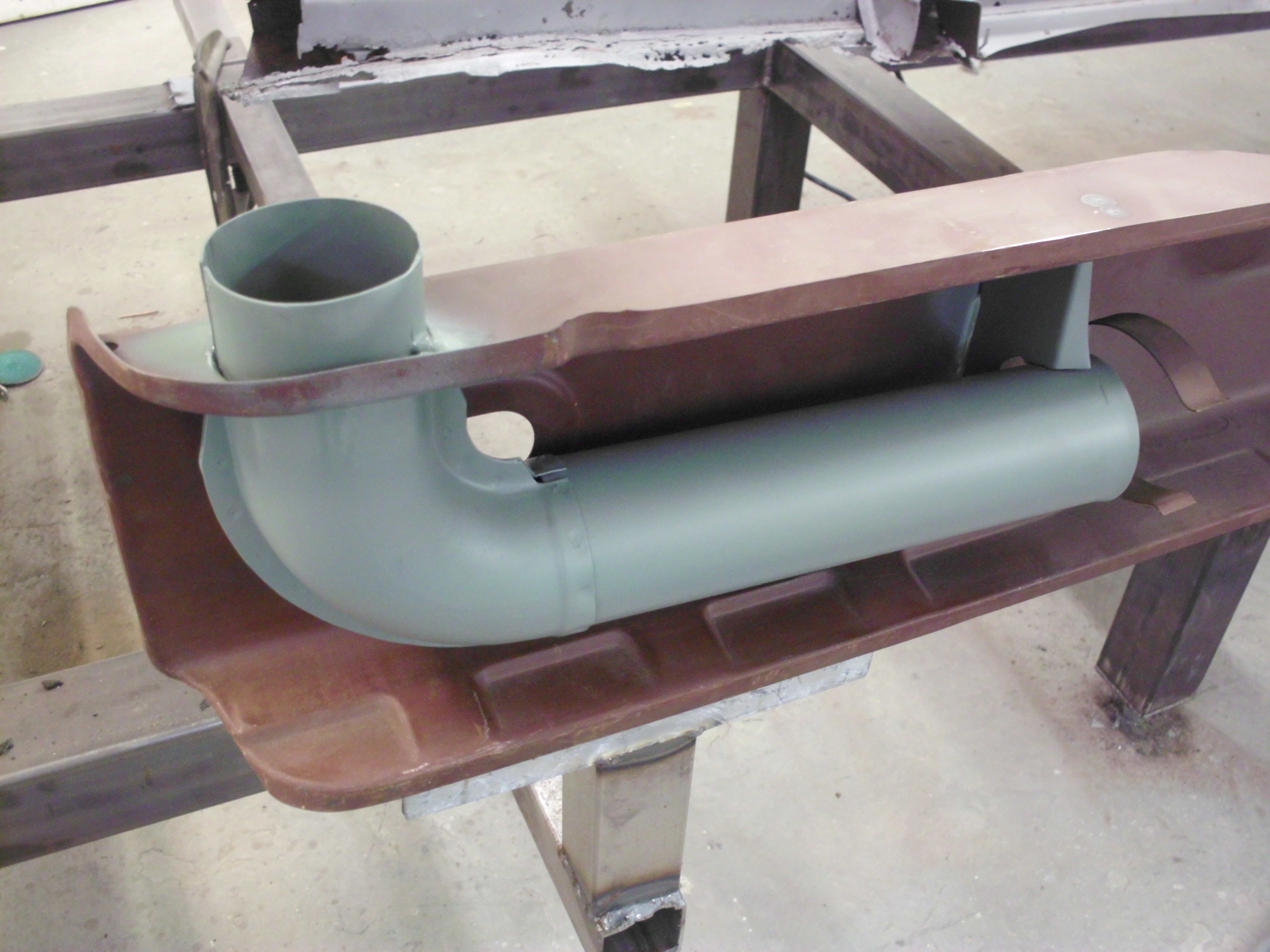

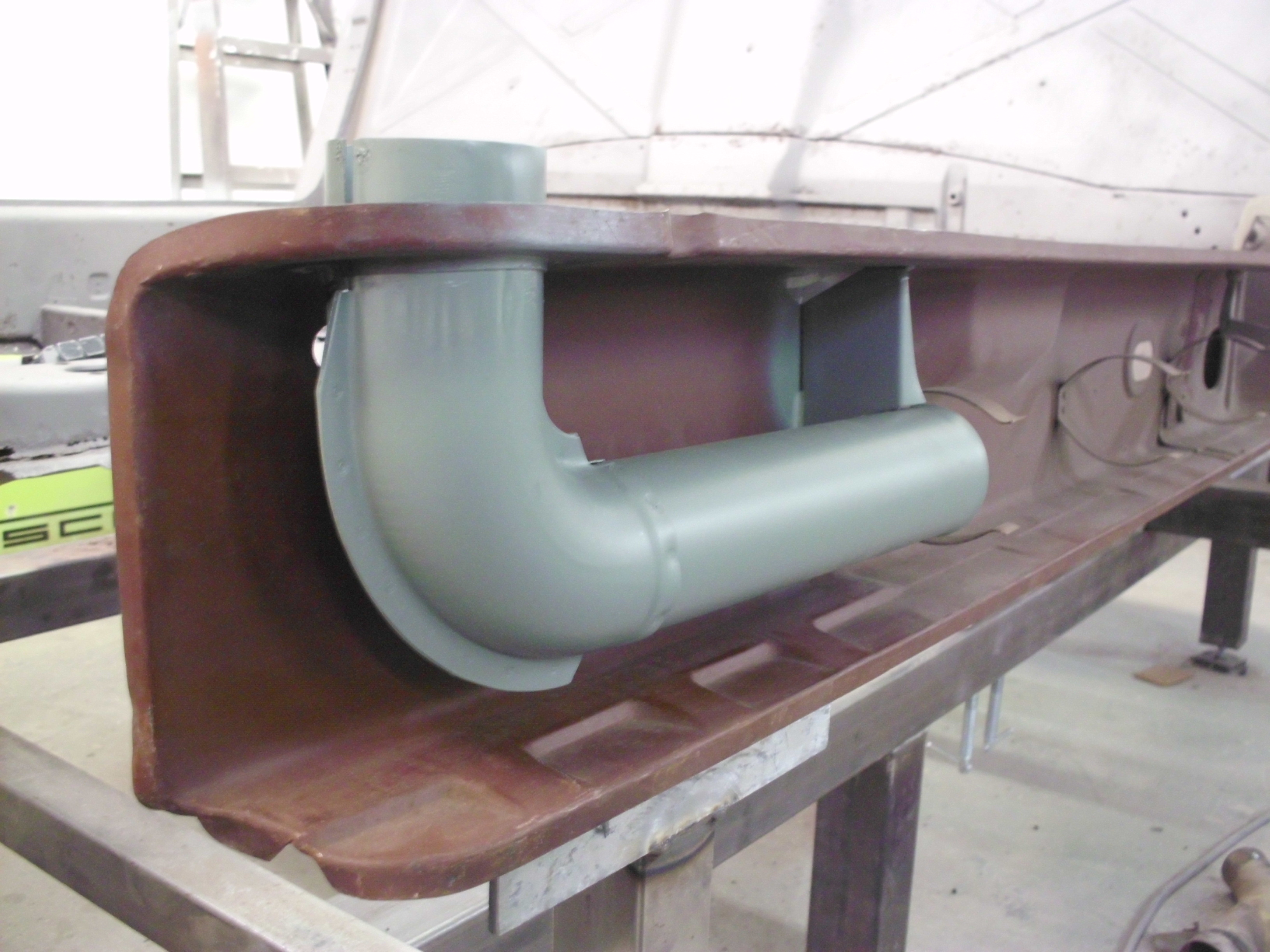

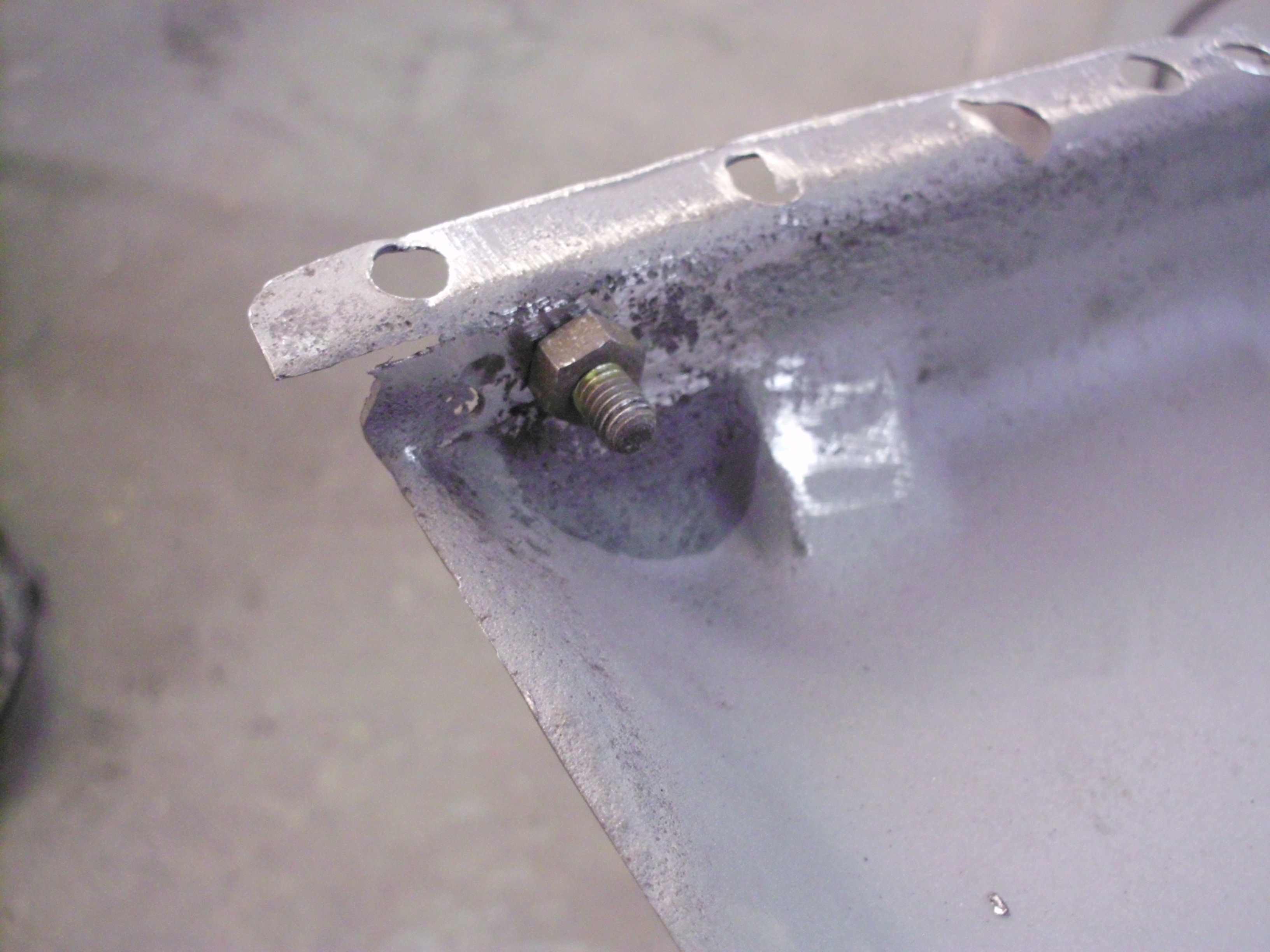

Some progress pics.

More pics.
