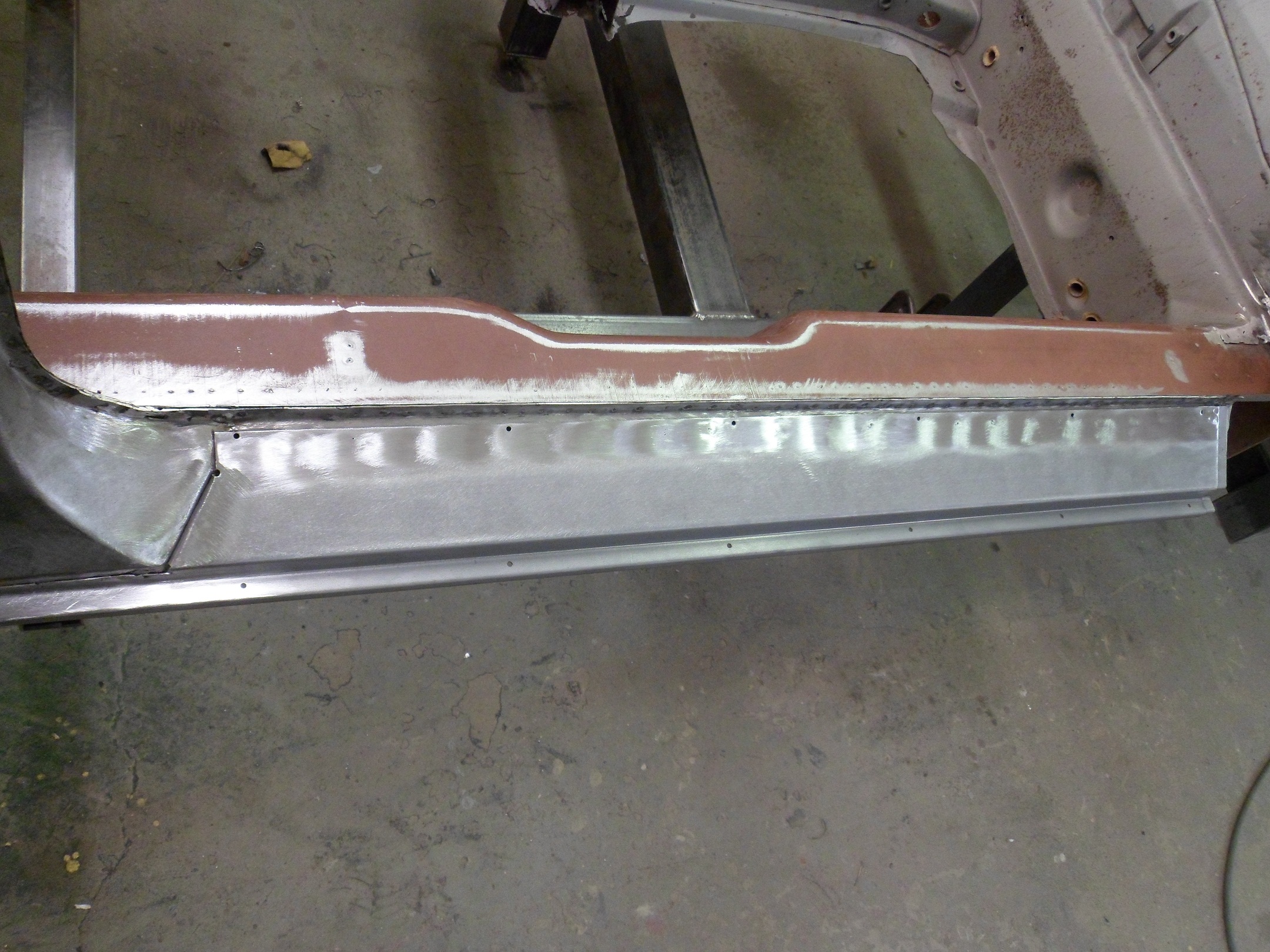

More progress pics.

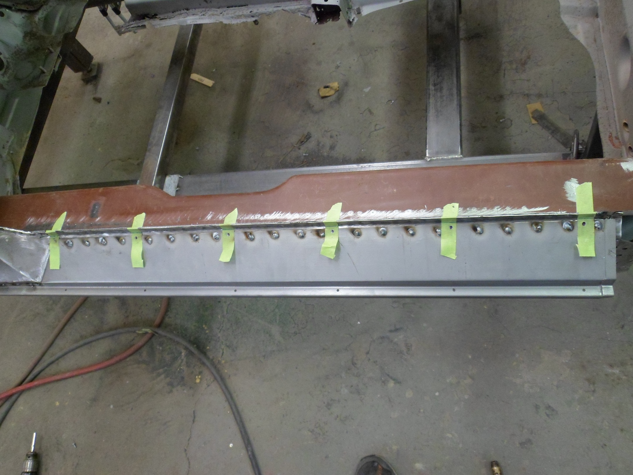

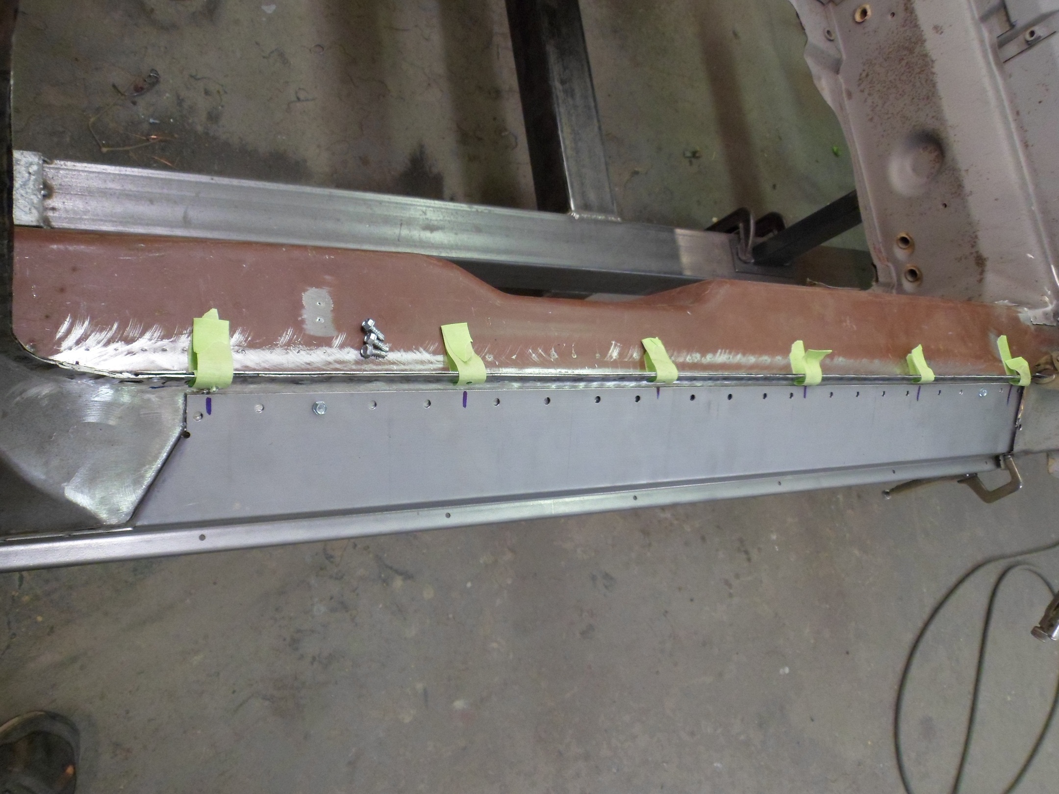

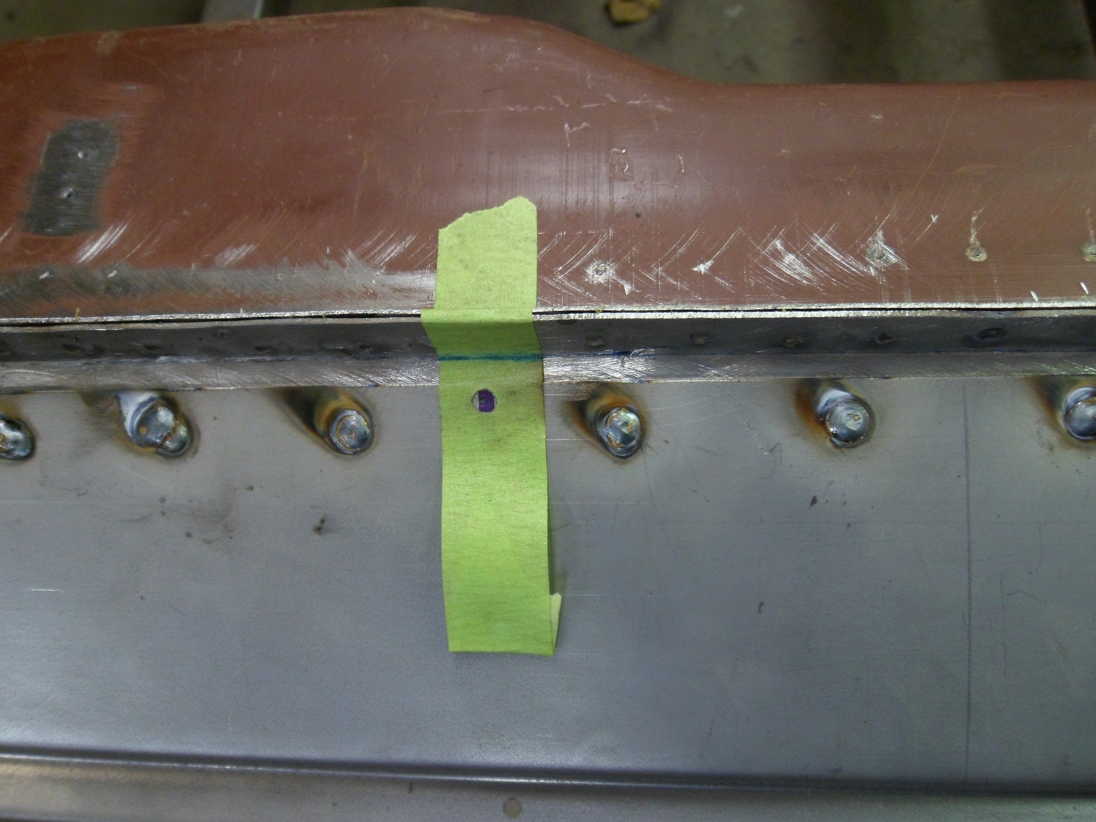

This is pretty self-explanatory but this was an easy way to use tape to locate and transfer the holes into the new piece. The holes were in the outer long but covered with the sill plate (once sill plate was placed) so I used tape to map their location and pulled it back, welded then laid the tape back over to give me the location to drill the hole in the new piece.

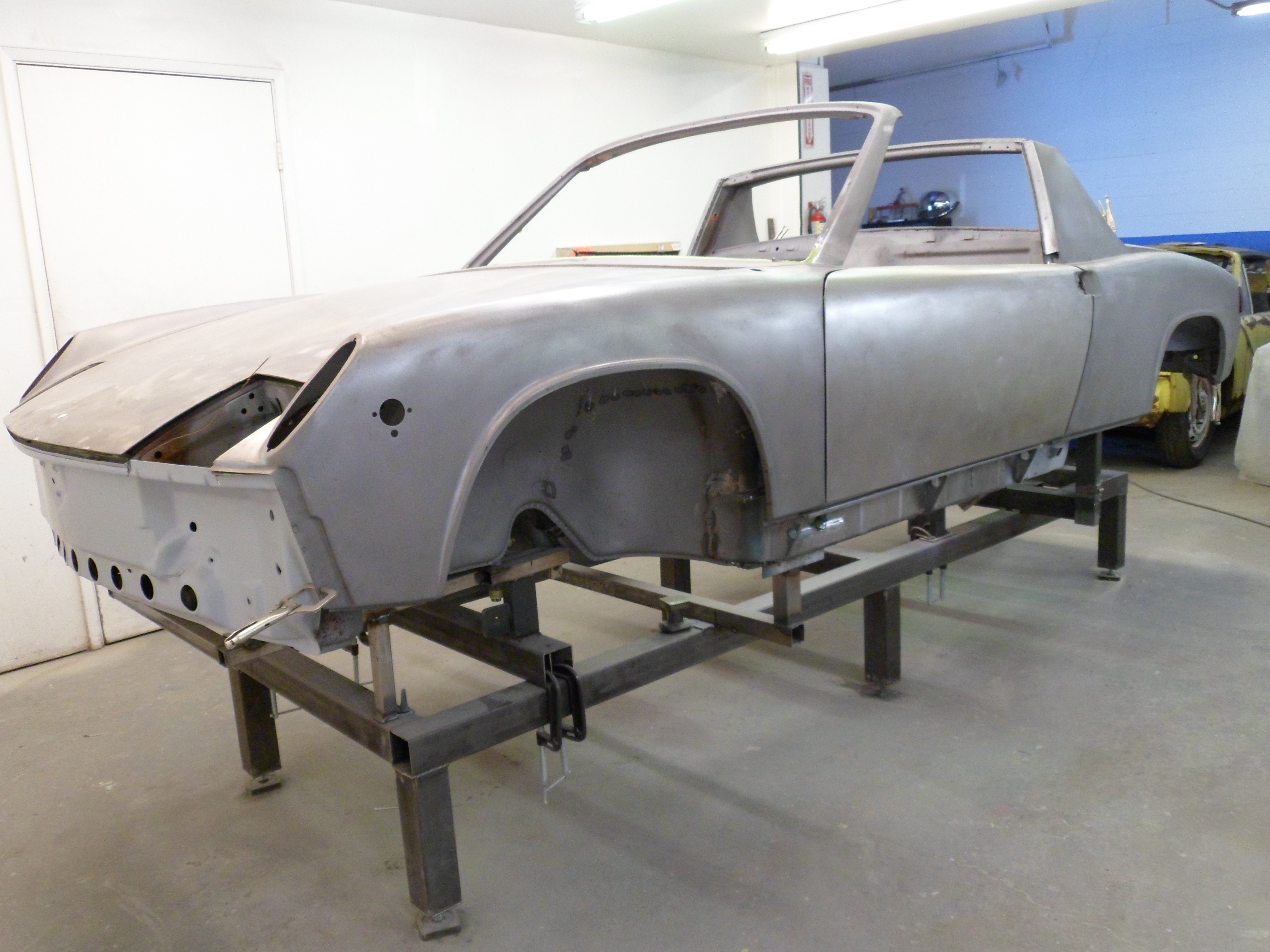

914350
post Aug 27 2015, 09:17 AM
Post #194
Posts: 548
Joined: 21-April 14
From: Torrance Ca.
Member No.: 17,275

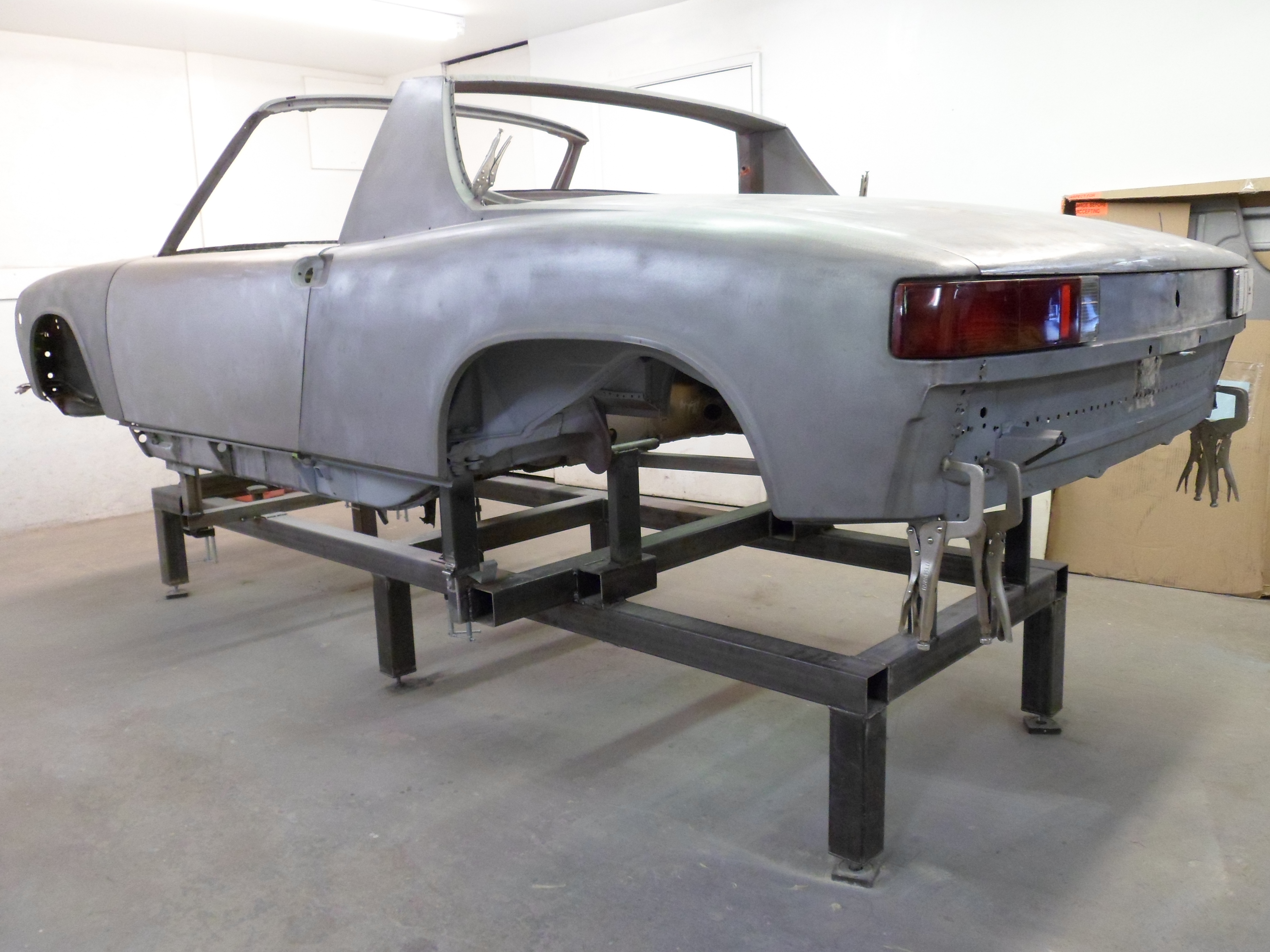

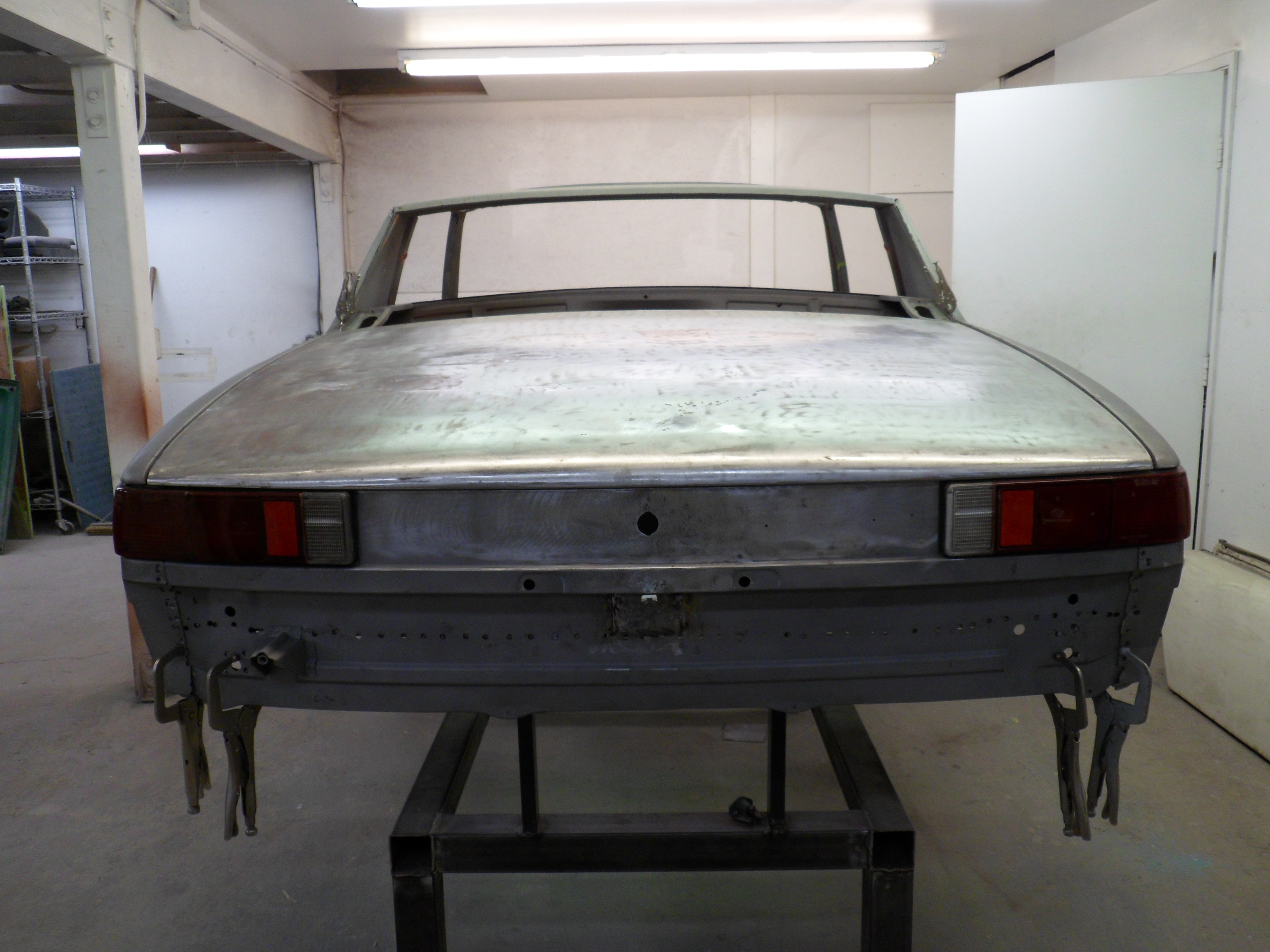

Progress pic.
914350
post Aug 27 2015, 09:18 AM
Post #195
Posts: 548
Joined: 21-April 14
From: Torrance Ca.
Member No.: 17,275
Progress pic.
914350
post Aug 27 2015, 09:22 AM
Post #196
Posts: 548
Joined: 21-April 14
From: Torrance Ca.
Member No.: 17,275
Progress pic. It will be going on the rotisserie to start working on the pans etc. soon.
